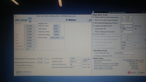

When I use the calculate/scale button for the stepper driver I cant seem to come up with the 898.341 steps per inch.. What am I missing? Should I just ignore that section and manual enter it into "stepper scale" When would the microstep multiplication factor in?

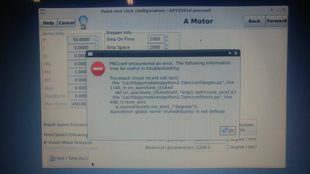

Also when I try to test my A axis, I get this error message:
under the mesa card set up, there is an option to invert the a axis (which I have selected) is this to invert the axis or the signal? In addition I also have inverted a axis motor direction selected on the a axis motor set up page

pncconf has never kept up with the Mesa environment. It takes all of the data you input and creates a basic hal file and ini file.Once you get all axes working you can calibrate the settings by editing the hal and ini files by hand and never use pncconf again.
So in the ini file, for each joint, there is a setting like
In my case this is the number of steps per mm as I havethis set in my INI file elsewhere
I'm going to assume that as you have a gantry machine, you are using the 2.8 master branch so the ini config docs are here:
linuxcnc.org/docs/devel/html/config/ini-config.html
Take the time to read this in conjunction with your ini file
I also had problems scaling one axis as I could never work out the pinion pitch as the parts differed from the specs I bought off.. What I did was lay a 1 metre steel rule on the table with a pointer against it. and measured the error as a percentage when moving 1 metre. Then I would take that percentage error and change the STEP_SCALE up or down by that percentage. After a few iterations, I was pretty happy.
To check I had everything right, I wrote some relative mode gcode that moved 20 metres up and down the gantry and measured the error at the end with a dial indicator as shown in this video
So it just goes to show there are more than one way to skin a cat but direct calculations are by far the easiest.
STEP_SCALE = 159.154925543[TRAJ]
LINEAR_UNITS = mmI'm going to assume that as you have a gantry machine, you are using the 2.8 master branch so the ini config docs are here:
