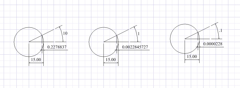

This got me thinking
schmidtmotorworks said On a master at 0.0001" and 0.1 degree steps, the faceting is noticeable and needs to be polished out.
I did a CAD test. I used a 30 mm circle and wanted to see how accurate a step I may need. The cam is not a circle but if I put in a 'safety' factor of 2 or 3 for the ramp, I should be in the ball park. So if you traverse a circle in 0.1 deg increments, how much does the X axis have to move.
At 0.1 deg increments, the X axis has to move 0.000028 mm on a 30 mm circle.
Even at 1 deg movements, it is only 0.0023 mm Say the cam has a really steep lobe and it is 5 times that rate, its still only 0..01 mm.
Where am I going wrong ? It looks like 1 mm steps will be more than accurate enough.

12 Jul 2020 17:06 #174406
by schmidtmotorworks
Replied by schmidtmotorworks on topic DIY CNC Camgrinder
After you machine it, run a hard bench stone on the surface, the peaks will show.
It doesn't take much to remove them.
If you put the points closer together the peaks diminish.
The commercial cam grinders have smoothing routines to enable them to use 1 degree increments.
