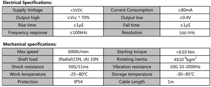

I have to choose an encoder (spindle speed) for converting a CNC lathe.
I have to mount it on a 7i76 board with Pathpilot.
I attach files with features (I thought 1000 P / R)

In general you are much better of with line driver (differential) outputs so I would not chose that type of
encoder but rather one with line driver outputs. These will have 2 signals for A, B and Z, often named A,/A B,/B and Z,/Z

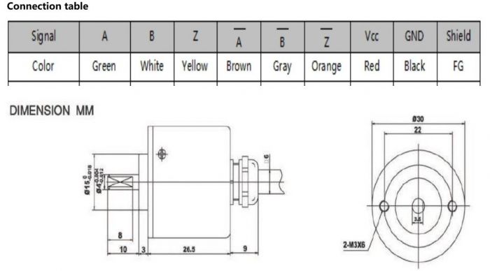

16 Apr 2018 13:52 #109120
by Robi63
Replied by Robi63 on topic Choice of encoder for 7i76 + Pathpilot
- Posts: 18111
- Thank you received: 5330
16 Apr 2018 14:56 #109124
Replied by PCW on topic Choice of encoder for 7i76 + Pathpilot
That looks good.

I connected the ecoder in TB3 between 7 and 14.
7 Green A
8 Brown A-
9 Black GND
10 White B
11 Gray B-
12 Red Vcc
13 Yellow Z
14 Orange Z-

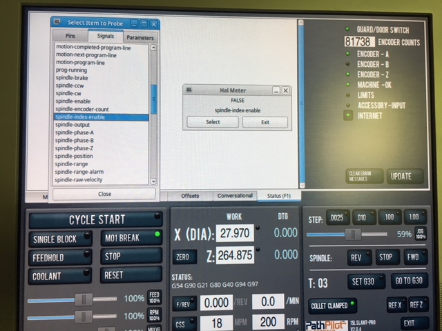

I have tested in PP with Halmeter
in pins hm2-5i25.0.gipo.015.in / 016.in are OK 014.in no signal
in signal I tested spindle-phase-A / B are OK Z no signal even spindle-index-enable no signal.
I would not expect to see the index signal, that's why you must test for it in the way I indicated
This is because the index signal is a very short pulse on a high resolution encoder and its easy to miss
because of both the 1 KHz servo thread sampling and the fact that halmeter or "show" are only sample
hal data at about a 10 Hz rate

Hi PCW,
As always, you're right.
I have done your test and one point passes from true to false.
