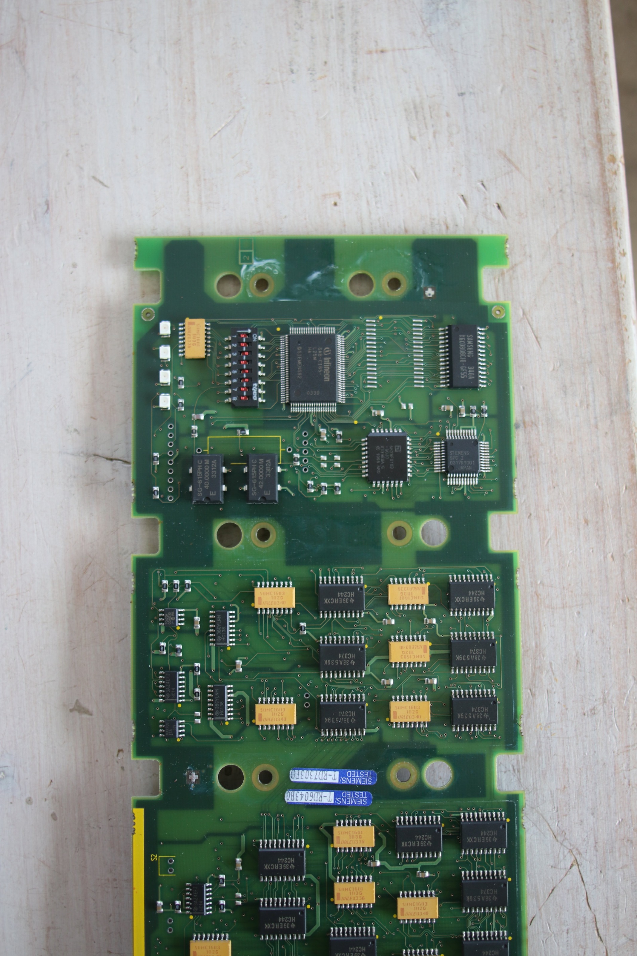

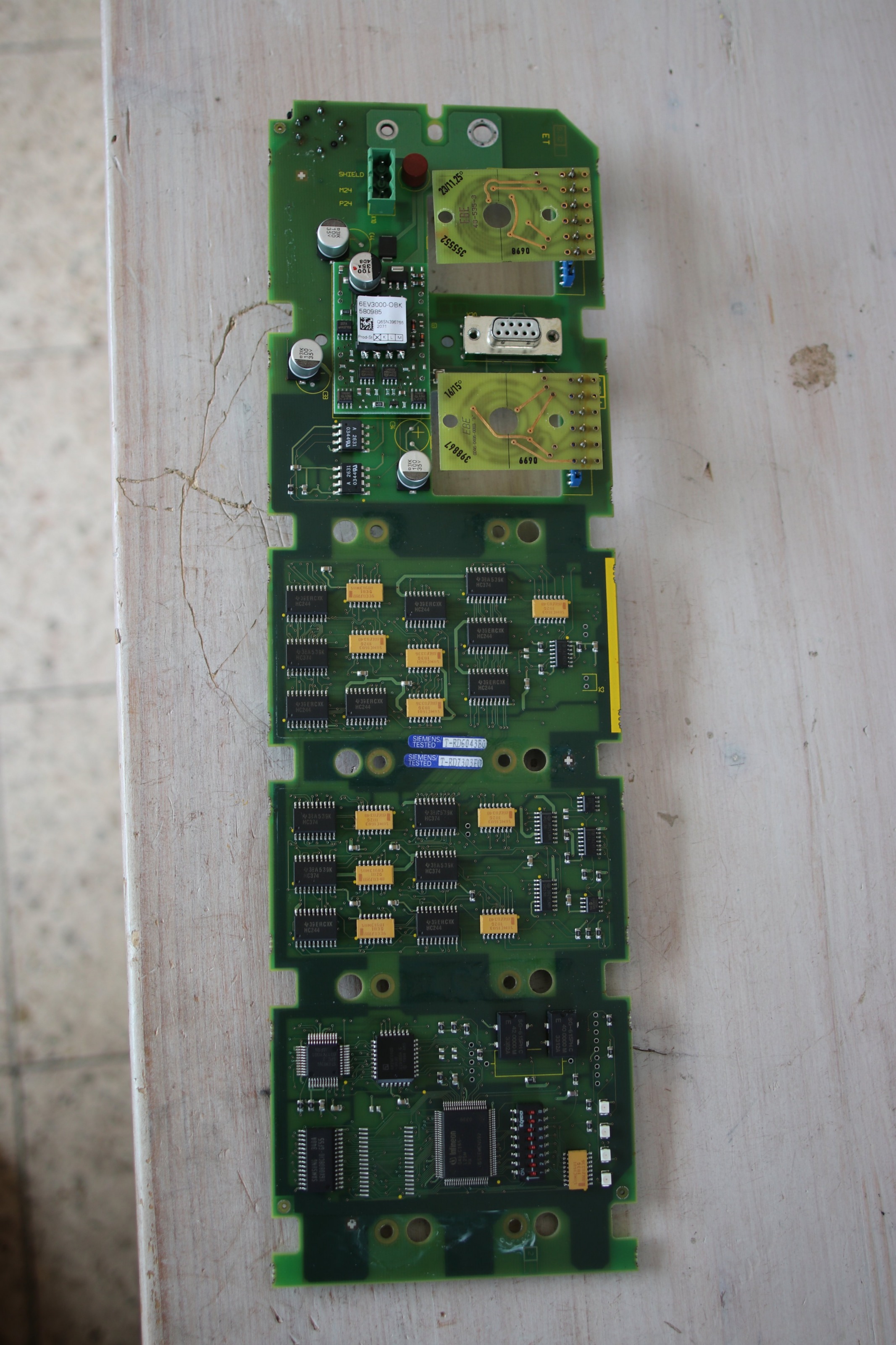

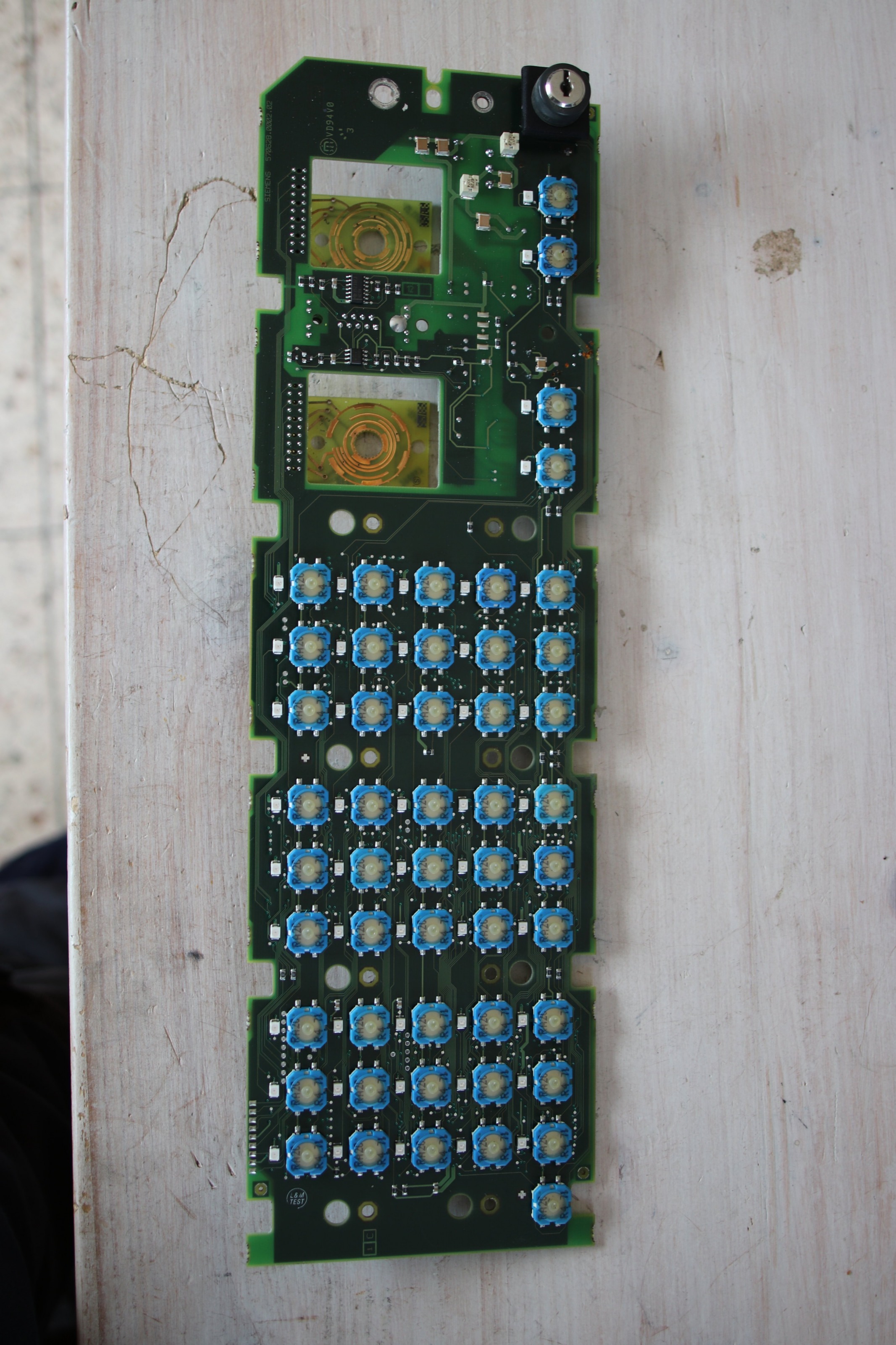

- JimPanski
- Posts: 60
- Thank you received: 3
09 Jul 2018 09:33 - 09 Jul 2018 10:36 #113857
by JimPanski
Replied by JimPanski on topic AUERBACH FUW625 Retrofit with 7i76e - work in progress
hi guys,
thanks for your reply.
for the panel thing:
when i use the 7i73 this means that i dont have to wire every single button? (i have to admit that this was my biggest fear)
the keyboard has buttens for lubing axes, open doors, choosing jogged the jogged axis and scale and switch modes (mdi/auto)
also you can start/stop spindle and program - so no gcode sending
the override knobs are atm rotary switches => i have already noticed that i have to change these to encoders for have connected it the easiest way
when i later will have the system with closed loop i thought about using a 7i92. is it possible to use this combo? i mean 7i76e+7i92+7i73?
EDIT: maybe any chance to have it connected serial?!

- Posts: 12158
- Thank you received: 4150
09 Jul 2018 10:49 #113864
Replied by rodw on topic AUERBACH FUW625 Retrofit with 7i76e - work in progress
Not quite the same but I had noise issues on a 7i76e encoder input attached to a Mesa THCAD plasma arc voltage reader which I fixed with one of these on the power inlet to the control box.
www.jaycar.com.au/iec-emi-power-line-filter-6-amp/p/MS4003
09 Jul 2018 14:46 #113879
I don't think that the 7i92 makes much sense if you already have a 7i76E. What do you intend to attach to the 7i92?
Replied by andypugh on topic AUERBACH FUW625 Retrofit with 7i76e - work in progress

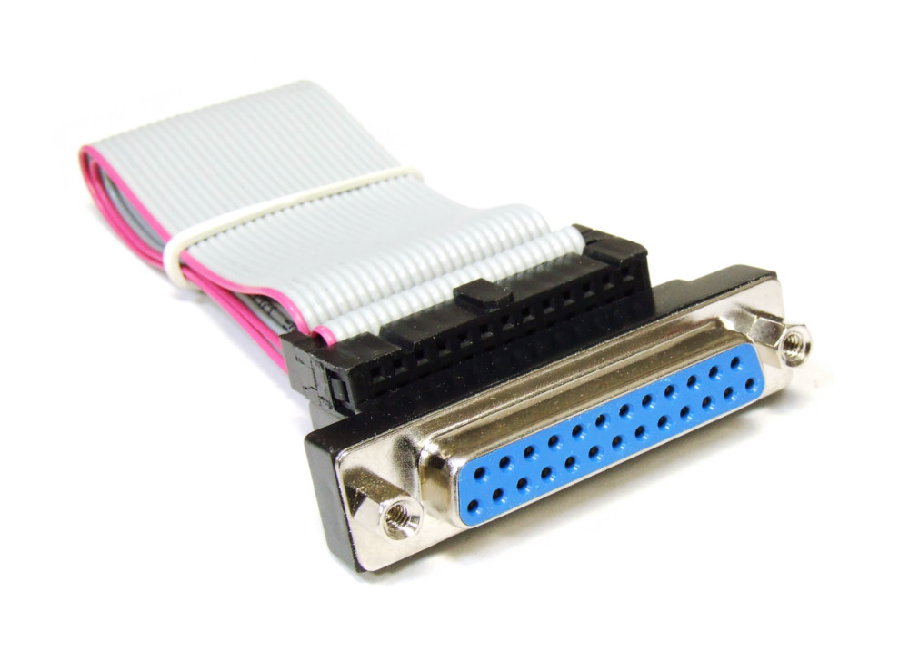

24 Jul 2018 11:40 #114743
by JimPanski
Hi!
just ordered the 7i85S and could remind me that PCW already told me which card makes sense.now i see that i had messed up with those numbers
For attaching the 7i85S to my 7i76e i am not sure if i am right. i think i need something like this..
Is that right? Do i need it with a male or female DB25 connector?
Are there already bitfiles available for that combo or will i have to ask PCW?
Regarding that panel problem: does anybody see a chance to have it connected serial?
By the way: i might have found the issue with my spindle encoder. with the oscilloscope attached i could see that there is not really a sin/cos signal there. you can see that the level of the signal is about 0.1vpp which means its level is at the same like the noise. so i think i have a defective ERN encoder. the next step is to test my ic-nv cuircuit with a functional encoder and the spindle motor will get somting i can directly use with TTL signal on the 7i76e.
thank you for your patience!
24 Jul 2018 13:43 #114749
I couldn't remember which way the connectors go, but this Youtube video seems to be pretty clearly male pins in the connecting cable:
