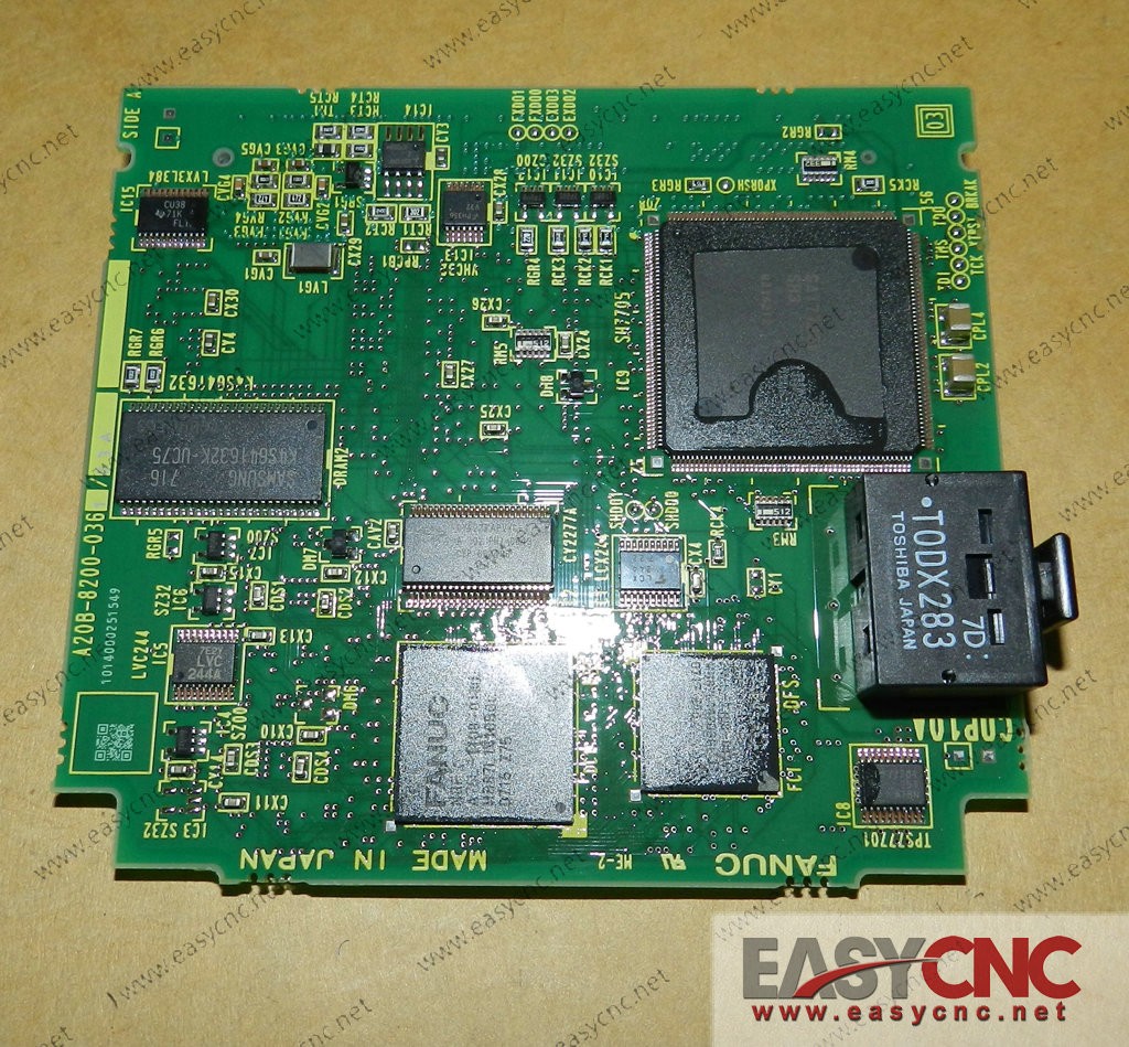

probably you've seen that. TODX283: elcodis.com/parts/6164179/todx283.html
availatble on ebay, has a TTL interface. should do the trick, imho

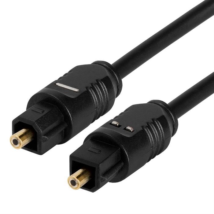

This Fanuc FSSB uses probably optical connectors JIS F07 (duplex) it was necessary to grind plastic part of connectors a bit, metal insert with the fibre match OK. I used these cables:
www.krup.cz/default.asp?cls=stoitem&stiid=927
Cables was OK, machine works with these cables.

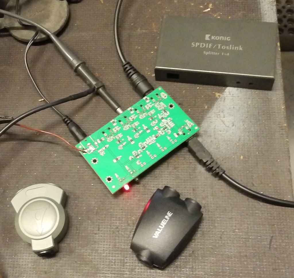

I also bought this passive splitter and it doesn't work, it has really too high loss:
www.krup.cz/default.asp?cls=stoitem&stiid=5145
Now I want toorder this active splitter:
www.krup.cz/default.asp?cls=stoitem&stiid=5749

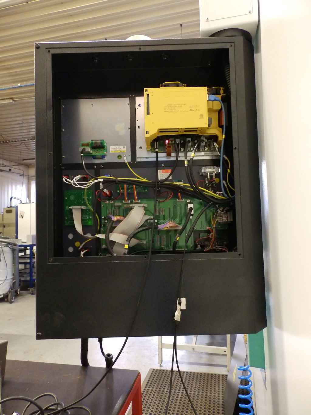

When I will open machine next time, I will take some photos.
BTW: Fanuc PCI card at your picture looks interesting.What is it? Maybe, is it possible to use it?

fanuc pci card - no idea that it is, i just googled for "fanuc pcb" images

Hallo, I have new informations. I ordered passive splitter like at your picture, but is it similar like I had before, Fanuc doesn't work with it. I think, optical power is divided half and half to each outputs and 50% is not enough for receiver, I think. I also ordered active splitter, but as we estimated, it doesn't work at all. There are some SMD ICs inside (amplifiers? Schmitt triggers?) but all signal ways are capacitor-coupled, so it will be frequency sensitive. I think it is the time to order 50Mb receiver and transmitter and make my own "sniffing amplifier"
