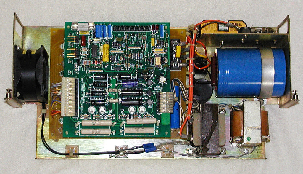

So I am a network administrator and know very little about these machines. I was originally asked to look at this CNC 6 to see if the 5.25 floppy drive could be replaced with USB. My question as I have been doing my research, why do we need this old CNC 6 controller at all? But my question is, how to I physically interface with the machine? I know that is not likely a simple question, but if you can send me some resources to start figuring that out, I would appreciate it!

What type of machine is it?
The first thing I would check is the motors and drives and see if you can control the drives..( proprietary interface? +-10v? step/dir? etc...).
That's a good place as any to start.
Once you get that straightened out, check how many inputs does the machine use and how many relays required.
Then start figuring out the logistics of operating it, depending what type of machine it is to see if LinuxCNC is a valid option.
That's where I would start.

Post closup pics of motor labels and drive labels and someone here can help.

Do you have modules that look like this?
/edit snip
Those look like PWM drives. You know if they are DC servos? You have pics of the servos?

I see "tachometer" so I suspect that we are looking at a brushed DC servo drive.
Which parts keep failing? If it is the drives then you would not want to keep them, but the retrofit is simpler if you do.

Can you attach a sample G-code file?
