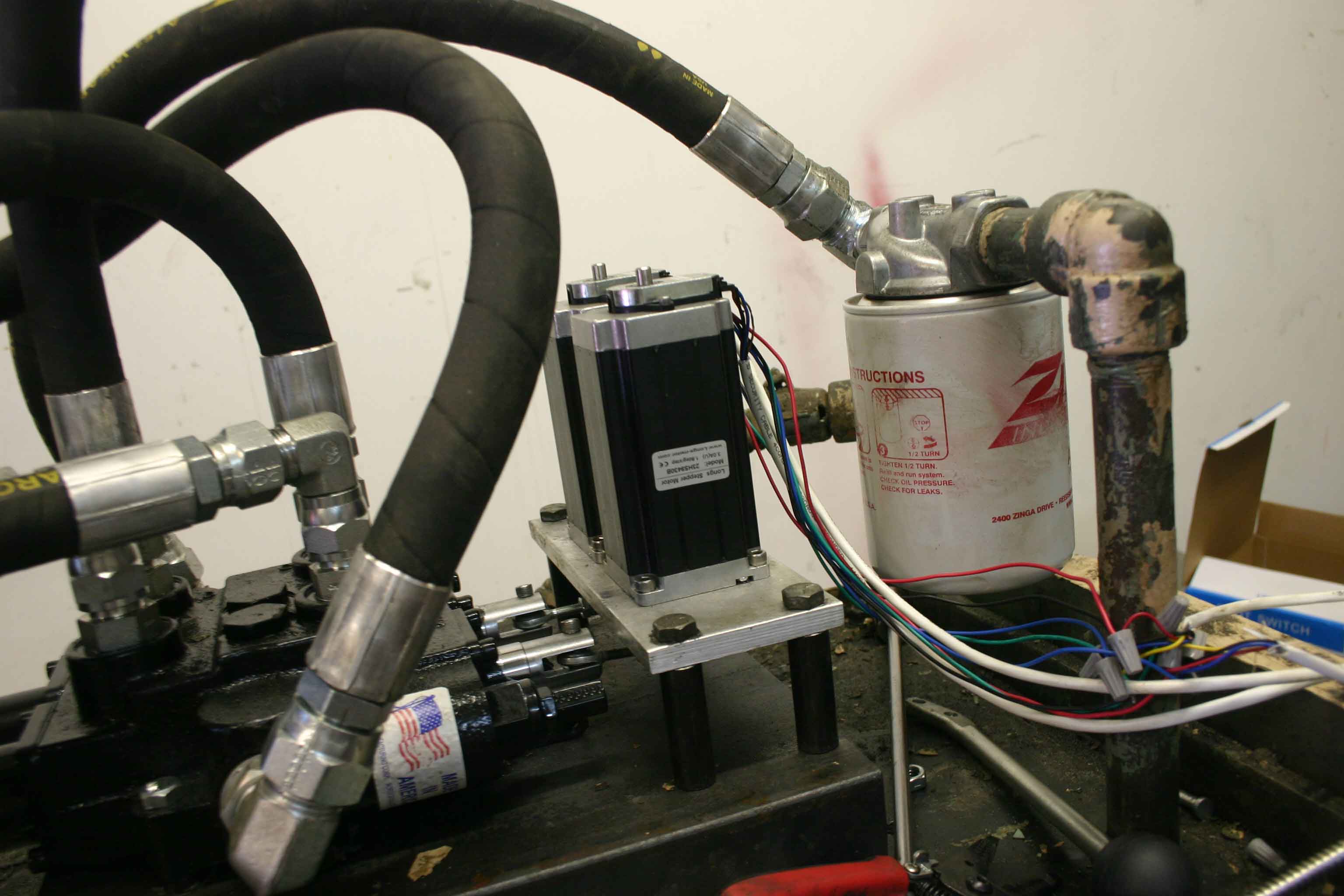

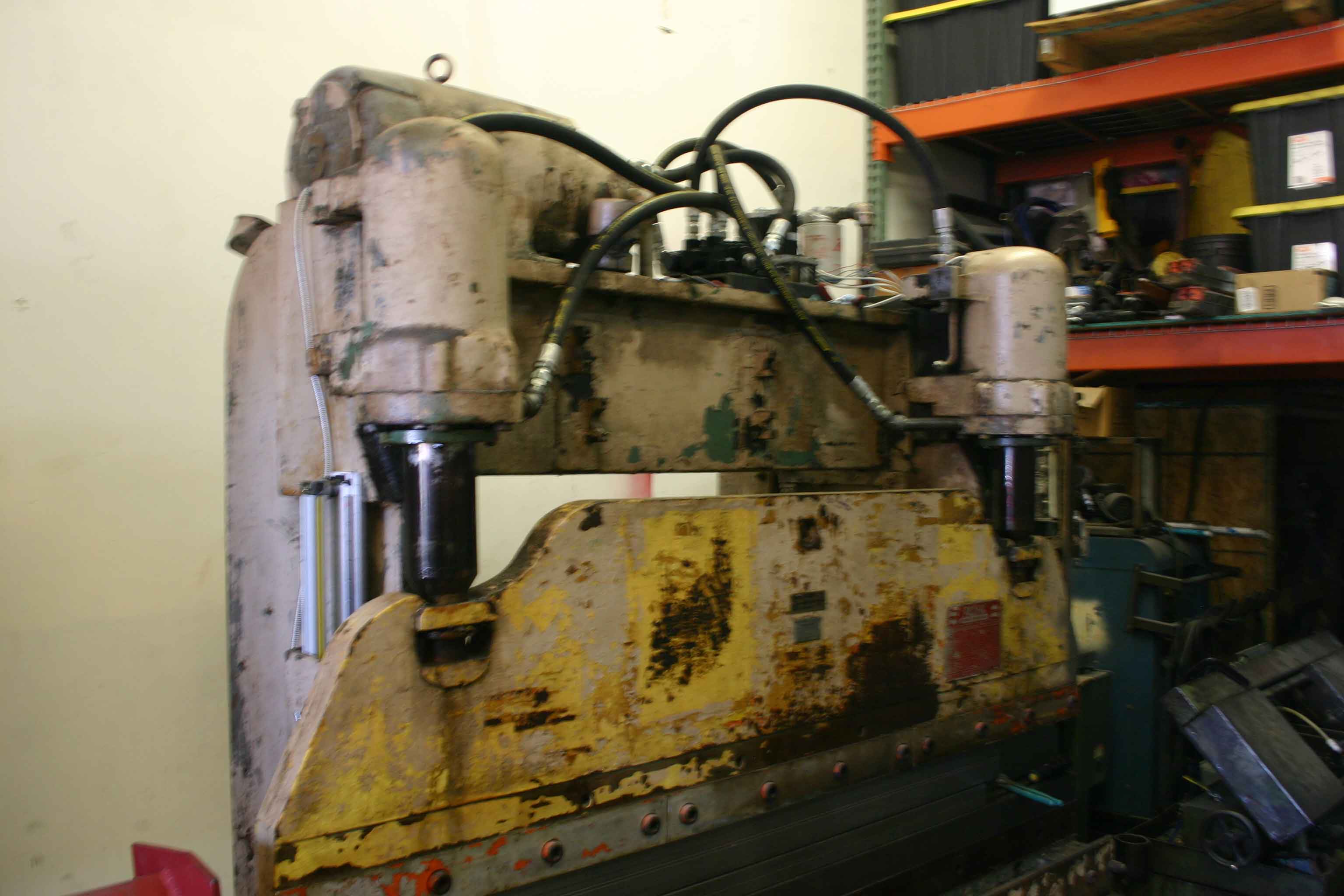

I've purchased a Hydraulic press brake that the valve system was rusted and non repairable. My answer is to use glass scales on each cylinder for synchronization and height control. Originally I tried to use a arduino but it cannot count the encoder / glass scales and do other math at the same time fast enough. My budget doesn't allow for expensive servo valves so I made my own stepper driven two spool valve. I'm looking to use linuxcnc and mesa to make it work. I've built 3 machines so far using linuxcnc and mesa and have always thought of a better way to do it after I'm done. So I'm asking for input on what cards and concepts to impalement it using linuxcnc. As of right now I have linear glass scales attached to each side. and stepper motors have encoders as well. So I need to be able to read 4 encoders and drive to stepper motors back and forth to raise lower and sync.

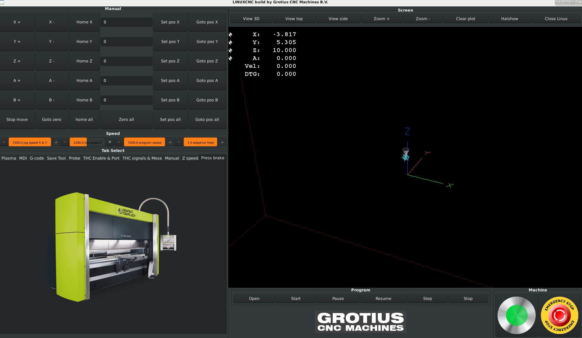

Hi Steve,
See what we can do. We can make a gui for press brake control, with pictures of the state of the press brake.
Every state need's a picture. So it's just a little photoshopping and a good front picture.
Steve, you can look at the fpga board's of Mesa. Some board's can be almost adjusted unlimited. It need's some experience.
An other way is to make your own fpga interface. I am looking for that.

Hi Steve,
Attached a first beginning of in and output's. You can adapt your signal's if you like it.
Do you want to have a home sensor for cilinder left and right on the top, when press brake is in top position?
If your glas scales value's are alway's good. You can use that. I adapted a glas scale height correction, so you don't
have to worry to place them exactly in height. It can be corrected by input value.
I have to add foot up and down.
Do you want to make the closed loop stepper in the component or outside the component in hal?
It's usefull to make the left and right cilinders perfectly synchronizing while the knife is going down.
This can be done in the component. The synchronize input step can be 0.001 to 10mm resolution. That is nice.

- Grotius
- Posts: 2419
- Thank you received: 2349
27 Sep 2018 18:43 #118069
by Grotius
Replied by Grotius on topic Hydraulic press brake control
Hi Andy,
Starting from Gscreen is a way to achieve Steve's goal. Mr. Morley, founder of Gscreen has done a great job.
I think G-code is not very useful when using a press-brake. For 3d pipe bending it will be more useful to use G-code because
then the bender can directly work from a cad/cam generated output code.
I read in your provided link that loading and saving data in the gui was a little problem at that time. The press brake application can load and read excel based files and also load and read text file's. The data can be directly adapted into a loaded g-code program in therm's off variables, or the loaded or saved data can be used to execute a press brake program with an almost unlimited press brake sequence. A press brake input screen will be adapted to the gui. We could even make a press brake calculator.
When using the external offset branche g-code is not necessary anymore to move the different axis or joint's.
The only value that is needed in basic for moving joint 0 - 8 is a offset value, speed value, etc. So this option make's life easyer
to write a component code. I use also the negative adaptive speed option in all my application's. I am very happy with this option.
