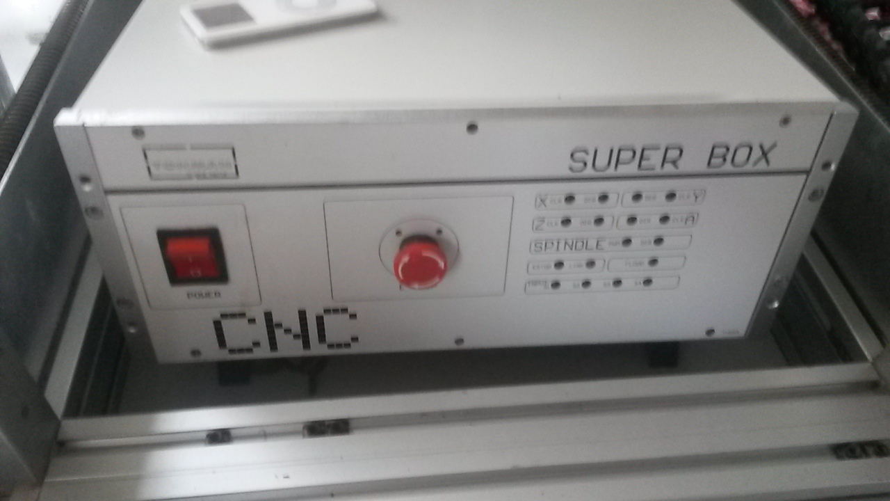

Hello,
Two weeks ago I bought on leboncoin (french version of craigslist) a rack and pinion 4' by 4' CNC but the seller wanted to keep for himself the controller and the spindle. He got it from Marchant Dice, a now closed british company, and had no documentation whatsoever except for the bills from 2012.
I have very few knowledge / experience in electronics, but I have been reading for quite a while about it and how to get a new controller. Can you help me translate the original controller bill and find the hardware I need?

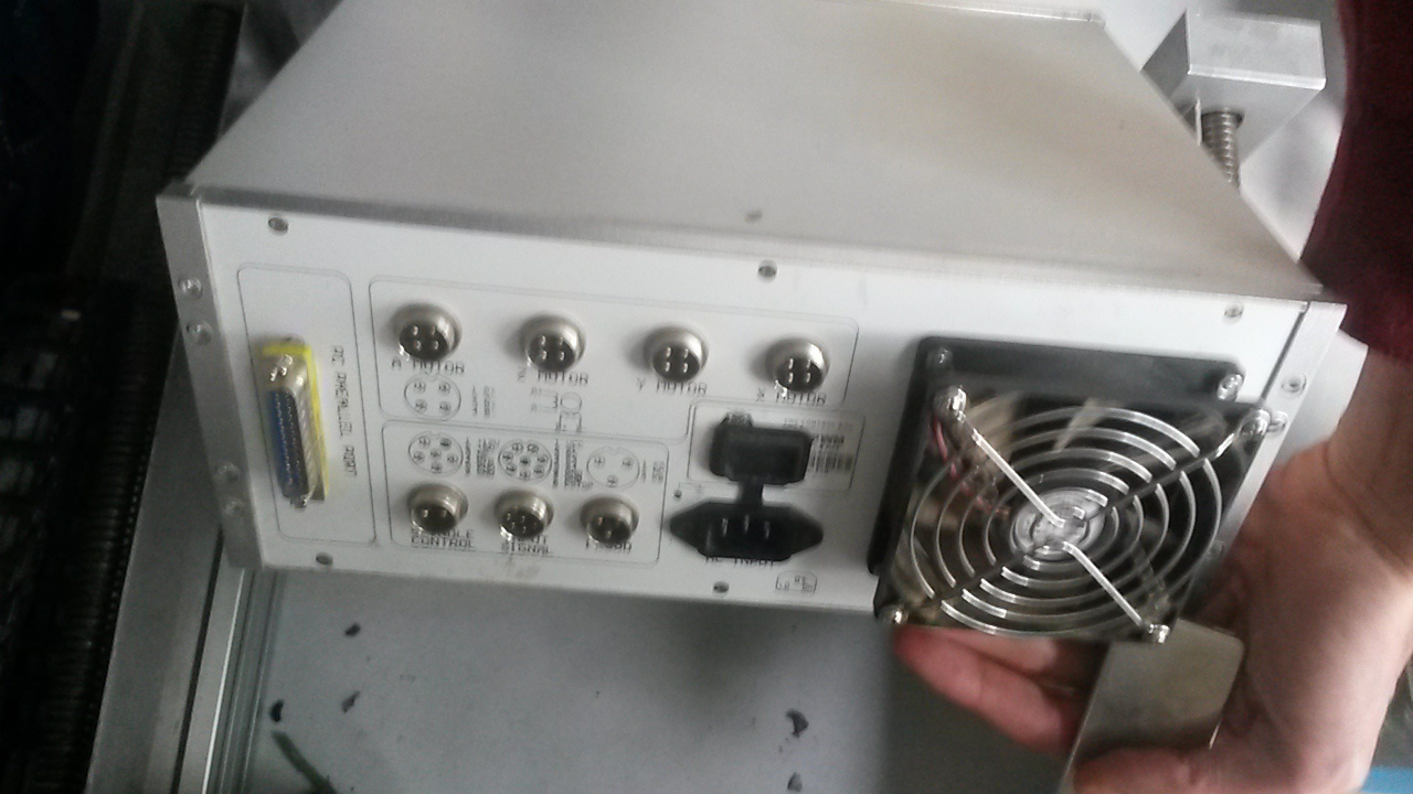

here are blurry photos of the original controller

17 Jan 2019 13:24 - 17 Jan 2019 13:25 #124346 by andypugh
This company is at the same address: www.bionicasystems.com/
And sells much the same stuff, but to be honest, it might be best to ignore them.
I will have a pc running linux dedicated to the cnc, but would like to be able to sometimes use my ubuntu laptop directly to control the machine,
I think that adding this feature will just make things more difficult. It is likely to be much simpler to connect to the dedicated controller with SSH and X-windows if you want to run the machine from the laptop. (I quite often ssh in to my CNC machines in the garage from the Mac in my living room, especially when the weather is cold)
x4pcs: 4.3A stepper driver
Consider using Amazon for slightly better customer service and faster delivery:
www.amazon.fr/TopDirect-TB6600-Controlle...mante/dp/B0711J1K66/
x1pce: Power supply CBD-450T-110/220-42 --> Internet does not know this how do I estimate this?
Simplistically you could just use 4 x 4.3A and size the supply that way. With a servo drive you could use a smaller supply as it is unusual for all motors to take max current at the same time. However stepper motors take full current all the time, even when stopped, but at a lower voltage. (probably about 5V) so the power supply needs to be at least 100W and no more than 750W.
www.ebay.co.uk/itm/232991720903 seems t indicate that there isn't much difference in price between a 360W and a 500W one, so I would suggest the 36V 500W. (It's best not to run the stepper drivers at the absolute maximum voltage, so I would get a 36V and adjust it up)
Last edit: 17 Jan 2019 13:25 by andypugh.
