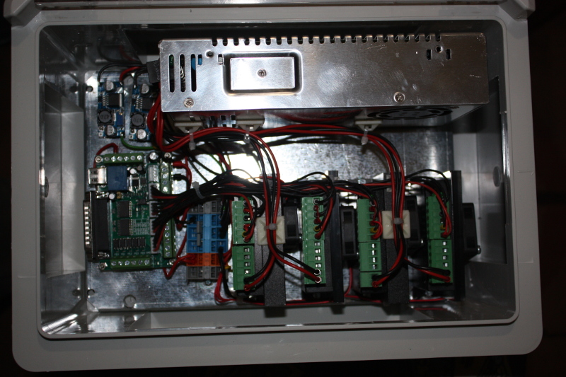

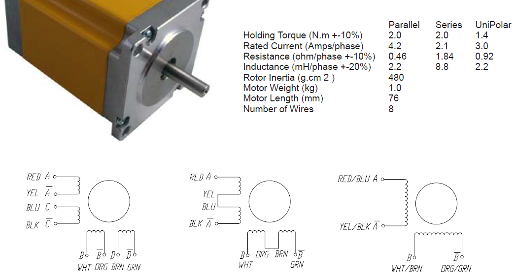

Good day, I am working on a CNC milling machine, the machine has a Probotix set, drivers ProboStepVX, Motor HT23-280-8 and PBX 2 breakout board, something happen to one of the drivers, so I changed it with a TB6600, with the probotix drivers I am using a 1/16 microstepping, so I tried doing the same with this TB6600, but it does not work properly. Could it be that probotix breakout board is not compatible with this TB6600, Can anyone recomend me a solution? Thanks.

hi i work alot with the TB6600
ehat is the main problem
did you check the driver wirering
go to 1/4 microstep
and check if it runs
it is always best to stay at 1/2 stepping and modify the machine to get best precision
the p9inout of the board mead's the requirements
see my YT channel for infos

I think I manage to resolve the issue, I used a "Maximum Velocity" of 1 mm/s.
