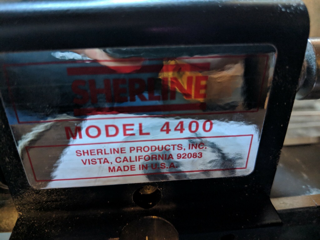

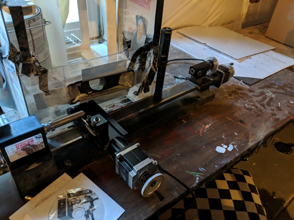

Hello,
We recently got a Sherline 4400. We took it in for repair and creation of a program that will allow us to turn duck calls. After producing some calls, the program started to do its own thing. I started over from start to finish but the problem persisted. I shut down the computer and all but when I turned it back on , the program for our calls was gone. I searched all thru the computer but cannot find it. I know we didn't delete it. If i go into the recently used files, I see it there but when I choose it, it says file not found. Any help or suggestions on where to try and find help, would be so helpful. In the meantime our calls are produced individually by hand.
Thank you
Kelli

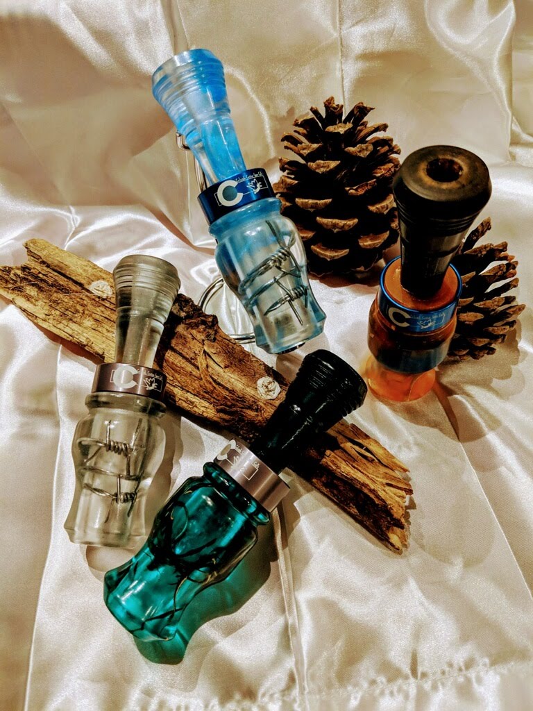

Almost forgot, damn those look nice!
