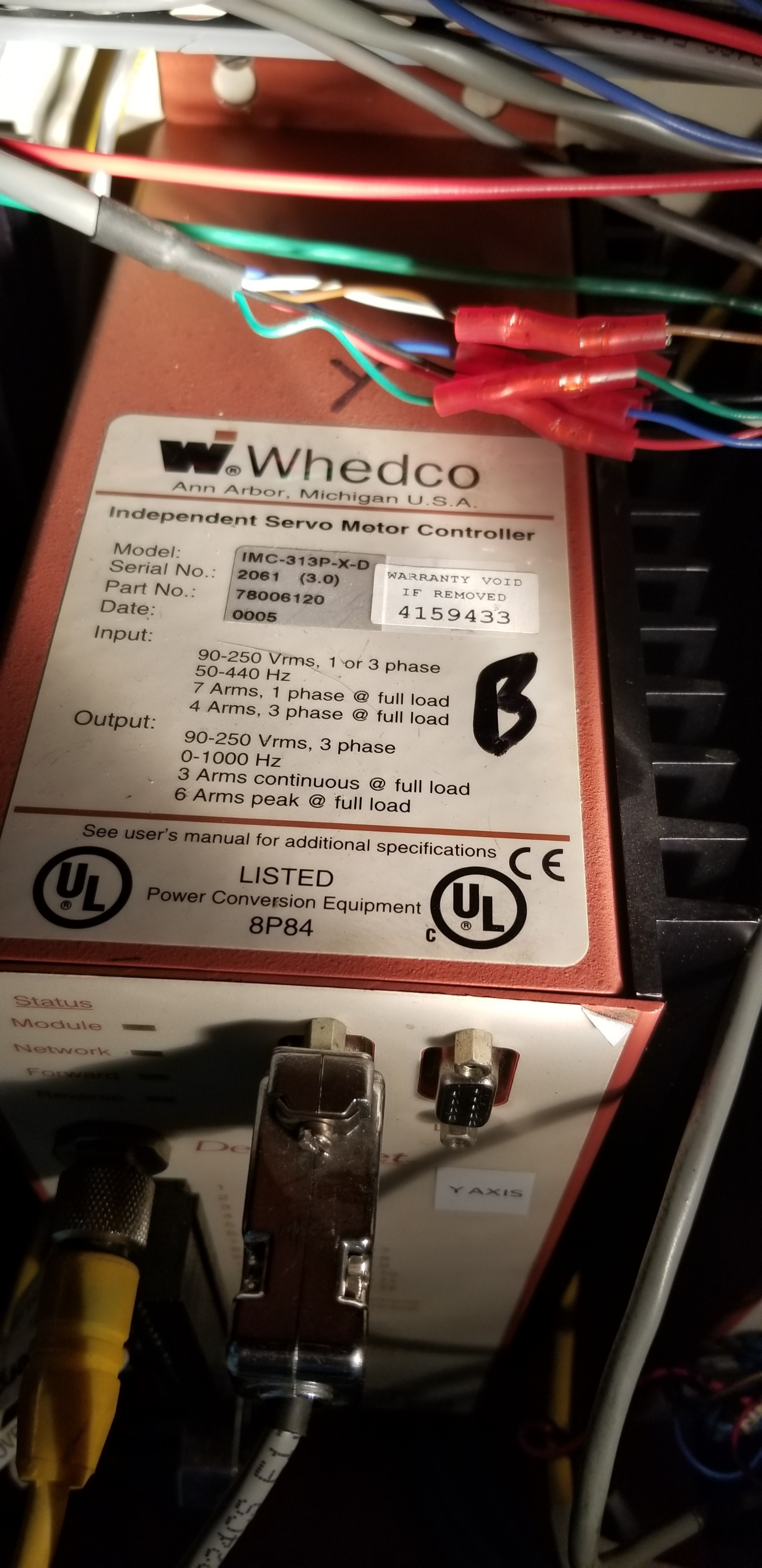

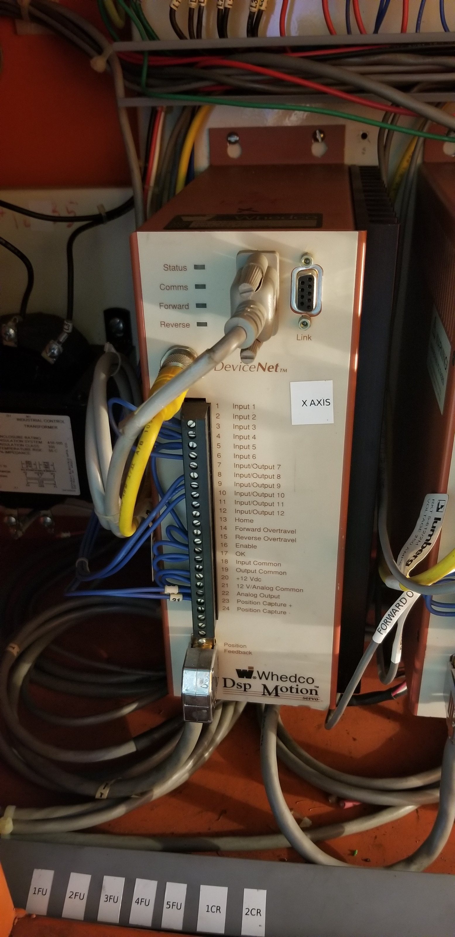

- Alloy Craft
- Posts: 28
11 Aug 2019 21:48 #141932
by Alloy Craft
Replied by Alloy Craft on topic Parker Majestic CNC surface grinder
Here is a photo of the drives. 2 are the same and the one that is the nc controller is a different part number. I believe these will run in velocity mode, however the motors use resolvers so it kinda limits your options. Also the drives are only configurable using a serial port and CCS which I don't have.
13 Aug 2019 18:48 #142072
Replied by andypugh on topic Parker Majestic CNC surface grinder
For a resolver system I used the 5i24 + 7i49 on my lathe and I am very happy with the results.
But... My resolvers connect to LinuxCNC and I suspect that yours connect to the drives? In that case you will need to figure out if the drives output a simulated quadrature for the motion controller to use.
My lathe (and mill) use a dumb drive (8i20) and do commutation in software. This works but would probably be a retrograde step in your case if you have working drives.
The 7i49 will _not_ work if the resolver excitation is from the drives, so don't rush out and buy one...
