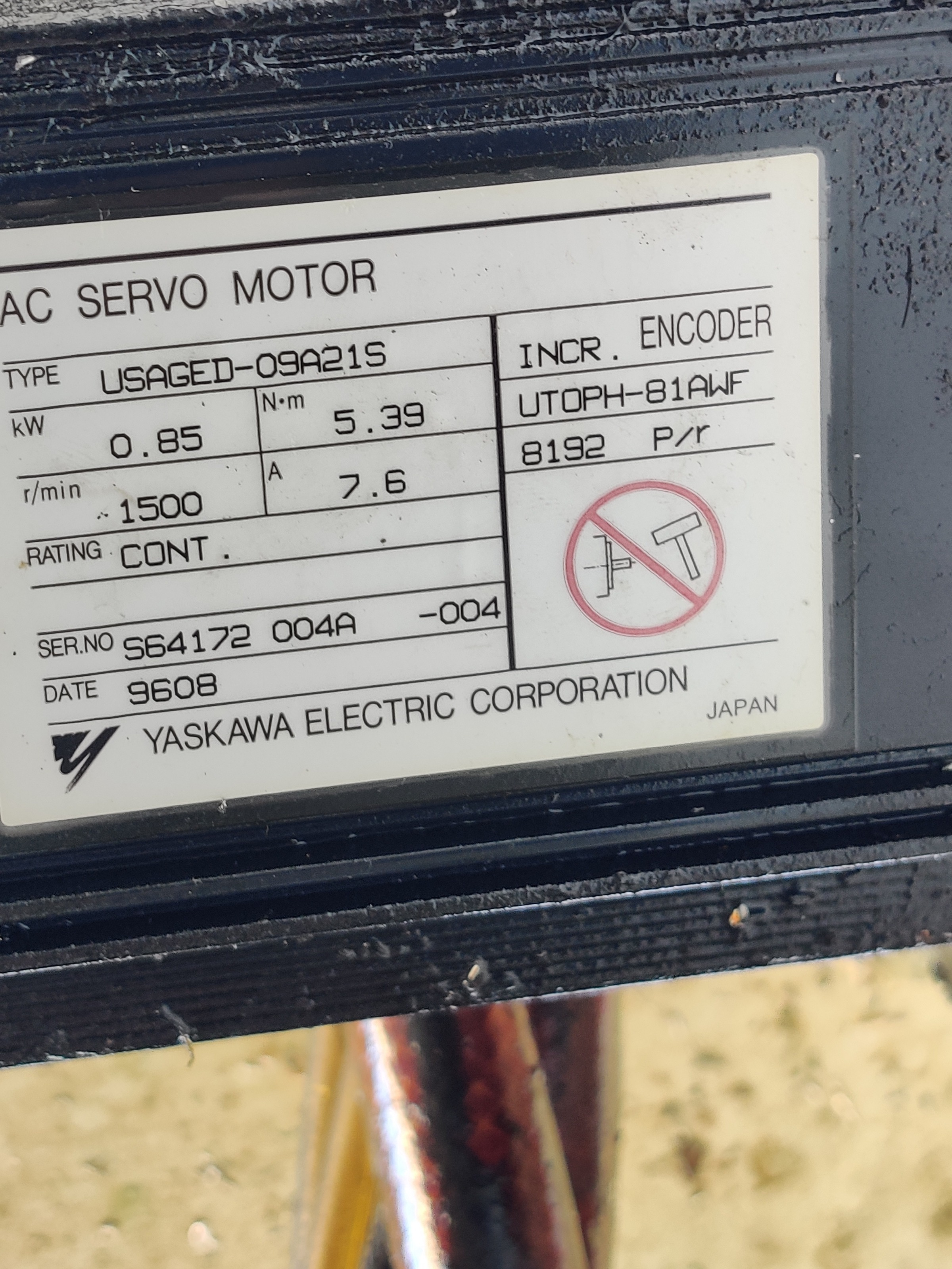

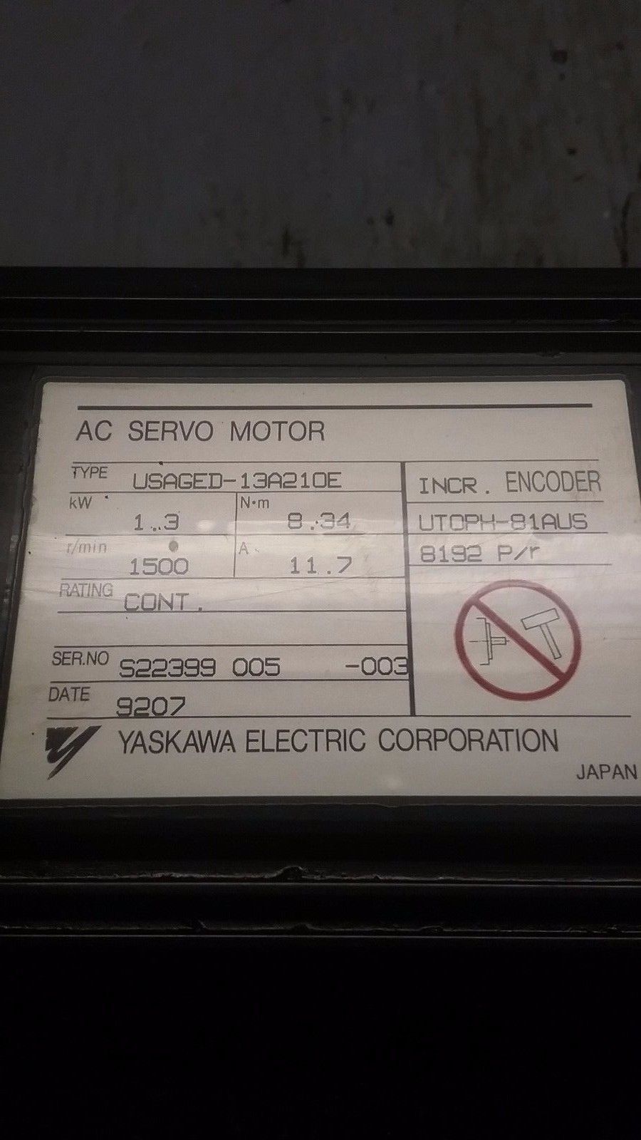

I have a Kitamura Mycenter 0 I am contemplating on retrofitting. I looked into the drives (CACR-IR-151515EBY33) and they appear to be incompatible with Mesa hardware. So now I am wondering if I can just replace the drives or do I really need a matched set (Servo + drive)? The drives I am looking at are these...
www.cnc4pc.com/dyn4-ac-servo-drive-t01-frame.html
Anyone happen to have any info on this?
My servos are...
X / Y..
Z..
Basically looking for recommendations.
My servos are...
X / Y..
Z..

The datasheet on the servos is here...
www.yaskawa.com/delegate/getAttachment?d...me=TSE-S800-4.1E.pdf
Looks like I can just input the info into the drive and I should be good to go. Hoping to have someone with more experience take a look at it for me.
