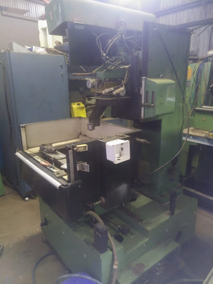

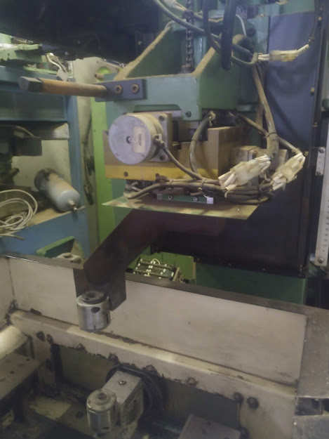

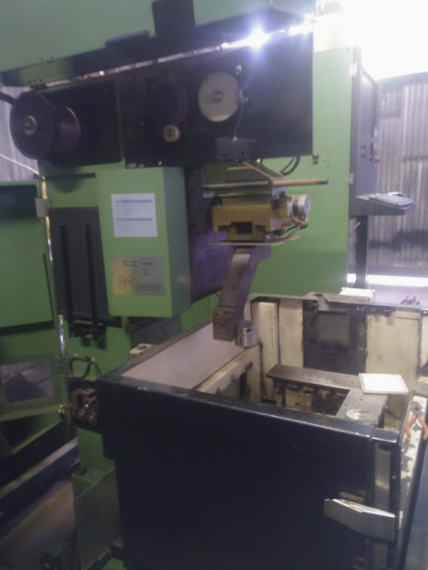

Hi all
I have a Sodick A320s with a mark ex controll that I basically got for nothing.
Has anyone here worked on these machines?
I would like to retrofit this machine but I can see that this is not going to be as simple as the lathes and mills that I have done before.
I was lucky to find similar wiring diagrams. They are for a machine some 2years younger but it seems to be very similar to my setup.
Henk
Henk
Last edit: 05 Jan 2020 12:41 by Henk. Reason: Typo in subject line

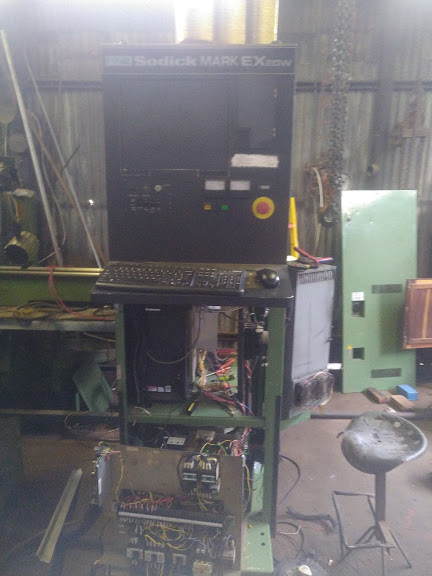

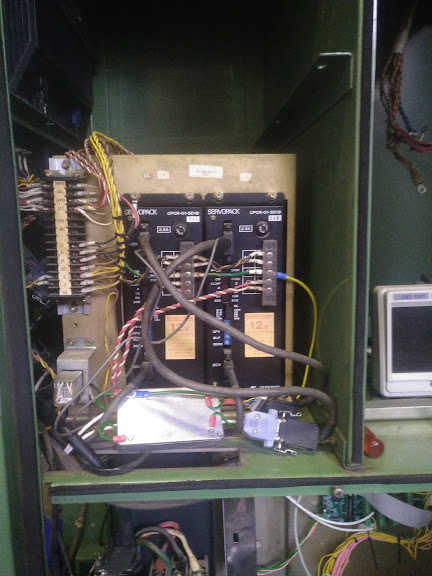

Update.
I managed to get most of the easy stuff sorted out and working. XY and UV axes working, Wire run and tension working the way it used to with speed and tension adjustable with the original hardware. I am using moion.spindle-enable to start the wire run.
Im happy with what i have so far. Now i have to move on to the more difficult part, the spark source. I have researched a lot on this topic and i have a prototype design that i want to start testing sometime this weekend.
For this i think i will need a custom bitfile for the 7i76E. I am using a cheap 5 axis LPT type BOB connected to one of the expansion ports on the 7i76E and i would like to use two PWM channels on pins 2 and 4. These will drive the MOSFET gate driver circuit to control the spark pulse length and frequency from LCNC.
Is there already a Bitfile that can do that? I tried finding one but there doesnt seem to be any PIN files that is human readable on the download from the Mesa site.
Maybe PCW can advise?

I have made some progress since my last post. Basically I have everything working on my machine but I had no option but to ditch the original spark generator. The original one is very complex and I could not find enough info on it to even try and get it integrated with linuxcnc. The multi layer PCBs in it makes it impossible to try and trace the circuits so that was a no go as well.
I have built my own spark generator and I have made some test cuts in steel up to 30mm thick. Im now starting to understand the enormity of the task that I have took on....it is not simple at all.
If you are prepared to spend money, buy the BAXedm spark generator. I don't have first hand experience on it but that will solve a lot of problems if what is advertised is true.
I am now playing with the adaptive control that is supposed to control the spark gap by adjusting the feed rate based on the gap voltage. I have not spent enough time on this to be able to comment on it but I will try and post here some details and my findings in the future.
My spark generator is a simple high side MOSFET switch with adjustable current limiting resistors and also adjustable on and off times for the pulse. I don't have any feedback that is capable of adjusting pulse parameters (current, voltage, on and off times etc) automatically but some friends over here offered to help develop such a system.
In short. I have cut material, bit painfully slow and not yet useable at this point. I have a lot of development still to do.
I will keep you posted.
