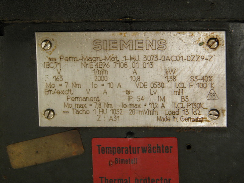

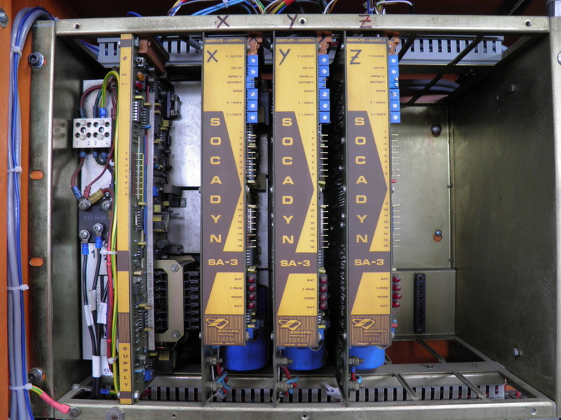

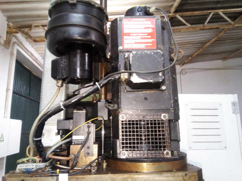

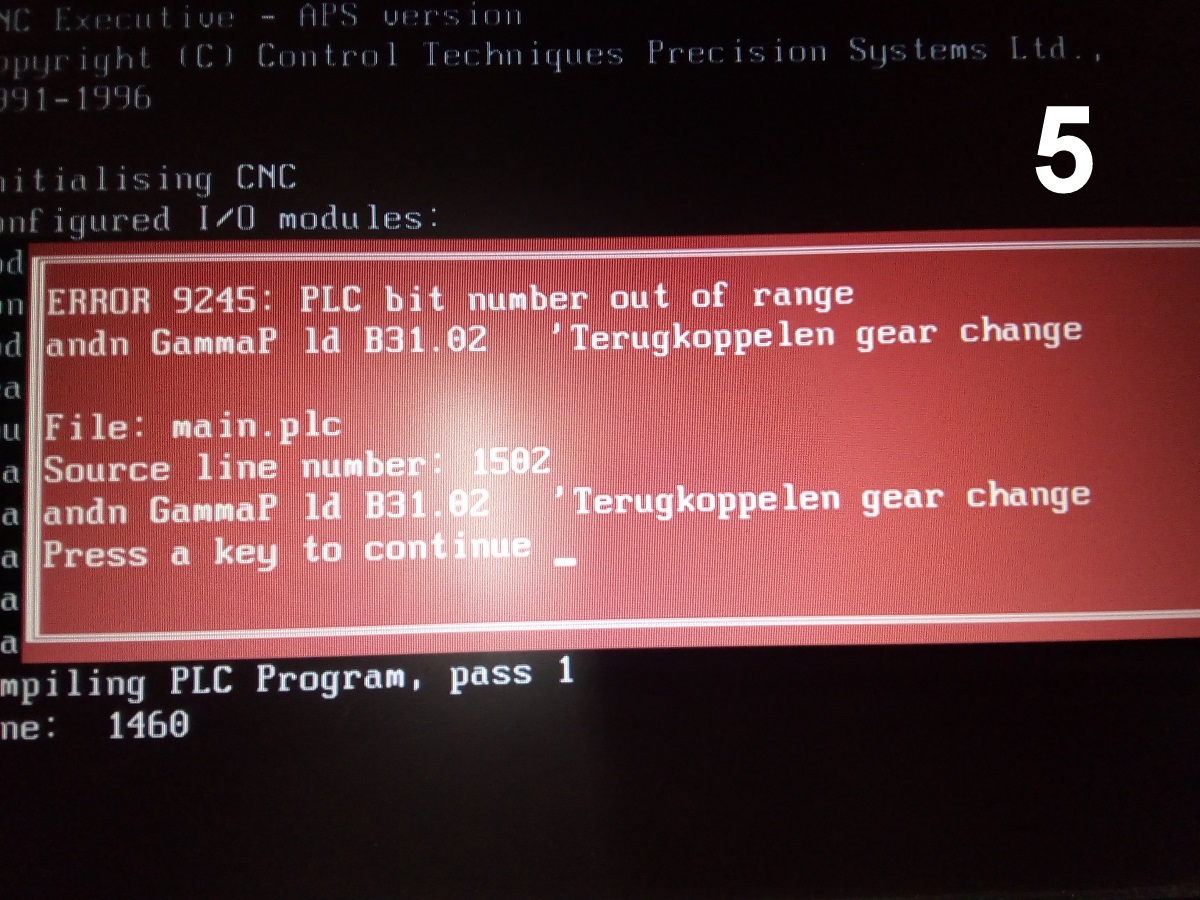

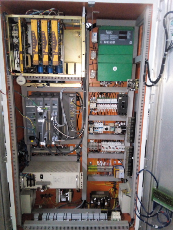

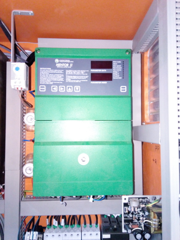

I bought this machine with a failure in the linear encoder of the Y axis.
I replaced the Y-axis encoder with a new one I bought in China (SINO brand) and it was solved. After solving the machine it was moving well on the axes, it was missing to get the spindle to work.
I had a Descktop monitor because the machine monitor was faulty, then I replaced it with a new one
I called the technician to put the spindle to work (it was just what was missing), the technician did not solve it, and so much touched the machine and the controller that the next day the controller no longer started.
Some photos of the machine.
I have a Spindle Drive manual
I have Control Technique FNC4 manual (It is very similar to that, FNC5)
And I also have a manual of the frame of the machine but with the diagrams in a modern model, tomorrow I'll post some pictures of it.
