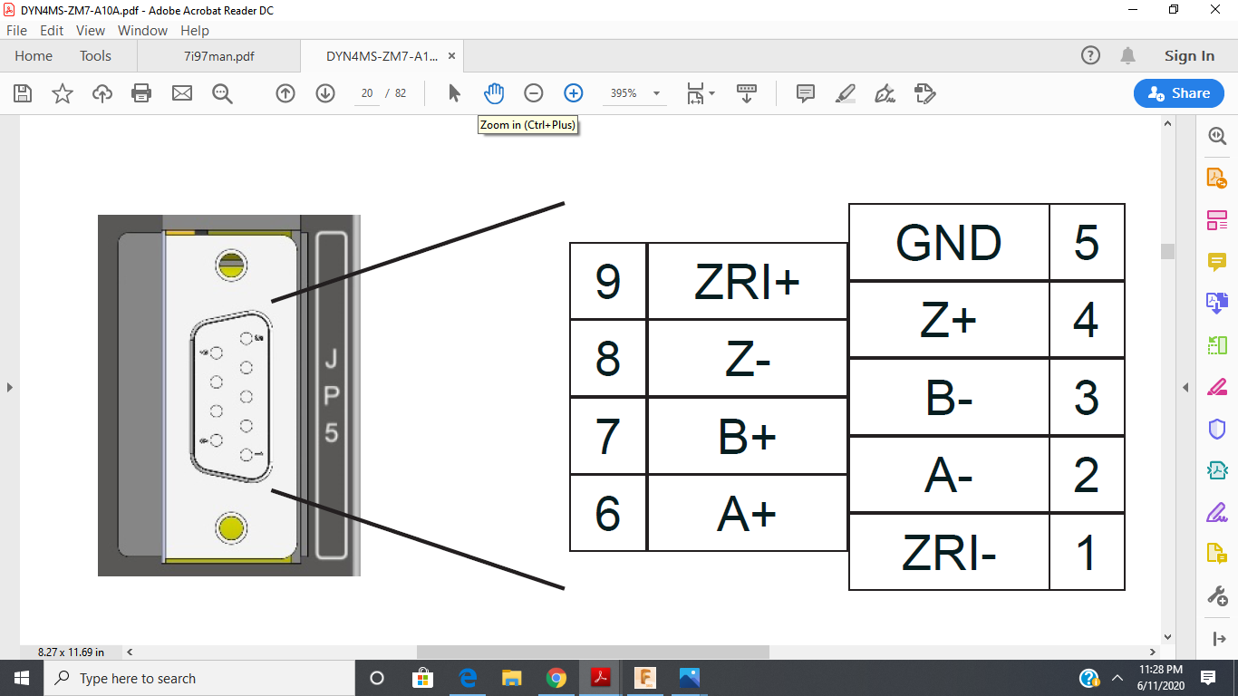

ok, so I got the machine moving. but I am having diffeculty with the PNCCONFIG and the spindle. I am using a DYN4 system and have it pinned as follows:
19 GND DYN4 - PIN 1 OR 9 OR 12
20 STEP 3 - N/A
21 STEP 3 + DYN4 - PIN 11 (PUL +)
22 DIR 3 - N/A
23 DIR 3 + DYN4 - PIN 22(DIR +)
24 5V DYN4 - PIN 12(ENA)
but when I get to the page where it lets me configure the spindle. its asking for an encoder input... how do I get around this, I am not at the point yet where I can hook my encoder up to the system.
20 STEP 3 - N/A
22 DIR 3 - N/A

On the DYN4 drives you have a 9 pin connector with the encoder signals. each pin is marked in the picture i'm going to post. if you get something like the cables i am showing you you will notice that the wires are color coded in the PDF. this makes tracing them back to the proper pins a lot easier. but basically what you need to to is plug on end into the drive and cut the other end off and solder connections to the individual wires for your encoder connections on the board. this is probably easier.
here is a link for the cables too.
www.digikey.com/catalog/en/partgroup/d-s...11-00200&vendor=1175

one other thing i noticed is your ENA pin marked as pin 12 on the DYN4 I think that's pin 15 on the DYN4. pin 12 is a GND. and i am not sure about how you do spindle control with step and direction signals. everything i have done has been with +/- 10 V for spindle control. you could very well be able to do it with step and direction i just know nothing about it done that way so i can't be of much help there. i will take a look for the 7i96 spindle connections to see if i can see how it's done.
