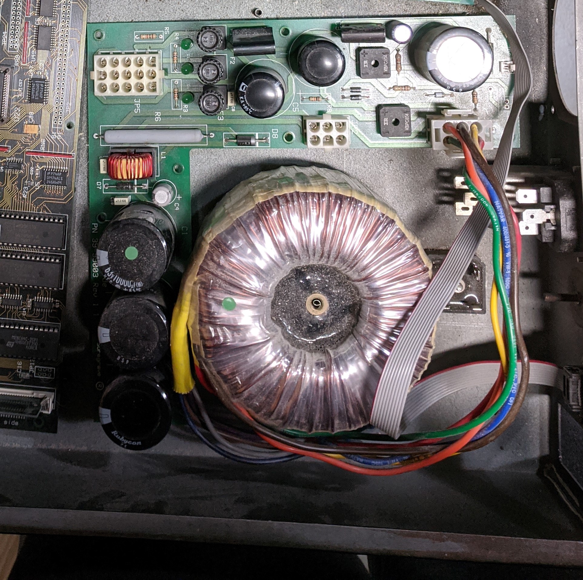

You mean a big transformer like this one!?
But knowing I can control it manually is good enough for me, for now.

Something is very wrong, i can not see anything that can handle 50A on any of the old boards. That PDF must be for something different, for sure.
Moving on, since this started to move laterally pretty fast.

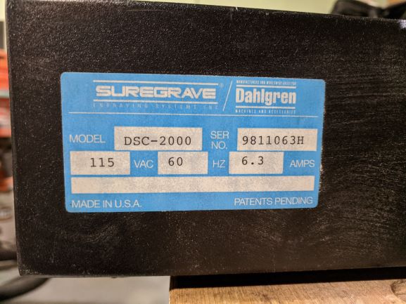

So while I was looking for more information about the motor, it dawned on me that it might be good to look up the controller information. I snapped a photo of the sticker with the model information, seen below:
The controller box is a Suregrave/Dahlgren DSC-2000, serial number 9811063H. Not sure if this rings a bell for anyone, but thought it couldn't hurt to share.
Last edit: 26 Feb 2020 02:37 by dzawacki. Reason: Fixed a typo on the model number

Further digging for some information on the DSC-2000 Serial Controller has me hitting some dead ends. Archive.org had this page:
web.archive.org/web/20001023212117/http:...grave.com/serial.htm
Aside from purchasing the RC ESC as previously mentioned, I'm at a loss here.
Any thoughts?
Any thoughts?
