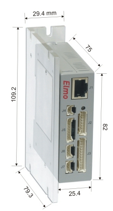

Hi all.
After long time of stopping (last but not least because of the damn Covid19), I'm back to my home made CNC.
Until last autumn I kept watching problems with all my cnc works. If I had to do a...big work, I didn't appreciate big problems, but with small works (i.e. PCB milling) unfortunately I realized big problems, like step loss, dimensional issues, ad so on.
After some discussion on several blogs, I decided to follow some advice and get new motors and drivers. More exactly, i got these motor: APM-SB02ADK-9 and these drivers: Elmo Harmonica HAR-8/60C-3.
Until now, I'm using "standard" drivers and motors.
Eventually, next week I'll get the new motor brackets ('cause the old ones don't fit the new motors), so it will be time to install and connect the new hardware.
In the meanwhile, I'm starting to check for directions about the installation and set up of the hardware, but honestly it's now a couple of days I'm reading tech manuals and so about my new drivers without understand anything.....
So, I'm asking some help, is some of you knows this kind of hardware and can help me to easily install and setup them (you know, like a child...).
Thanks in advance to anyone.

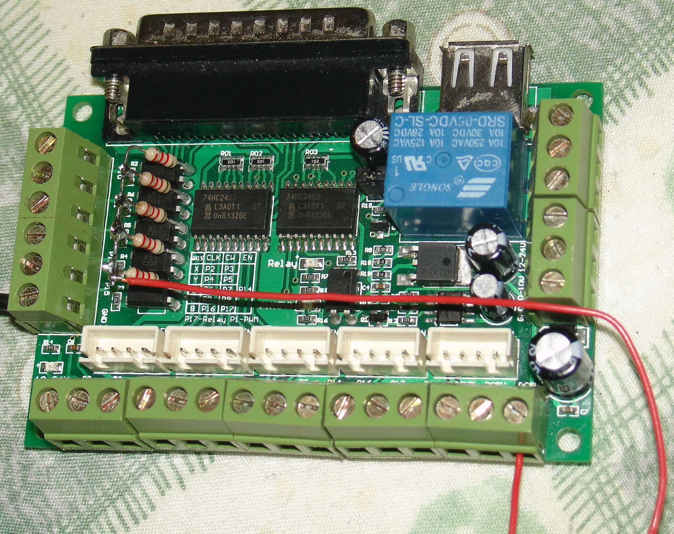

Yes,i know this hardware it's such high end one. No,i don't really need such high end stuff. But i had a problem,all the settings and solution i could try (as for my knowledges) i did,but no way.... Someone suggested me for this new stuff,i found a good occasion to get them (a bankrupticy) at good price,so.....
No,i don't have such controller to enjoy the full capabilities of the new stuff (i use a poor 10€ chinese bob).
In the next future i'm thinking to switch to a better controller (hopefully usb,'cause i've many delay problems with my parallel port - but i like linuxcnc and don't want to drop it....)
By the way,these last days i've been brainstorming about the drivers,and i think i've to use the analog input in order to wire them to my bob.
Of course,i won't use the full capabilities,but i hope at least to fix my problems (step loss and whatever else)
Or if you can address me some other better way,i appreciate.

@bbsr_5a
well, attached is my ....electronics, if it could be useful
Well, sometimes I think about upgrade my electronics to get something better (such mesa), and I really hope to do it in the very next future.
I'd have to....prepare myself learning the new hardware and understand how it works. When I started with the chinese BOB it was not really hard to understand the philosophy, but it took some time to me.
Mesa is lightyears away from my BOB, an it will require me some care.
@bbsr_5a

i think those drives will do dual loop feedback all in the drive and can be set up in pretty much any configuration. i was going to attach the PDF but the file is to large so here is a link to the website.
www.elmomc.com/product/harmonica/

Well, going on wy my upgrade.
While I'm thinking about get a mesa card as RodW suggested (thinking about the ethernet version), I'm figuring out how to connect the Elmo Harmonica Drivers to the motor and the current BOB, so to start playing while getting the new card.
While it seems to me not difficult to wire the motors to the drivers (the manual says it doesn't matter to match the phase, as the driver will fix it internally - wow), I'm just wondering about the wiring of the analog input (J7).
The 3 pins connector wires: Ground, AnalogInput1+, AnalogInput1-
My puzzlement is: I know Step and Dir.....Ground is ground (ok), but where to connect Step and Dir? wich is +1 and wich -1?......
Andrea
