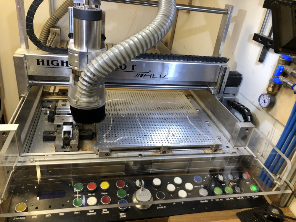

I have made some changes to the original HighZ
- replaced the spindle with a 24krpm 1.5kW
- added a vacuum table and a vise as seen in the picture.

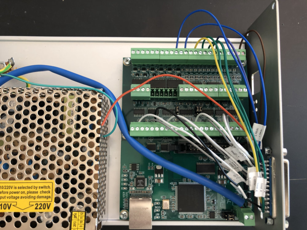

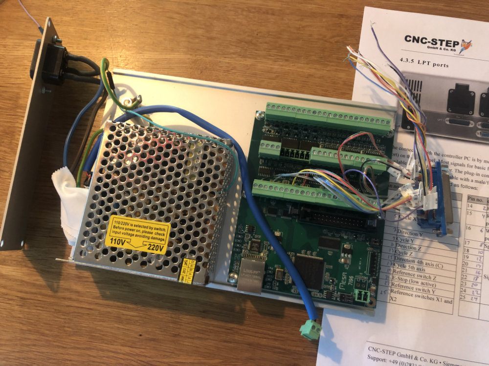

The band cable was unreasonably tangly when I split it into individual cables. It got so ugly, so I switched to soldering instead. That way I could chose better colors and less tangly cables.
The orange cable is for the spindle PWM. I don't know where to connect it. Hoping for an answer for this.
forum.linuxcnc.org/27-driver-boards/3923...96-which-pin-for-pwm
