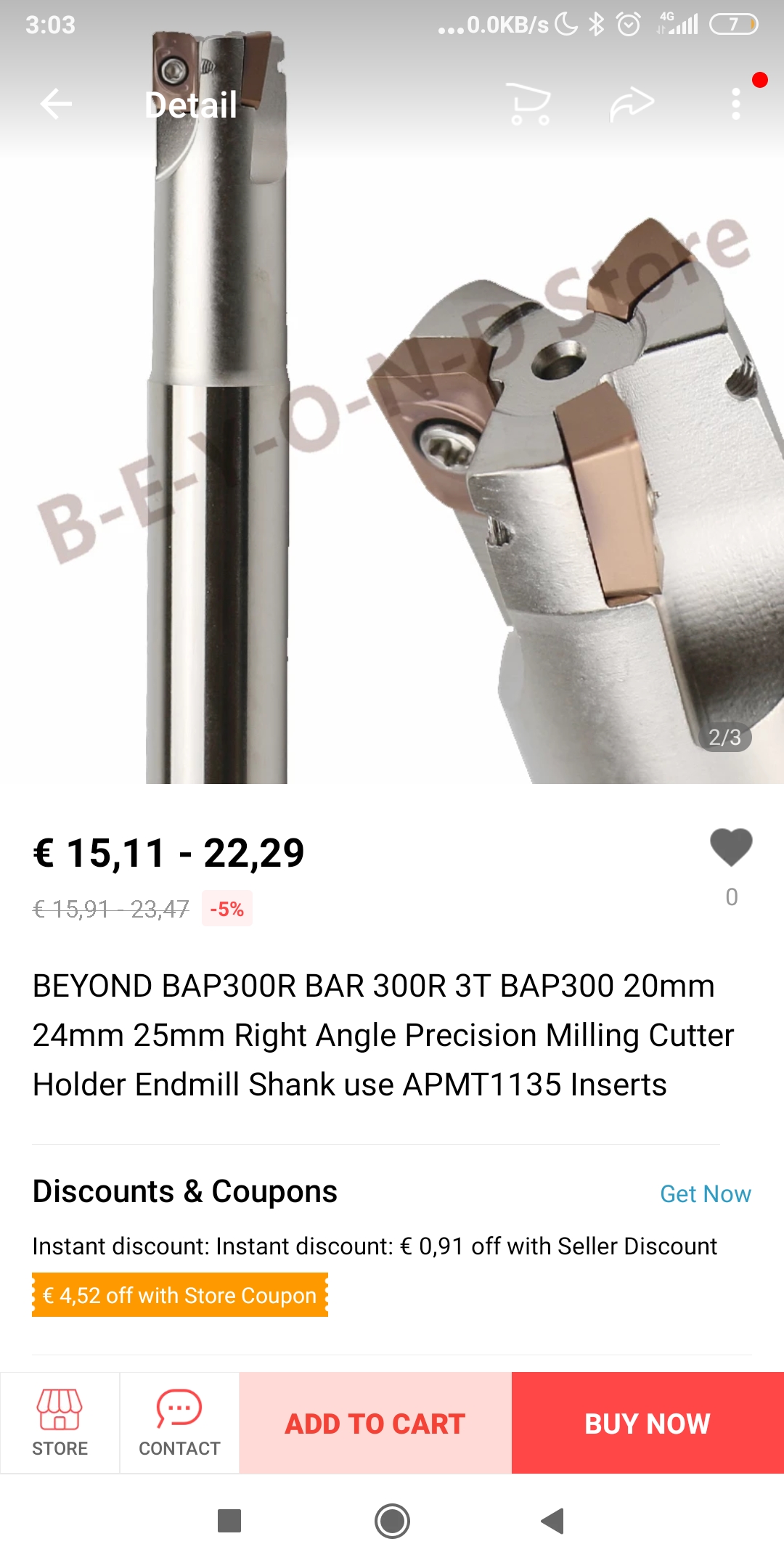

07 Jun 2020 01:07 #170431
by Marcodi
Replied by Marcodi on topic I want to mill steel with this machine.

07 Jun 2020 08:02 #170444
by bbsr_5a
Replied by bbsr_5a on topic I want to mill steel with this machine.
YES on the tool you showed
make shure you can insert CARBIDE bits
the standard may loose quick the edges on Plasma cut preholes
if you do a standard predrill they will work great
