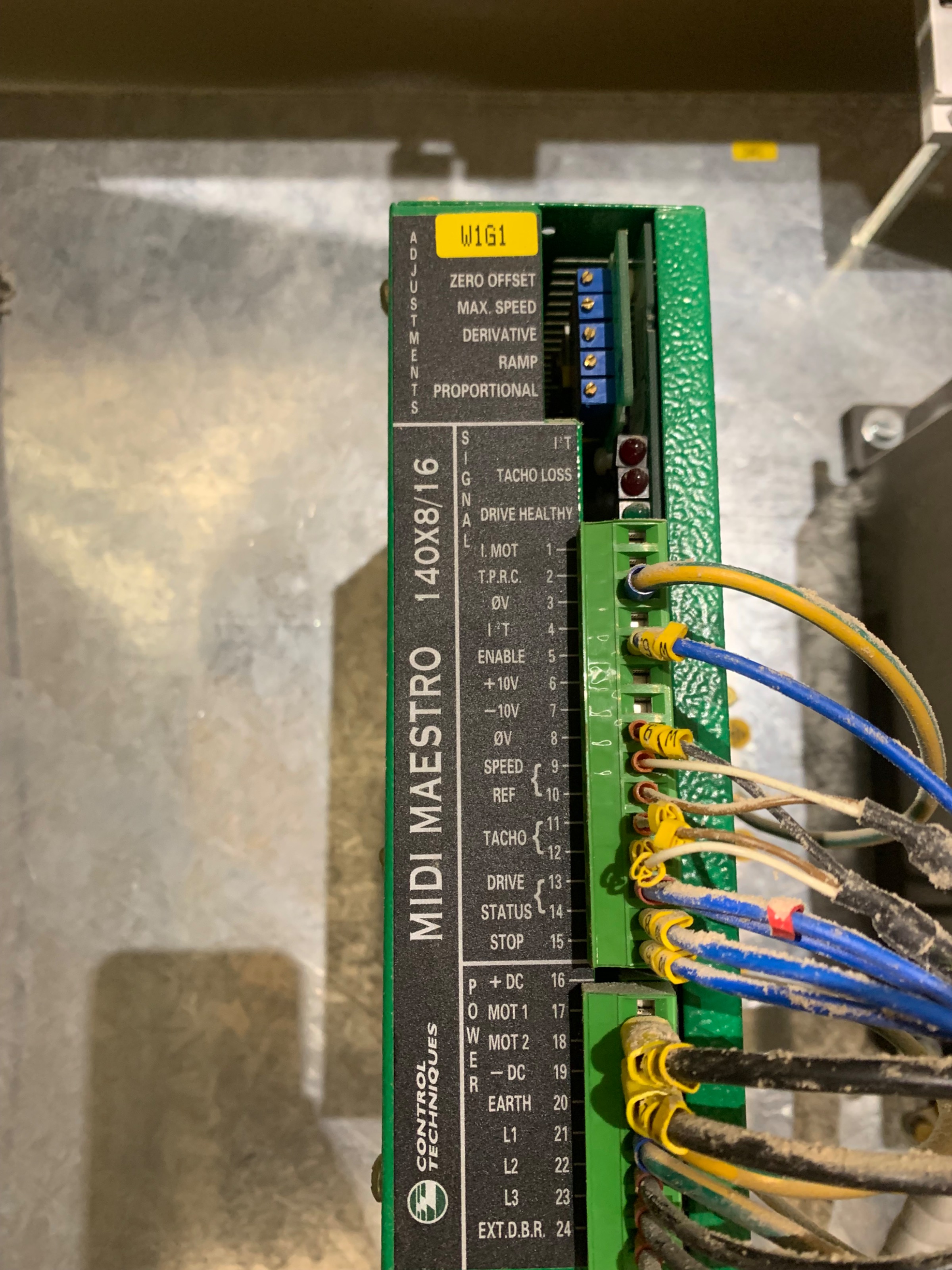

Hi there,
I recently bought very cheap record 220, but in non working condition since battery is dead in num 1040 controller.
Already have replacement BOB but now thinking why not try to fix original unit since everything is ready for it and machine also have 4th axis(that dont accept step/dir) and drilling unit.
Should I try to repair Num or take a time to connect everything with new BoB that would probably not been able to drive all in/outs and 4.axis?

- C0bra
- Posts: 9
08 Oct 2024 02:39 #311545
by C0bra
Replied by C0bra on topic Retrofiting Scm record 220
Its uc300eth-max, about 20output and 45input.
Machine still have much more but its certanly enough if make connections more simply.
Thing is am not sure should I mess up factory instalations or maybe its better to get controller fixed and just threw it in and go, would benefit from 4.axis which motor is driven analog (tool turret maybe too) and I guess its professional nc. and is probably better quality and reliability that of diy approach.
On the other hand with new bob would have more possibility, like 4.axis on table rotation and add diode laser or plasma torch.
Have already tried those Yaskawa servos and are working with step/dir signal, just had some problem with endless motor vibration on X axis with smallest move of shaft.
Have swap it with Y drive and they work fine, its only happening with X drive on X servo.
Am not worried about tools turret since if cant work with step/dir its a small motor and probably have some stepper laying around that can replace it.
Here is pic of the drive for the 4.axis (tilting spindle head on sides).
Midi Maestro 140x8/16

- Posts: 22037
- Thank you received: 7505
08 Oct 2024 05:58 #311554
Replied by tommylight on topic Retrofiting Scm record 220
The servo drive in the picture has analog inputs that are not used, the speed ref pins are used, so might be quadrature or up/down signals?
That would have to be confirmed, so a manual would help.
If all other drives are step/dir, that makes things a bit easier, but the X issue must be fixed in the drive or it might just be interference from dangling cables.
I do not know what uc300eth is, but if it is for use with mach3/4 i would really, really avoid using it, seen to many machines left crippled by such retrofits.
Get Mesa boards, namely 7i96S with 7i85 and add 7i84 as required for IO, they use a single network cable so you can mount those on the gantry or near the spindles, makes wiring much easier.
Fixing old controllers is ok if something small is gone, but anything bigger and it costs much more than retrofitting it.
Also, do not solder the battery to the controller board without a properly grounded soldering iron.
