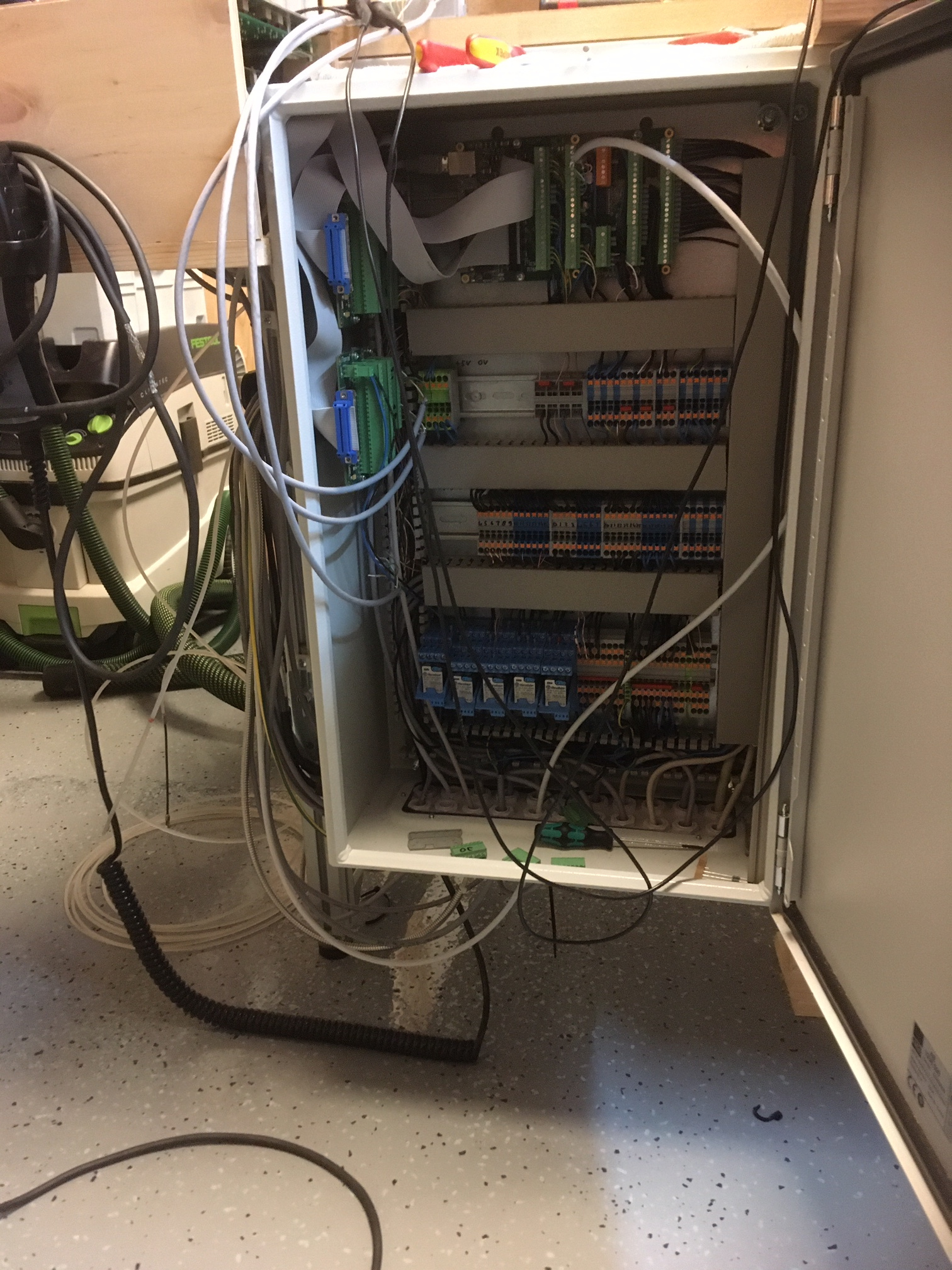

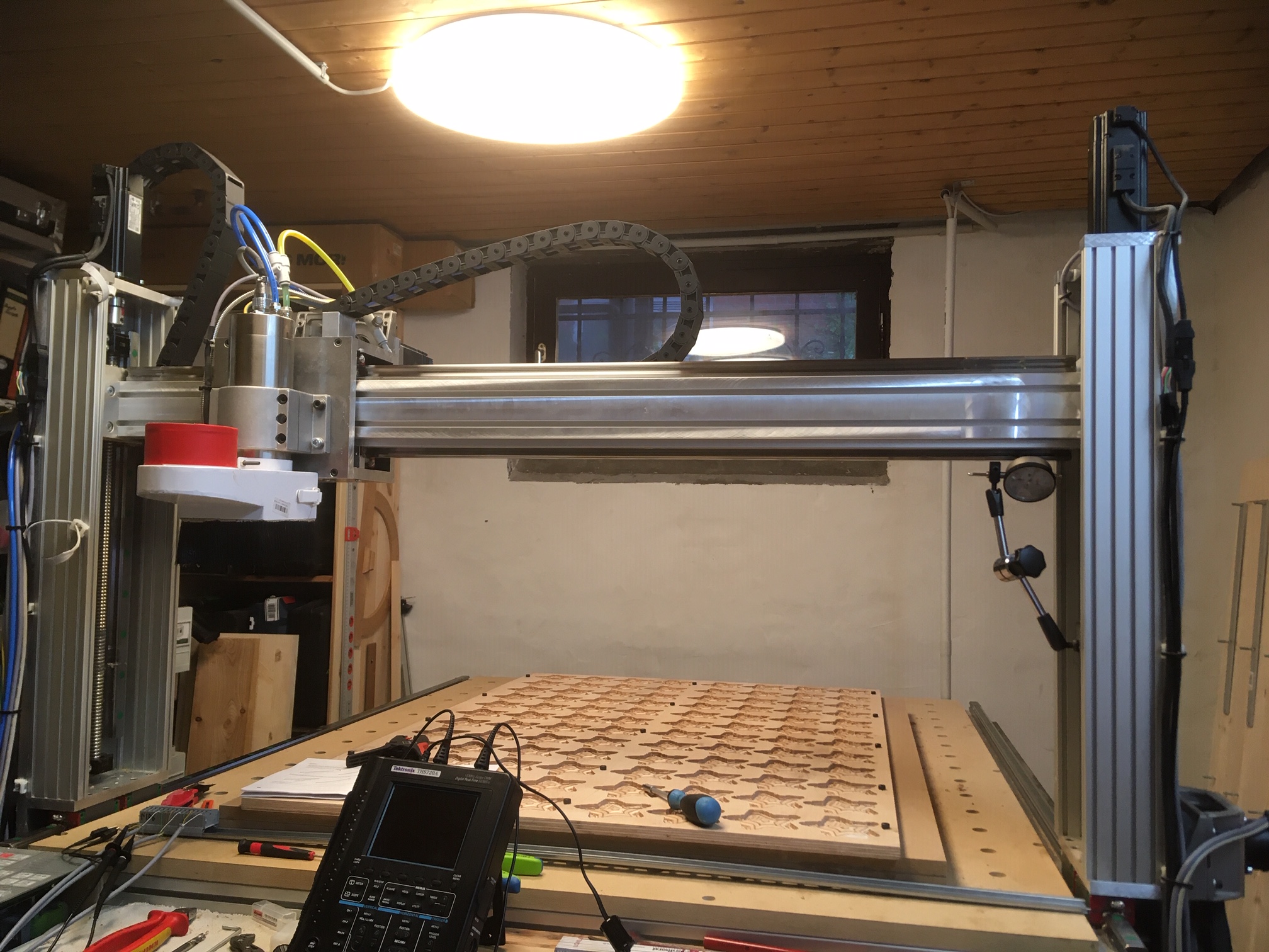

Hello,

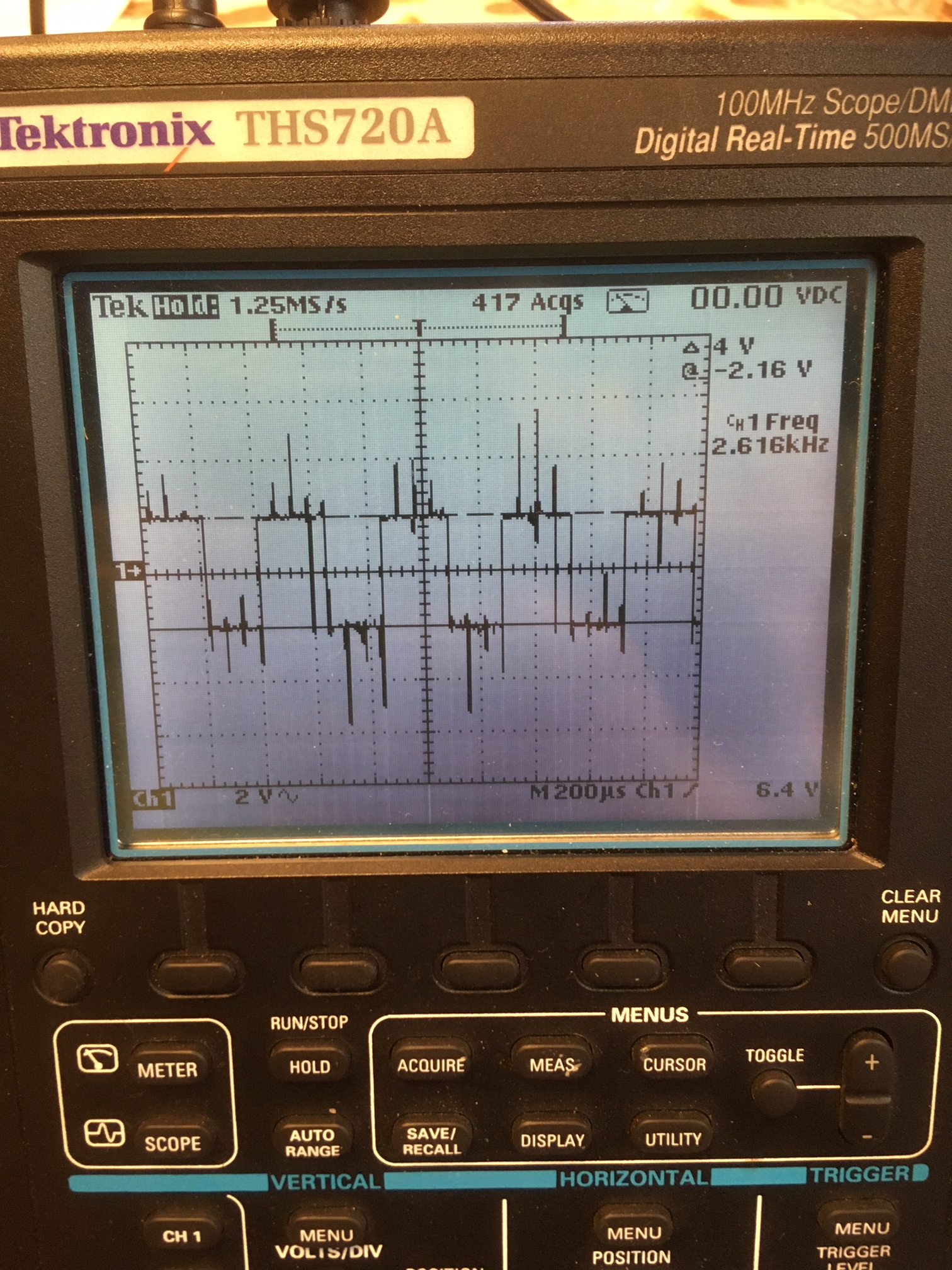

Problem is after long run runtime has my x axis shift position. So i take a look of my encoder signal and see much noise and only 4V. I try to adjust encoder head but it get not better. Second i use a seperate cable around machine but also same result. I measure other axis and looks good 5V and not so much noise. Finaly i found if Z-Axis ready the noise starts. In EMG no noise but also only 4V. And i have no idea wy?

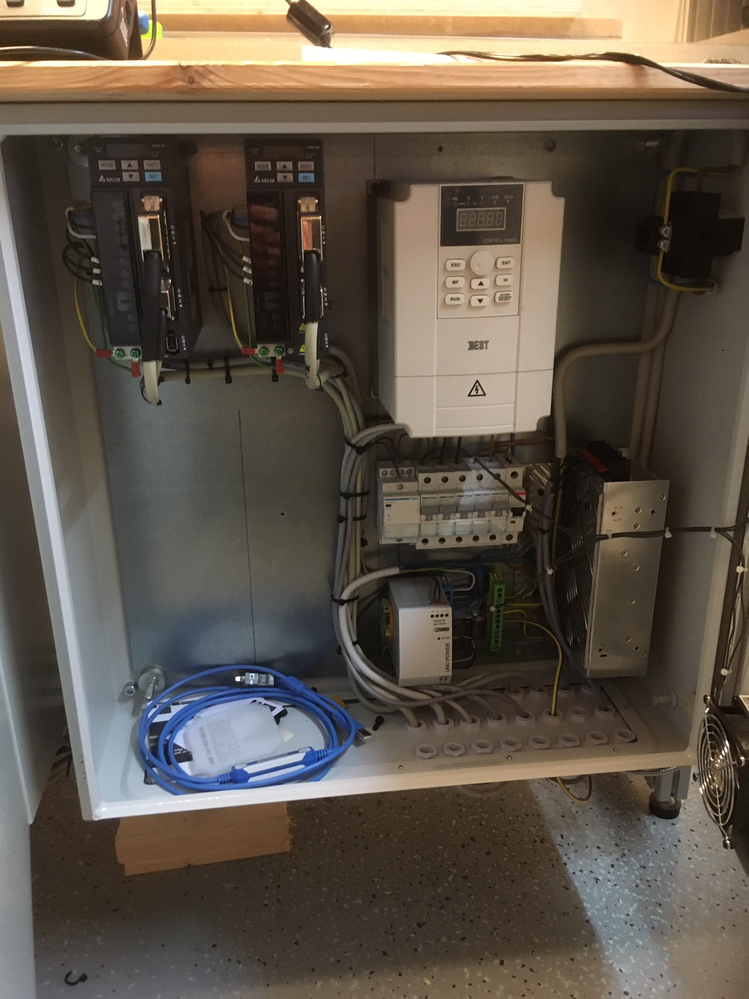

I use a separte electical cabinet for power and nc to avoid this kind of problems but it seems not good enough.
My last idea is to use a optocupler from ttl 5V input to Rs422 output. But i have no idea if its work or how to order?
Has someone hardware like this in use or an other solution?
Thanks Christian

- Check the connectors on the drive side if they are properly shielded,
- check if the cable is crimped
- if the cable is to long, do not roll it, never make a roll out of a signal cable
- use the encoder cable from the other drive too see if it does the same thing
- make sure the back plates on both boxes are properly grounded.

Note that 4V encoder signals should be fine and about what you
would expect from TTL drivers.
If these encoder signals go to Mesa encoder inputs you may be able
to increase the encode filter time constant to remove some noise

From the pictures it looks like it is a 7i76E, so the encoders are only on the drives.If these encoder signals go to Mesa encoder inputs ........

I'm not so sure as there are 2 daughterboards
- Posts: 21995
- Thank you received: 7488
24 Jul 2020 11:38 #175621
Thank you for pointing that out.
On the bottom one there are some shielded cables, but the shielding is not connected to anything, so if those are the encoder wires the shielding has to be grounded.
Replied by tommylight on topic Encoder Noise
Cr@p, missed those.I'm not so sure as there are 2 daughterboards

Yes Encoder connect to 7i85s And 7i85 cards. How to increase the encode filter time constant to remove some noise? Or is possible to use z Signal. Enoder is magnetic linear type. Mounted under x axis direct. Z axis is pulscoder on Servo.
The cable on button is y Axis Encoder. Outside is only protect. Scale is from DRO manual Lathe.
