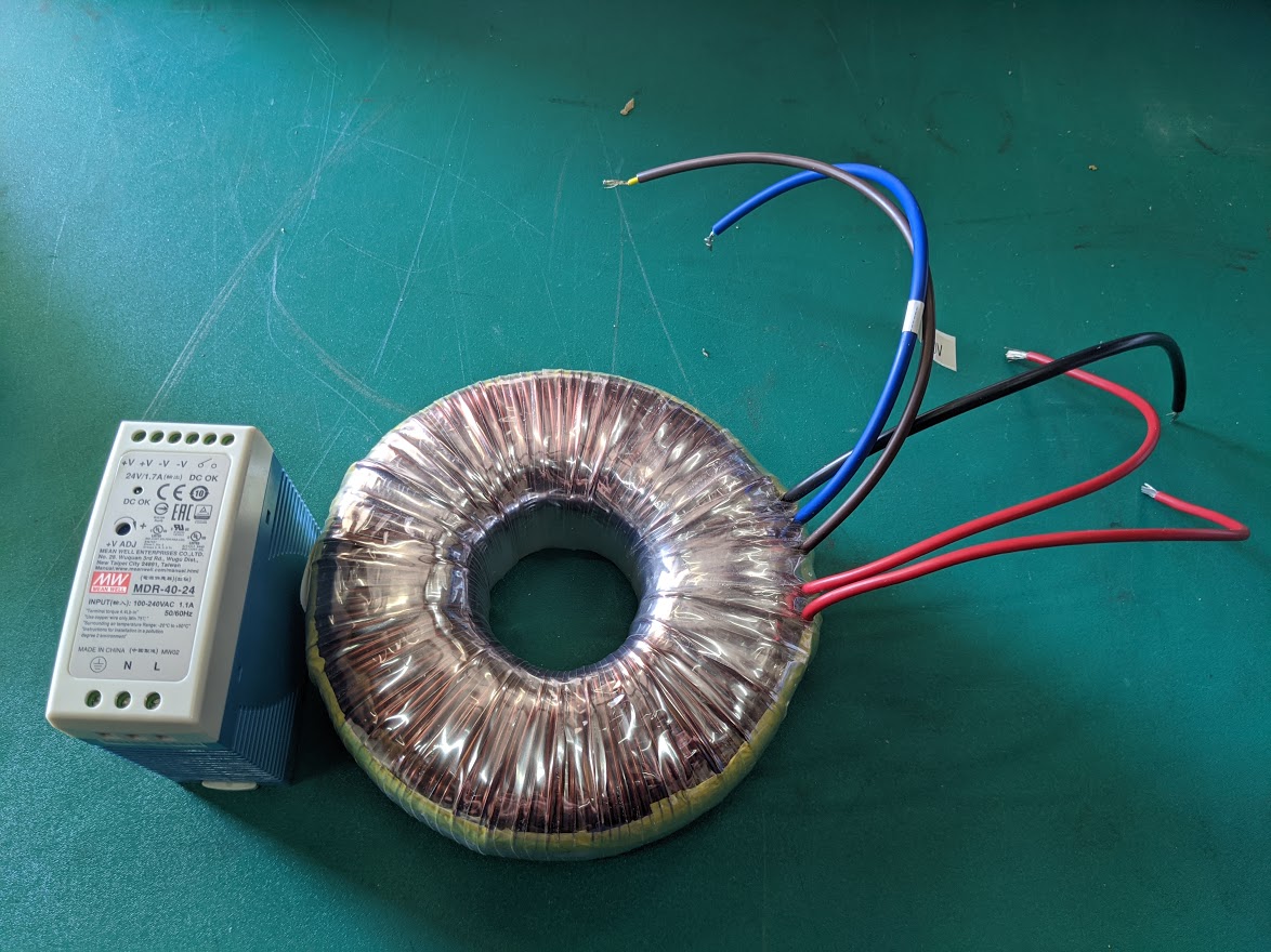

With the 7i76e, you could do it this way but for the 7i96, you have to add a 5V logic supply as well.
24v 1.7A Meanwell MDR-4-24 power supply and 60v AC 12.5A custom toroid dual wound for 110v and 240v input.
