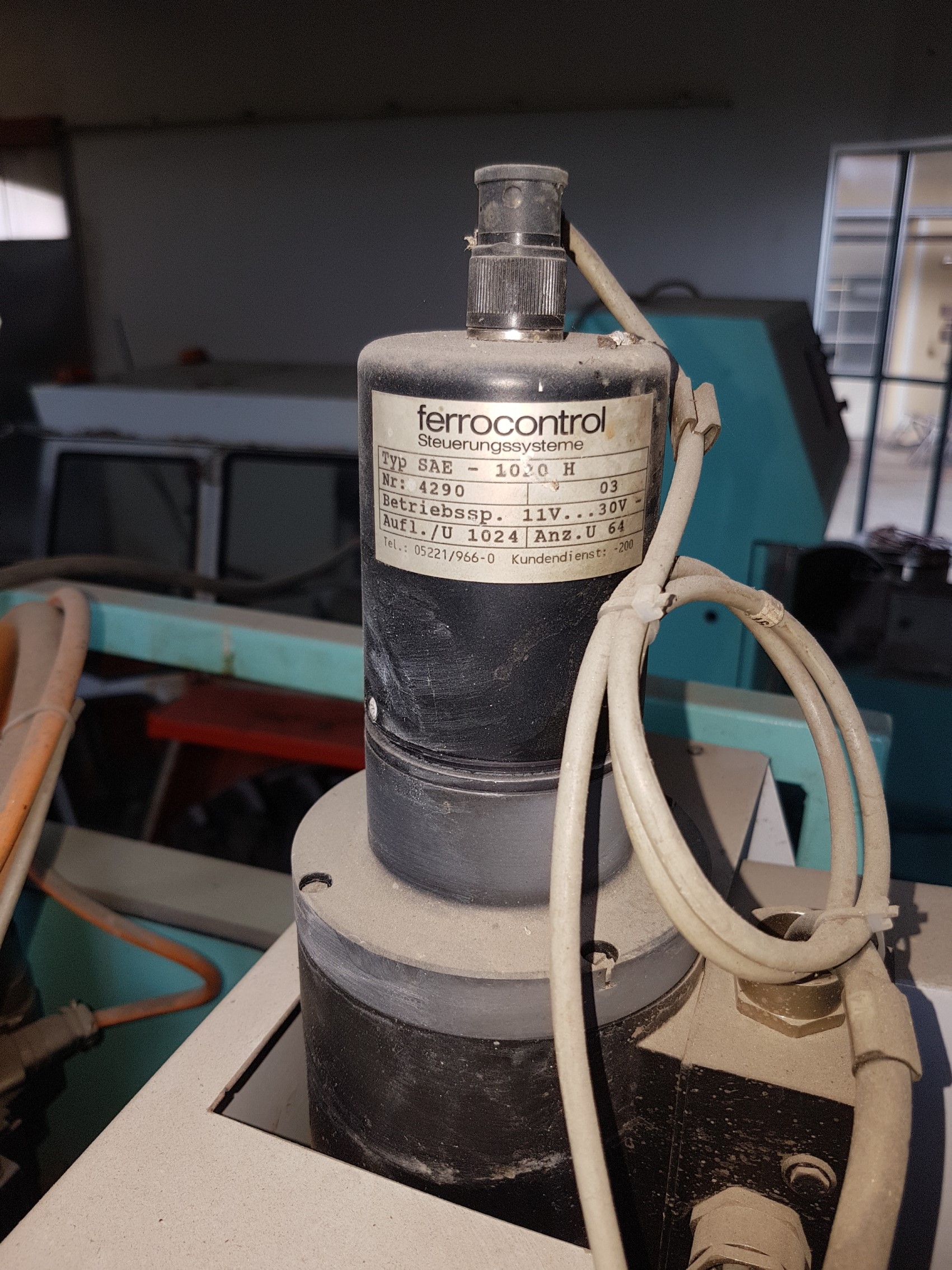

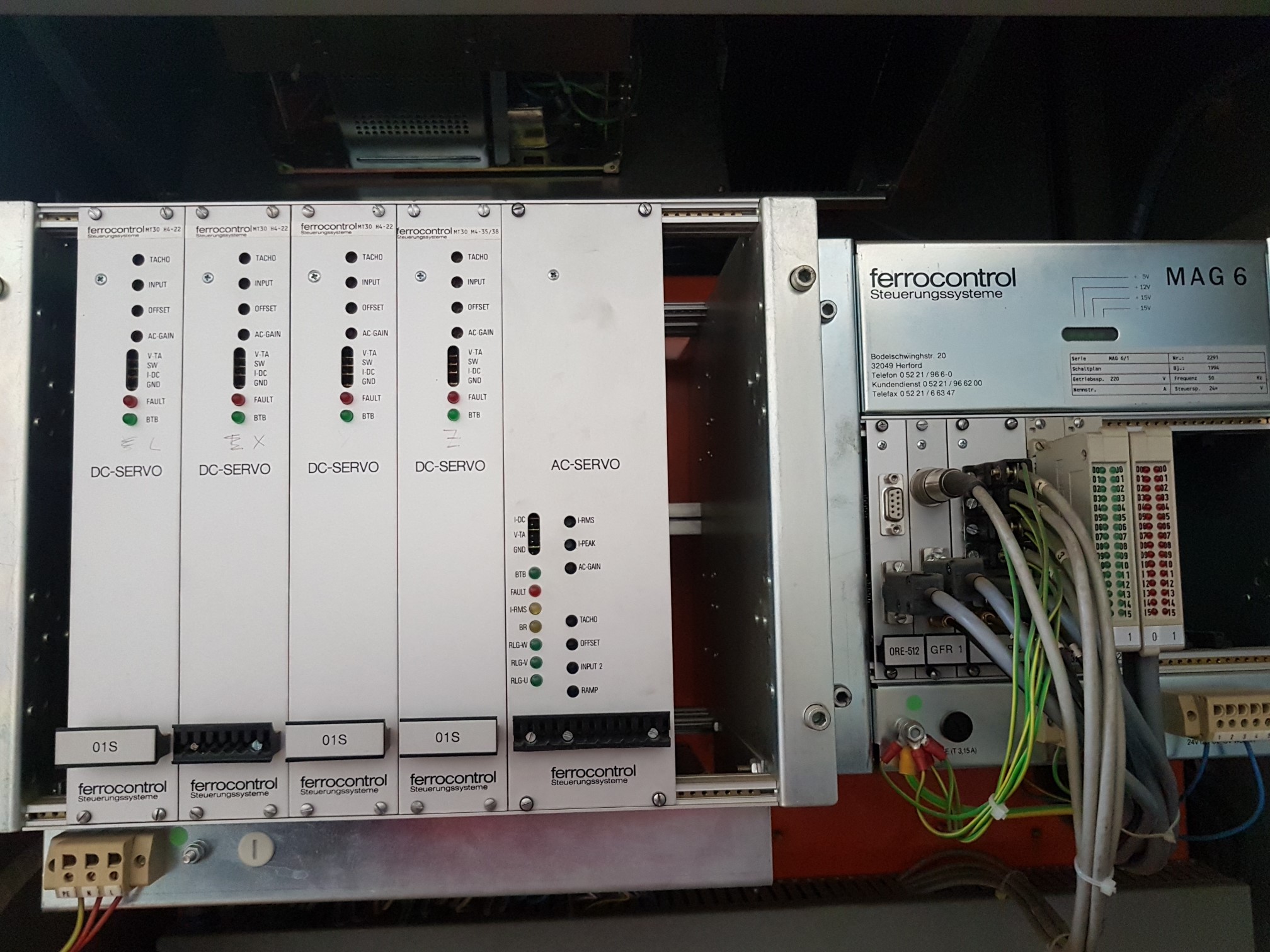

07 Dec 2020 16:44 #191326 by Benno
Replied by Benno on topic Another Elumatec SBZ130
Hi Tom, thank you for your support!!
I made some pictures for you, I think it is the same as yours. When I'm thinking on the encoder I get headache, they are all the same type but have different values. In the last row, the left value should be the count per revolution (there are some 1024 and 4096). But what means the second value: Anz. U (Anzahl Umdrehungen? Number of revolutions??) There I have a 1 on the spindle, the other are 64 and 4096. Do I use the direction pin on the long x-axis. I saw you have had some troubles with the encoder, but I can't follow it. I have to read it again.
Later, I will order the parts (6i25, 2x7i66, 7i70, 7i74, 7i77) and some mounting material. Then the next step is trial and error :-)
The machine is in a bad condition, it is some years unused and stored on top of each other, many air hoses are broken. I hope the winter is long enough.

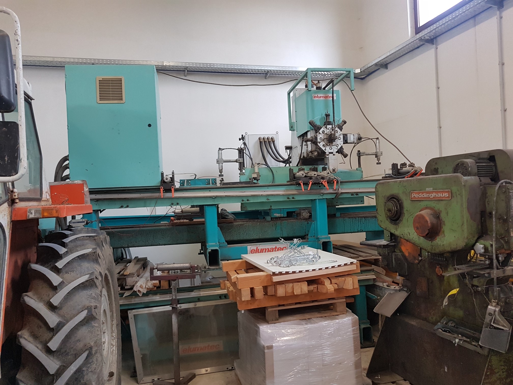

07 Dec 2020 19:56 #191345 by tommylight
Replied by tommylight on topic Another Elumatec SBZ130
It sure looks like it is the same, but where are the other parts ? Mine was over 7 meters long and 5000KG heavy!
You are lucky, i had nothing to go on so it took a lot of reading and searching and reading and.... :)
Seems like the encoders are also the same, so again you are lucky, you have a full working config for it. Even if they are not the same, it is easy to adjust for in the main hal file. Anz.U = my guess was the same as yours. And i did not use the direction pin, scratched my head a lot for it, tried it without it, it worked, so i moved on.
The issue with the encoder was as it usually happens, i was monitoring one of the encoders = the one that had a bad wiring = my bad, the rest was working properly but i was not monitoring them, so took a while to figure out my mistake. :)

07 Dec 2020 20:28 #191353 by Benno
tommylight wrote: It sure looks like it is the same, but where are the other parts ? Mine was over 7 meters long and 5000KG heavy!
It is disconnected in the middle. The main part is standing on the other with some pallets between.

07 Dec 2020 22:26 #191360 by tommylight
You are welcomed, always.
That is a magnificent machine with a 300x300x300x6450mm work envelope! To many numbers ? :)
That is literally a full 3 axis machine mounted on another 6450mm long X axis, with a 8 position tool changer.
It is made for work on aluminium, but the one i retrofitted has been working with 4 and 5mm metal profiles only since the day i fixed it, making slots and drilling holes. That is a testament to the quality of the machine, despite being misused for several years it is still working properly!
