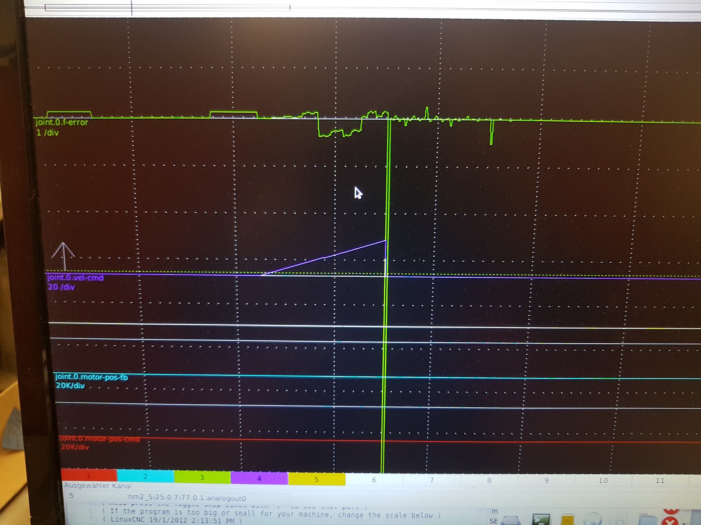

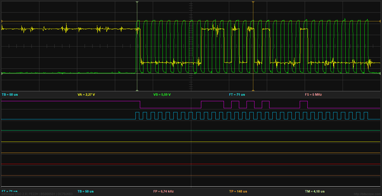

The last weeks I changed the air tubes, the electronics and I tried to calibrate the short x-axis. With the calibrating I have some troubles. I have found your note of calibrating. The encoders start working at approximately 8V, I power them now with 11V.
Sometimes the raw data jumps some hundred counts up and back. The 22 Bit should be ok, I have checked it with my oscilloscope (Data+, CLK+). I always get a joint following error, sometimes strait after enabling the machine.
What do you think (and other people), is the encoder broken or a connection problem?

If you suspect the encoder, try tuning the other axis and see how they behave.
As for encoders, pretty sure the + from encoder goes to - on Mesa 7i74, the signal wires i mean, and vice versa and i vaguely recal that causing me quite some headache with jumping counts.
And stick to that tutorial, it was written on that machine!

Juhu!! I swapped the wires, and it worked, you are great!!
In the middle of the movement, the rowcount value jumped between very high and very low, and I got a joint following error. I drove the axis in the end position, dismounted the encoder and turned it by hand to a low value. After build all together, I had may first reference run without an error!
With your help I had in 20 minutes more success than the last two days!
