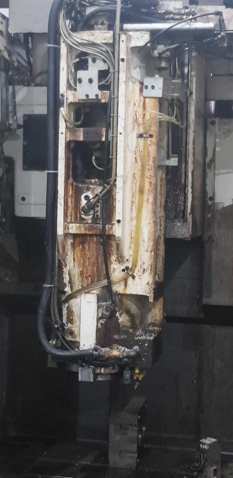

Hi guys i have a new project , that looks complicated . I have a spindle that has 2 windings on it and i need to chamge the inveter as is damaged . I has search but seems that no one make this kind of inverter. Any indeea what i can use its 22kw 3x220v ac
09 Dec 2020 13:35 #191523 by tommylight
Replied by tommylight on topic Okuma mv45 spindle problem
The picture shows wiring for a normal 3 phase motor.
The only motors in use with two winding are single phase Induction motors with a capacitor, and they only go up to 2.2KW in Europe.
My guess is that it is a normal 3 phase motors, after all they exist since Nikola Tesla invented them.

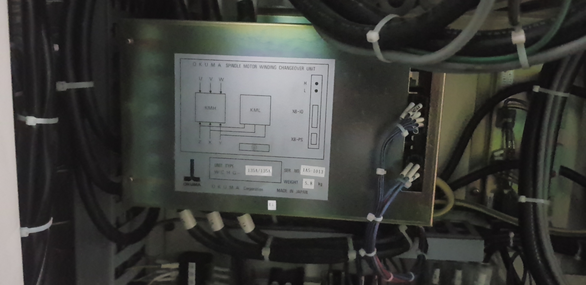

09 Dec 2020 14:07 - 09 Dec 2020 14:09 #191526 by PCW
Replied by PCW on topic Okuma mv45 spindle problem
The "Spindle motor changeover unit" rewires the motor
for "Wye" or "Delta" connections for low and high speed operation
respectively.
You would need to retain that part if you replace the spindle drive
VFD.
One tricky thing is that the VFD would require different settings
for the different motor connections. Some smarter VFDs
may have this capability (profile switching) but I'm not sure.
Also of course you cannot change the wiring contactors when in operation
(unless you like buying new VFDs)

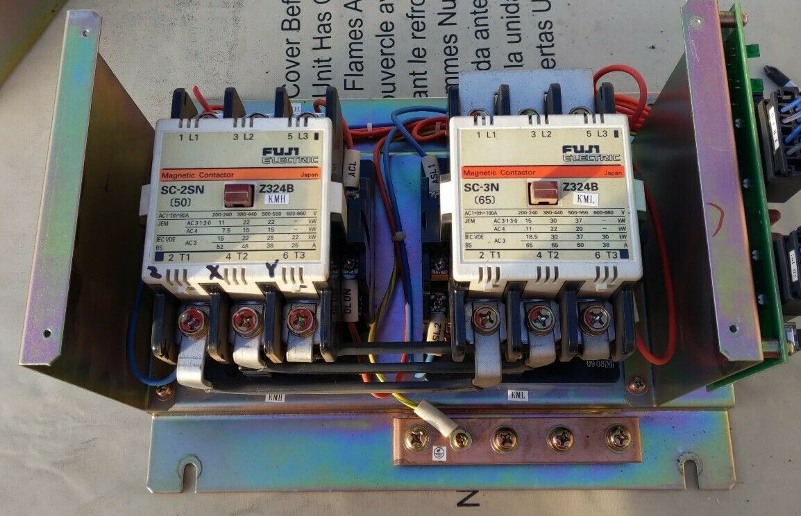

09 Dec 2020 14:46 - 09 Dec 2020 14:57 #191532 by PCW
Pretty sure the box shown is just a couple contactors
that could be reused even if you had to throw out the control
circuitry. I dont see any reason you could not use a standard
VFD and the contactor box to change the motor wiring.
The main issue is that the VFD setup parameters would be
different in Delta vs Wye connections. I wonder if these
parameters could be set via MODBUS?
Really need VFD expert here...
Edit: a little googling shows that some VFDs have this capability (multiple setups)
and can change setup based on digital inputs

10 Dec 2020 01:21 #191568 by aventtini
Replied by aventtini on topic Okuma mv45 spindle problem
inside de box , also it says 130a for a 22kw drive si not right.
10 Dec 2020 02:59 #191572 by Aciera
Replied by Aciera on topic Okuma mv45 spindle problem
i think i over think to much maybe , we need a inverter that can suport 2 motors , like overhead crane. The inverter must have 2 sets of parameters , and 2 outputs . For the input signal we can limit 0-5v one coil 5-10 second coil . Now the fun part is what brand of inverter can do this ?
Why two outputs? All you need is to be able to switch between two sets of parameters and then two contactors to choose the respective winding configuration. There are many VFD's that can switch between 2 different parameter settings. Often this has to be done through the RS485 interface.
10 Dec 2020 09:30 #191582 by PCW
As an example, some Trane VFDs have 4 sets of setup parameters you
can switch between based on digital inputs (or RS-485). Just need
to read some manuals...
