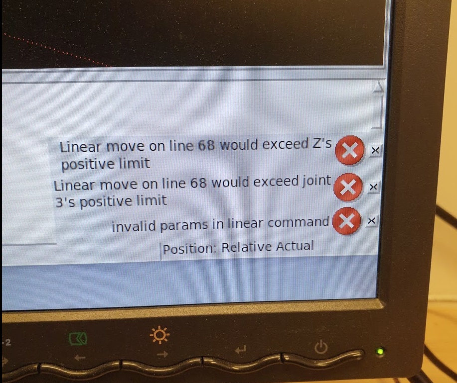

I changed my code accordingly and went to try it but ran in to another issue that i have seen before. I believe that for some reason the coordinate system in the tool--change.ngc file docent match my machines coordinate system its throwing errors as in attached picture i also attached a picture of the machines coordinates.
I have gotten past this error before by changing the values in the config section of the tool-change.ngc file to values that docent make since just to get past that hurdle. But now i actually need to input the values correctly according to my machine and its making these errors. My tool-change.ngc files is attached but copied in here is the values from the config section. i also attached the -ini and .hal files with the updated config.
CONFIGURATION PARAMETERS
#<_UseInches> = 0 ( set to 1 to use inches here, or 0 to use millimeters; should match units on tool.tbl dimensions )
#<_TravelZ> = 100.0 ( machine Z coordinate for travelling, typically near max Z to avoid ever hitting the work )
#<_TravelFeed> = 1000.0 ( feedrate used for general Z moves when avoiding G0 )
#<_ProbeX> = -230.0 ( machine X coordinate of switch/touch-off plate )
#<_ProbeY> = 3000.0 ( machine Y coordinate of switch/touch-off plate )
#<_ProbeFastZ> = 5.0 ( machine Z coord to move to before starting probe, longest tool should not touch switch at this Z )
#<_ProbeMinZ> = -20.0 ( machine Z coord to stop probe, shortest tool must touch switch at this Z, must be > min Z )
#<_ProbeRetract> = 1.5 ( small distance to retract before approaching switch/touch-off plate second time )
#<_ProbeFastFeed> = 400.0 ( feed rate for moving to _ProbeFastZ )
#<_ProbeFeed1> = 80.0 ( feed rate for touching switch/touch-off plate first time )
#<_ProbeFeed2> = 10.0 ( feed rate for touching switch/touch-off plate second time )
#<_ToolChangeX> = 70.0 ( machine X coordinate to pause at for manual tool changing )
#<_ToolChangeY> = -170.0 ( machine Y coordinate to pause at for manual tool changing )
#<_MistOnDuringProbe> = 0 ( set to 1 for mist, or 2 for coolant, or 0 for nothing during probing, to clear switch of swarf )
Once again i would ask for your valuable assistance, thanks.

Many of the moves in the toolchange.ngc are in the machine-absolute coordinate system.
G53 G1 ......
Moves in machine coordinates. This is almost certainly what you want to happen with a toolchange.
G53 G1 ......

You can switch the GUI to show absolute coordinates.
I am not entirely sure why you need to convert relative to absolute.
The idea would be to bolt the tool sensor to the machine bed so that it is always in the same position relative to the home switches.

17 Jan 2021 01:39 #195635
by BastianMC
That was also my plan, I wanna bolt the sensor down at the far back corner of my machine bed I permanently. I just need to know what coordinates I have to put in the tool-change file for that location. I wanna use the coordinates relative to the home switches on a daily basis as this is most logical. I will try and find out how to switch coordinates just for the tool probe location, once its set I cans switch back again I assume. Thanks.
Replied by BastianMC on topic Manual tool change + touch off lenght
And its working like a charm now!
Thanks for the support @andypugh helped me out so much.
