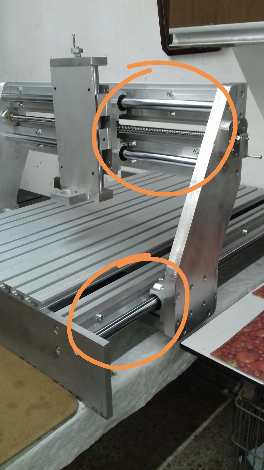

I attached an image of my machine while under construction.
Highlighted,the items i'm talking about (well,the visible ones,obviously there are some other leadscrews and rails).
About the "white petroleum" (this is what is written on the can) Is the same product you told (i use it for my motorbike too).
So, as i understand, you're suggesting me to use such "liquid" lubricant,instead of such a....sticky grease.
Ok,i'll hava a look to find the one you suggest me.
Andrra

Replied by tommylight on topic Taking care of your machine
Two strips of plastic or sheet metal on the sides will get rid of 80% of the dust on the rails.
I would not worry much about the upper rails.

Replied by andypugh on topic Taking care of your machine
You could consider some covers:
www.beakbane.co.uk/en/products/concertina-covers/
It is possible to make your own, with patience:
is the first video I found.

Replied by Jocman on topic Taking care of your machine
Yep, I've been thinking for such rail covers, I'd have to thinkering about.
The main thing puzzling me is the space available on Y front and rear. Y (the useful workspace) is about 700 mm; if on the rear side this gives me enough room (about 200 mm) to place such folded concertina-cover, on the front side it doesn't: when on Y0, the room between the front border and the base of X is about 20 mm. No way to...store the covers when the machine is close to Y0.
About the suggested lubricant (Mobil Vactra), I found it but we're talking about 20lt (5gal) and 180$.... For my hobbistic purposes it's really too much (quantity and money...)
But browsing the other lubricants, I found maybe something similar; I'm talking about lubricant for sewing machines, bike chains, generally speaking "moving parts".
Do you think it could be a good alternative?
Andrea

Replied by tecno on topic Taking care of your machine
Way oil VG68
Do you have workshops close with machines, ask to buy a small amount.
Where are you located?
