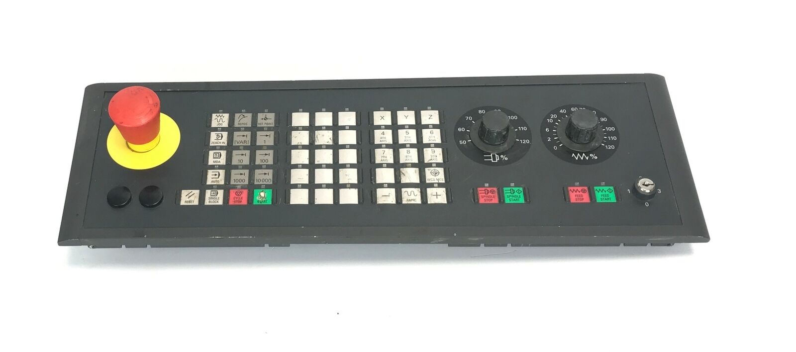

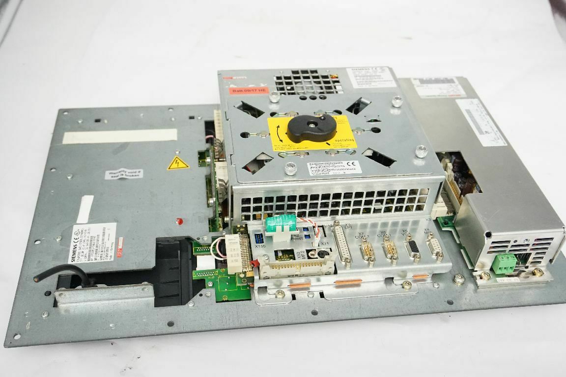

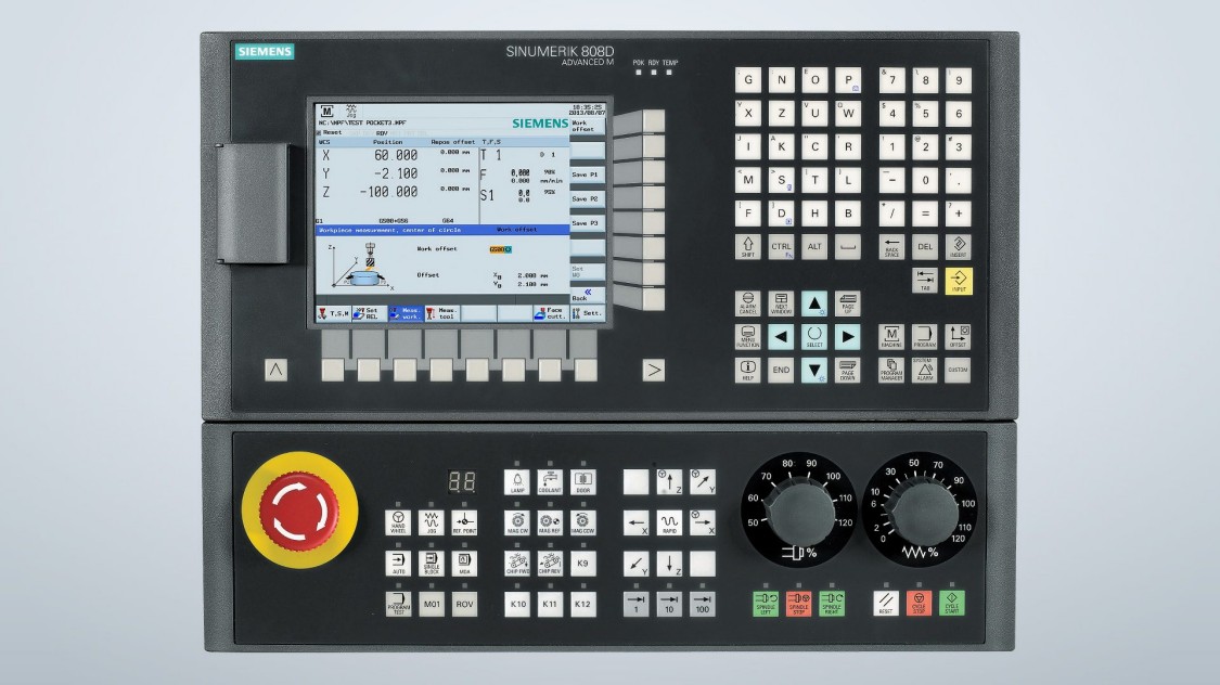

From the first time thinking of doing a retrofit on my mill, I was wondering how to design/create a nice sturdy controlpanel with all the button you need. The best design I can think of, is one of the Siemens Sinumerik control panels.
I´ve read some manual of one of those and there was a almost easy pinout of the two 40pin connectors on the backside. Could be possible to use them ?

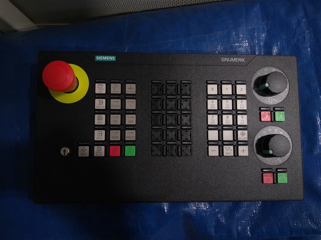

Is it a keyboard matrix?

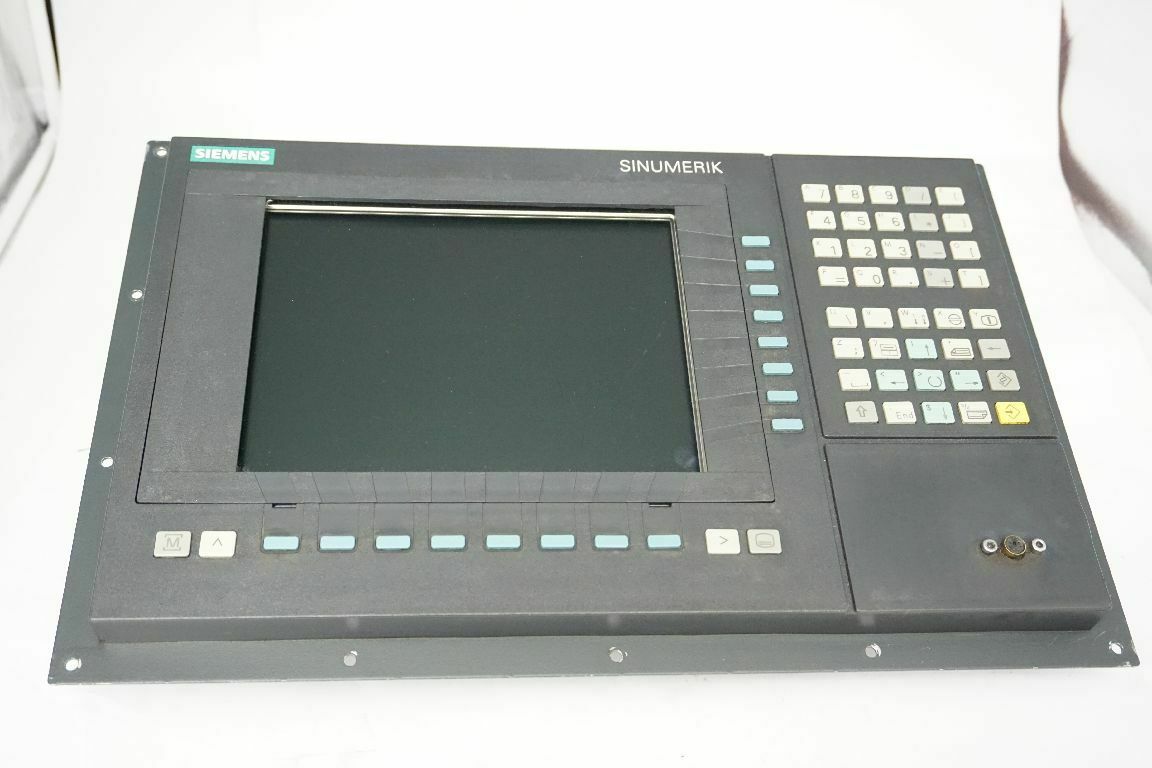

I think the small panel had even a Pinout written in it´s user manual, but i wonder if it´s so easy why no one did mention it yet. I have the feeling i´m missing something obvious.
The big panel with screen would be even cooler since you have all you need together in one package. But regarding the amount of buttons i think siemens did some magic so you just can´t salvage it that easy.
Does anyone have sinumerik panel lying around and could check ?

14 Feb 2021 22:23 #198870
by Onkelmat
Replied by Onkelmat on topic Sinumerik controlpanel with Linux CNC

They're not cheap! New at least...
I have the first one to hand if you have an easy question. It's destined for an 840D, so no plans to work out the interface.

The MCP is sat in a box with no power to it - if you have a pin out I can check for continuity across a shortlist of pins of interest (for example), but I don't have enough play time to reverse engineer it by guessing.

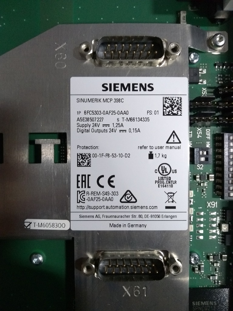

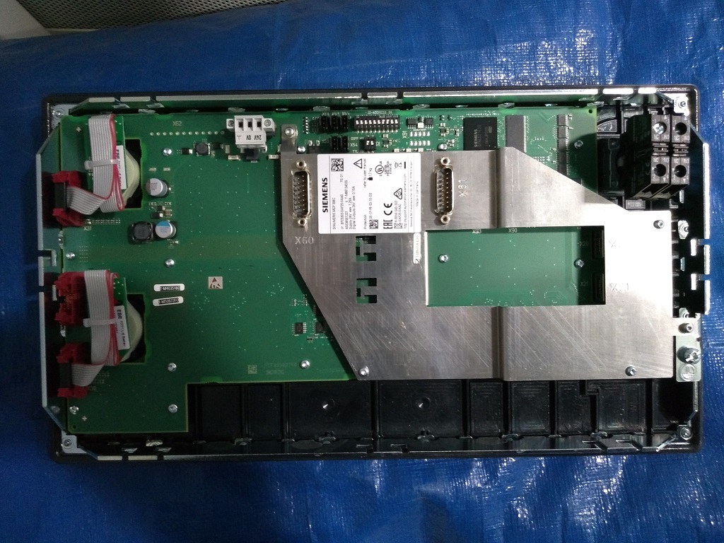

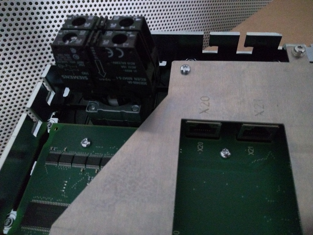

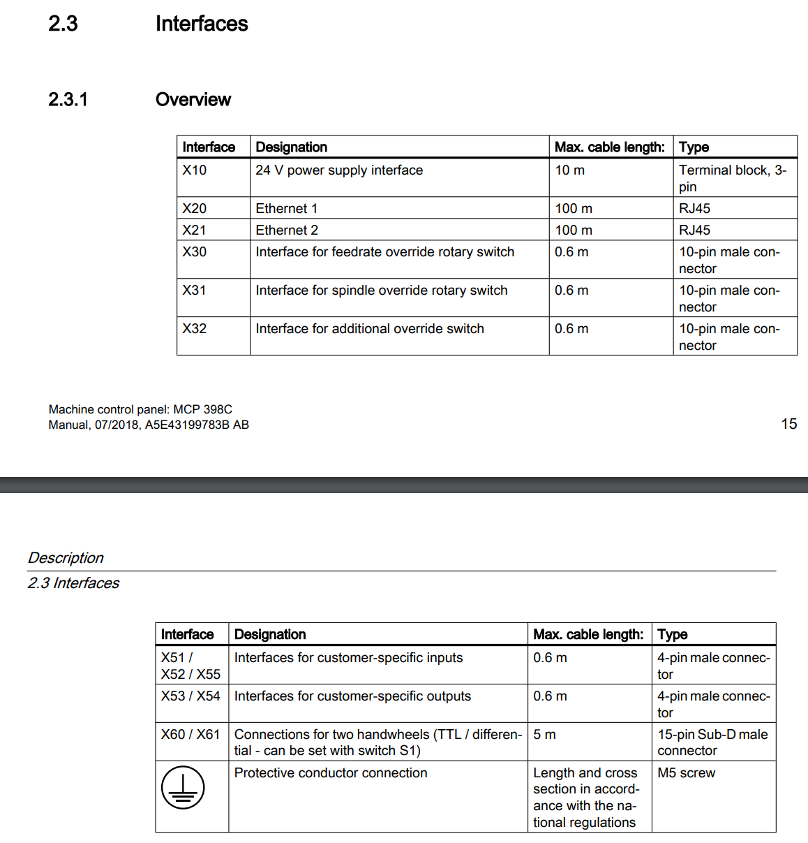

17 Feb 2021 09:27 - 17 Feb 2021 09:38 #199138
by Mud
Replied by Mud on topic Sinumerik controlpanel with Linux CNC
See attached for details of MCP 398C.
PS - would assume X20/X21 are PROFINET.

17 Feb 2021 14:30 #199157
by Onkelmat
wow that panel looks brand new !
