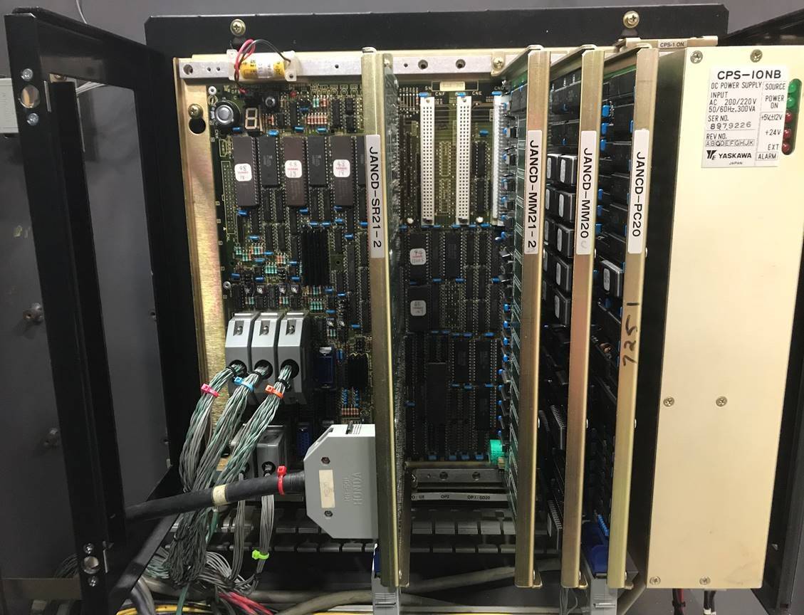

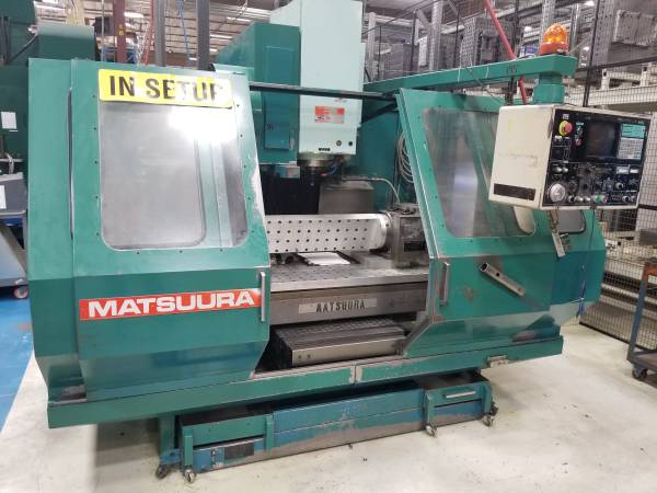

Hey all, long time reader first time poster. I have been looking for a mill that can fit in my garage and I found this little jem on cl. It's free I just pay moving whis about 2400 from my last quote. It does have a problem with the controller. The owner says it was working perfectly and it setting having problems with the controller. It also comes with the 4th axis and it appears to have a chiller for the spindle along with a 31 tool changer. Although it seems to be a slightly strange transfer random pot swing arm. Might be interesting to program.
Heres what he said in a email
Here are my notes from technicians around the time it went down:
“Machine has a 325 SERVO CPU ERROR alarm that won't clear. Looked up alarm in the manual and it states to contact your Yaskawa representative and also replace MB20. Called into Selway and left all info; awaiting a callback. Selway is still troubleshooting as of 10/21/2019.
Cable is here ready for install. 10/22/2019.”
“We managed to clear the 310 alarm by forcing a bit the servo on with parameter 1322 bit 7. Now able to move Y axis but will over travel. X axis will bomb out and same with Y axis. The 4th axis when it we try and move we get multiple alarms. Meg the 4th axis motor found the motor to be good but cable between motor and connection in side work area is bad. Will need to replace the cable. We are still chipping away at the other alarms that will appear for others. For now we are going one alarm at a time to figure out everything that is wrong with this machine.”
“Worked with Robby to figure out issue with machine. Swapped power supplies and still keep getting alarm 310. Swapped mm20 board and got the 310 alarm and 322 alarm now. Still working out what is causing this issue.”
Issue immediately prior: “PC CPU Error cant clear, Machine down, James/Vendor cleared 329 alarm. Probly caused by bad communations cable, chip in board, or bad machine ground.”
We believed that the issue may have been corrected by replacing this part:
YAI Part #: NCX3320
Description: JANCD-MM20/ DTN-4790/X3 MEMORY BOARD
We did not have conclusive evidence that this would solve the problem, and the Yaskawa tech support recommended coming out and swapping boards until the problem was resolved to troubleshoot the issue (meaning they weren’t sure either). The faulty axis cables were replaced.
So I'm wondering if you experienced people think this would be a good candidate for a linux cnc update? What would I expect the servos and spindle to use for controllers? How would I operate the two speed gearbox? Any thing in should know that I'm not asking?
I do have experience operating okuma and haas mills. And experience building and heavy modifications to 3d printers aswell as arduino and other micro controllers(I know this would be way more advanced) ]
Thanks for the input.

I known othing about this machine, but industrial CNC machines are very modular, so don't do anything radical like ripping everything out of the control cabinet and starting from scratch.
Do you have a complete set of wiring diagrams? That is essential.
Put some effort into getting it running under its original control. That effort (even if it fails) will help you understand the systems. If you can get it running, but decide to retrofit, it is easier, as you wont have unknown failures in the systems you want to keep.
Every machine is a good candidate fro LinuxCNC, as it is so flexible.

How urgeant is this project? Necessary machine for your company? --> Pay for service. Hobby machine which you would like to get working in the next year? Get the wiring diagram and get started
You can start with the assumption that there is only a a couple of errors in the machine. If there is a known bad controller card and it is expensive to repair or replace it, that is the same starting point I had. I lobotomised my machine of it's defective Phillips controller, as it would have been too expensive to trouble shoot, and was not 3D capable. If you have the wiring diagrams, you can easier interface your replacement LinuxCNC + Mesa card brain into the existing I/O, drives, and sensors. You will probably encounter a couple of additional hick ups along the way as well, but the schematics are the essential basis for troubleshooting.

Your questions are currently too general for us to provide much help.So I'm wondering if you experienced people think this would be a good candidate for a linux cnc update?
Take photos of the motors, drives and there data plates. Hopefully one of the standard interfaces. Step/Dir, +/-10VDC Analog, CW/CCW etc.What would I expect the servos and spindle to use for controllers?
I would not worry about the gearbox control at this point. There are number of different approaches to this in LinuxCNC or ladder, so it can be solved, but is not urgeant for your project t this point. Once you get that point, you will be able to formulate the right questions."How would I operate the two speed gearbox?"
How long is a peice of string?Any thing in should know that I'm not asking?
Ask the owner. From the description, there has been significant trouble shooting done, so I assume someone at that place has the manuals and schematics. If not, contact the manufacturer. That is what I did. If you have to pay for them, it is worth it. They normally have a good archive of all the machines and their "as delivered" configuration. The wiring diagrams are more important than any other manuals. I would consider it essential to attempting this job to have them.Where would the manuals be kept? Any idea where I could find them of they aren't with the machine?
