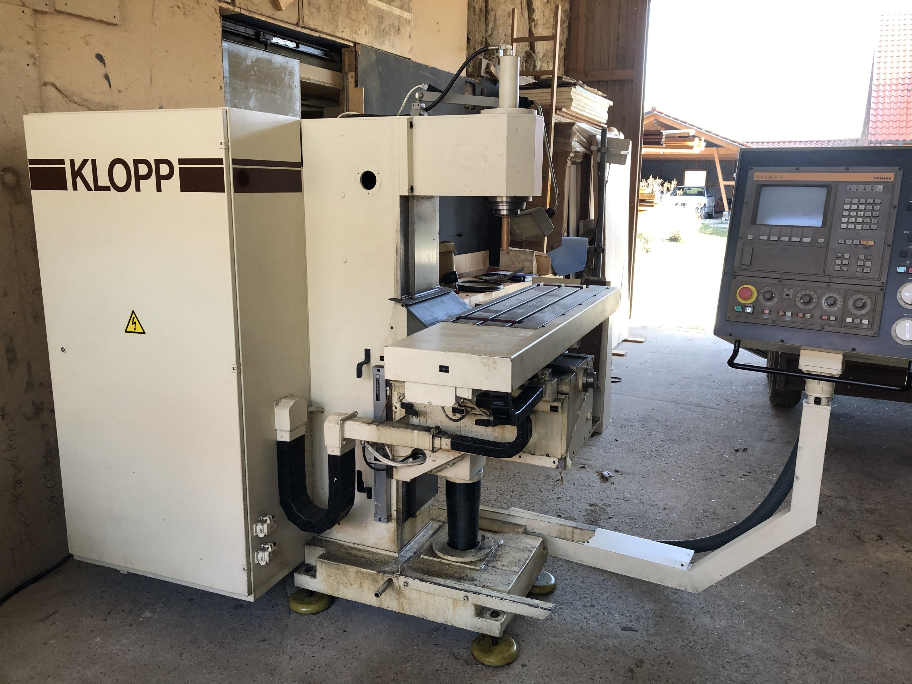

Hello guys,
recently I got a "Klopp FA7/810M" CNC mill in a very good condition for an absolute bargain.
The "only" problem is that the Sinumerik 810M has lost all it's data, there is no backup data and it won't start anymore.
So my only solution is retrofitting. I'm very new to all of this, so forgive my mistakes or dumb questions.

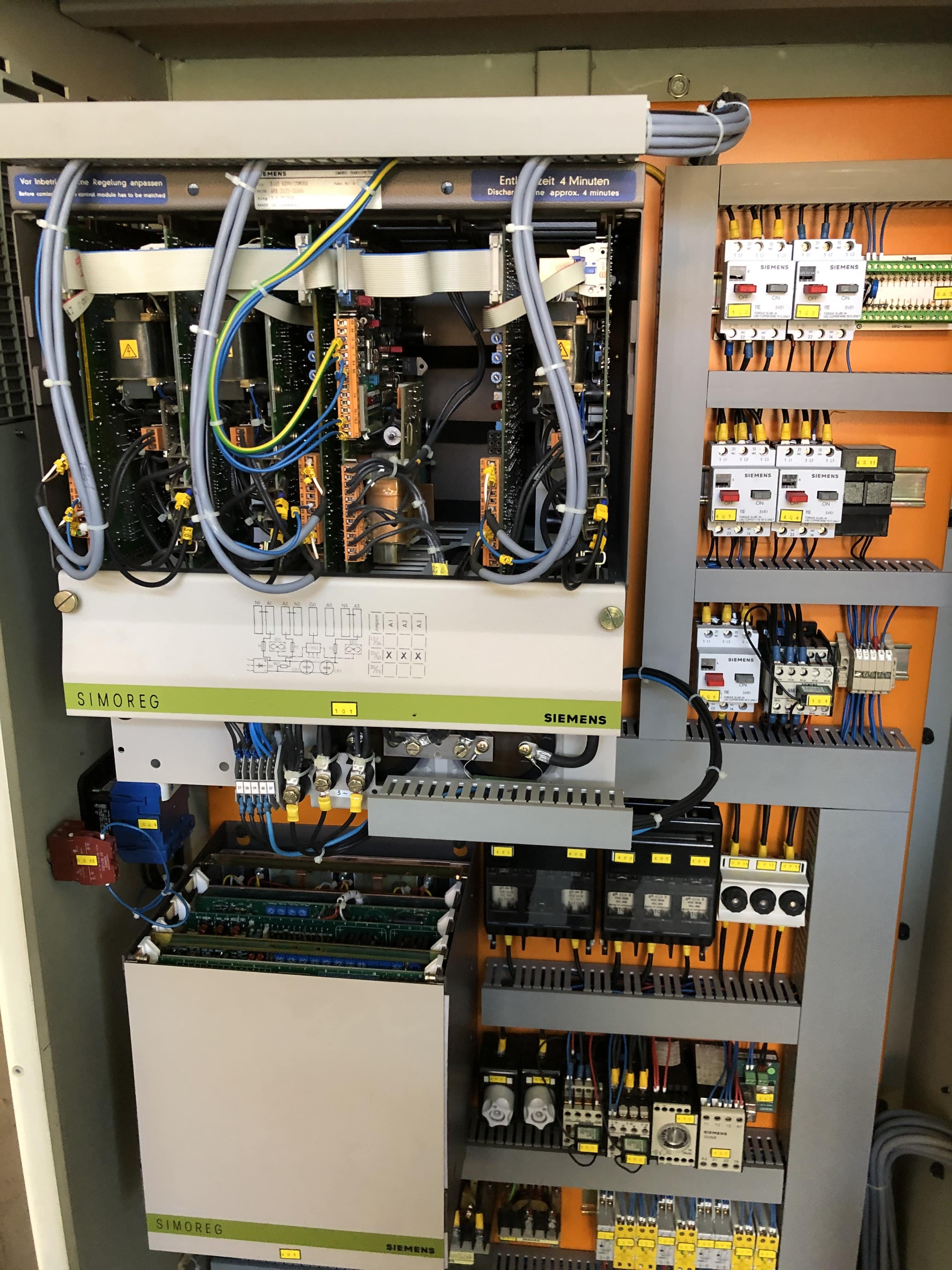

The machine uses a Sinumerik 810M controller, a Simoreg D165 G200/25MREQ Transistorsteller for the feed motors,
a Siemens 6RA26 for the spindle, LS703 Heidenhain glass scales and 24V relais/contactors.
As said, I'm very new to this so I have a few questions:
1. If I understood correctly, I need a Mesa card for outputting +-10V for the feed and spindle motors, an analog
to digital converter for the glass scales, a card for the scales, an IO card for the relais to control things
like the coolant pump and a "main" card with an FPGA chip. Also an "old" computer to control all of this.
Have I forgotten something or is this correct?
2. How do I choose fitting cards? They all seem pretty similar, is there some kind of a comparison table?
Do you have any recommendations for cards?
I do have the full documentation, so thats not a problem.
Thanks in advance for your help!
Greetings Tim

Do you have wiring diagrams and manuals for the drivers. That is essential.
I used a 5i25 to connect to the PCs PCI slot, and then a 7i77 to connect to a amalog drives and encoders and added ad 7i84 as I needed more I/O due to complex gearbox.
Today I would use the 7i97 as it saves the 5i25, and is easier to cable up needing only a CAT6 cable to the PC. Add a 7i84 for addition I/O, a 7i73 to integrate the control module back with a single CAT6 cable, and a 7i74 to connect the last two to the 7i97.

Yes I have all the wiring and manuals for the drivers, the documentation really is very good.
I've decided for the 7i97 as you both suggested, in addition with the 7i73 and 7i74. I think I can get away without a 7i84, but adding one afterwards should be fairly easy if I need more.

09 Mar 2021 10:27 #201560 by klopp
Replied by klopp on topic Klopp FA7/810M Retrofit
Okay, I'm almost at the end of my nerves...
Initially I installed the LinuxCNC ISO - everything was perfect, Jitter below 15000, no errors. Then I found out that I need to build LinuxCNC from source, as I'm using a 7i97 which doesn't seems supported yet. And then the nightmares began:
For the last 3 days I tried to install a Linux with a realtime kernel. Tried at least 4 different Linux versions, different tutorials, different realtime kernels, only to get an error when booting with a new kernel.
Today I finally managed to install and run Linux Lubuntu with a RT kernel.
Installed LinuxCNC, ran the Latency test - Jitter at around 8 million ns.
I have no clue why, can't be the hardware because with the LinuxCNC ISO I get perfect results.
Do you have any suggestions on how to fix that or how to install patches for 7i97 on the LinuxCNC ISO?
