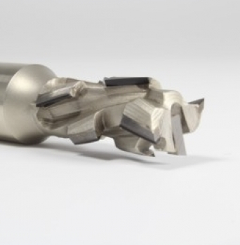

Straight flutes can be handy to cut materials that are veneered or laminated on both sides. Laminated or veneered sufaces can be cut very cleanly if the cutting edge enters the material at an angle and cuts from the surface towards the middle of the material as not to lift the top layer off the core ie. a but with a left hand flute. If the cut goes all the way through then a straight flute is a compromise since the left hand flute might cause bad cut quality on the underside of the cut.
Note that there are even V-fluted mill bits, left hand flutes on the shaft side and right hand flutes on the other end.
Single fluted bits are often used for thermoplastic materials to reduce heat while cutting as you have noticed.

Most tools used in machining metals have right hand flutes so the chips are extracted. For other, mostly non metallic materials, straight or even left hand flutes might be preferable.for what to use the straight double flutes bits?
Mill bit with positive and negative angled cut
