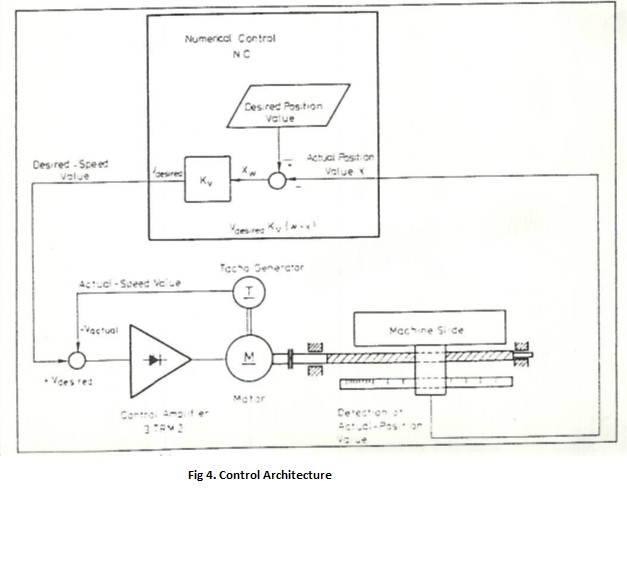

On further investigation, it appears that there aren't actually any resolvers on this machine. The servo motors have Tach generators that are fed back into the servo Amps, but the dynapath was reading the glass scales for positional feedback. On one hand, that seems like a good deal as you can elminate backlash from the system, but on the other hand, maybe not such a great idea? Should I be planning to mount encoders to the servos?
22 Mar 2021 13:00 - 22 Mar 2021 13:03 #203272 by RotarySMP
Replied by RotarySMP on topic Wotan Rapid 1 LinuxCNC Retrofit
If the amps and motors work, that is the same starting point I had on my MAHO. All you need to do is connect each axis's two wires for +/-10V analog speed control from the 7i77 to the amp, and feed the linear encoder back to the 7i77. The amp closes the velocity loop and LinuxCNC closes the position loop.
Here is the block diagram from my Indramat manual...
Mark

Simple.... I like it. It must be a german machine thing then, (not having rotary encoders on the motors).
22 Mar 2021 14:10 #203282 by andypugh
Replied by andypugh on topic Wotan Rapid 1 LinuxCNC Retrofit
If you are keeping the drives then just leave the tachos closing the velocity loop and let LinuxCNC use the scales to close the position loop.
This is about as simple as a LinuxCNC servo retrofit gets, and should give excellent results.
