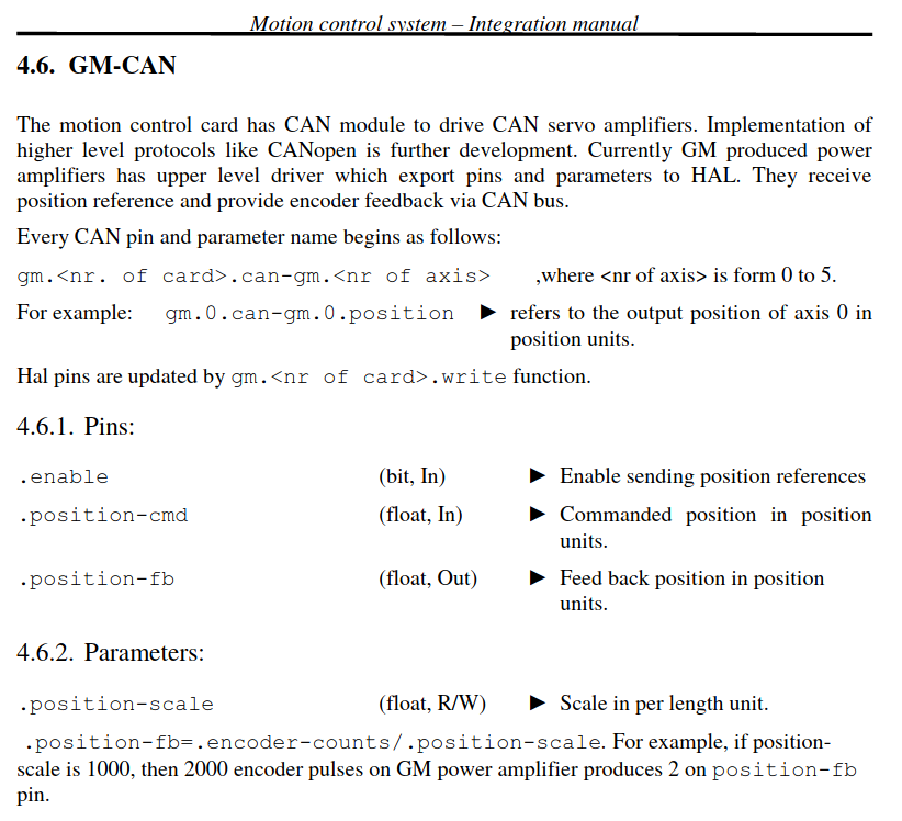

- Posts: 19908
- Thank you received: 4657
27 Mar 2021 16:28 #203835
I have a feeling that the General Mechatronics interfaces might:
www.generalmechatronics.com/linuxcnc.html
Shows a servo drive linked by CAN.
Replied by andypugh on topic Retrofit Datron drives (CAN interface)...
LCNC does not support CAN.
