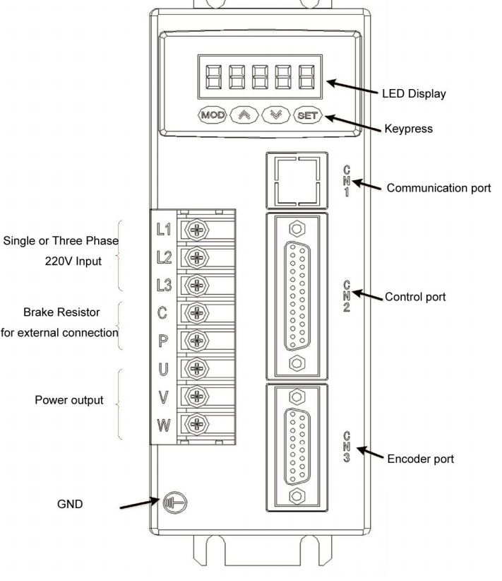

I managed to set up a LuxMill Milling machine now with LinuxCNC. Each Axis is driven by a servo Motor, so is the spindle. It's this kind of China AC Servo motors with an AASD series servo drive controller. So far I got everything working except one puzzling bit.
On the 1,8kW servo spindel motor I defined a speed ramp of about 3s to ramp up and down.
However, when I us M5 to stop the spindle then it initially ramps down properly and then at low speeds it sort of jams the brake in and stops very abruptly. Since I am not using an external braking resistor I am afraid that it will throw up an error once I use some tools with more inertia.

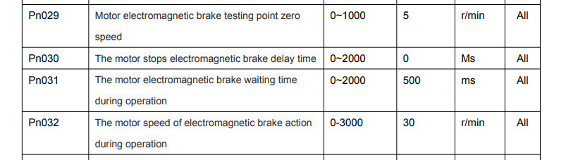

Normally the brake should only switch when the enable signal to the amplifier switches off. This is a backup for hanging axes. Where did you get the servo-on signal from? Is it permanently on or only when you give speed?
Second possibility, change parameters PN029 and PN032 -> 0.
A third idea would be to switch the brake with a relay connected to the machine enable signal.
