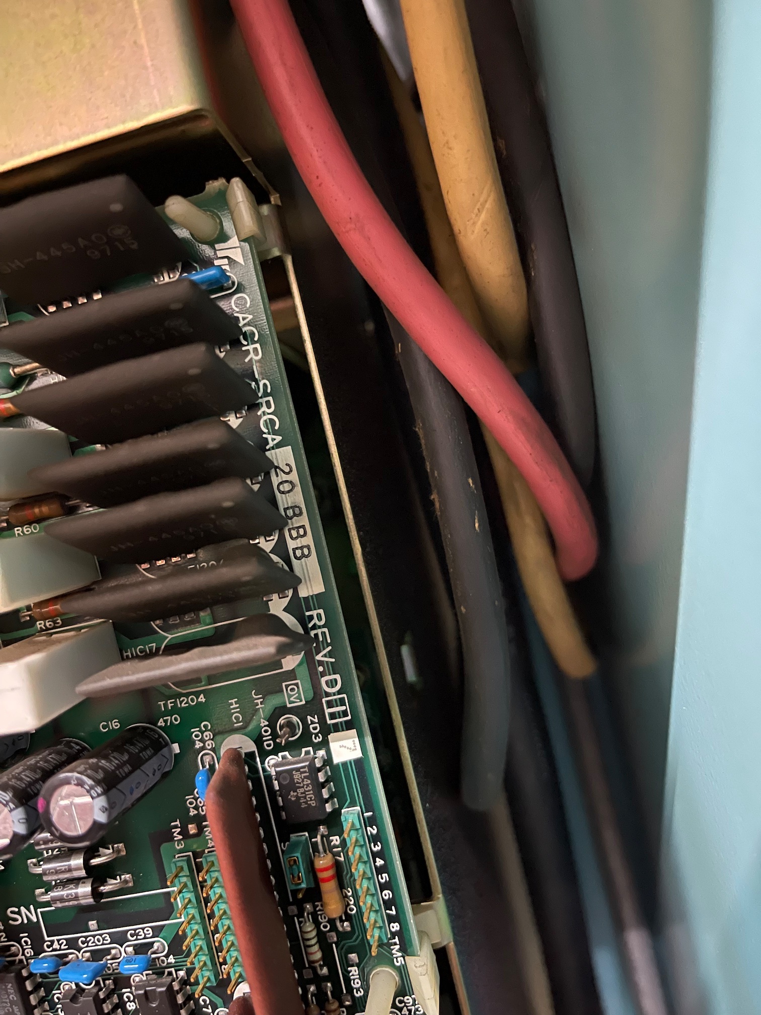

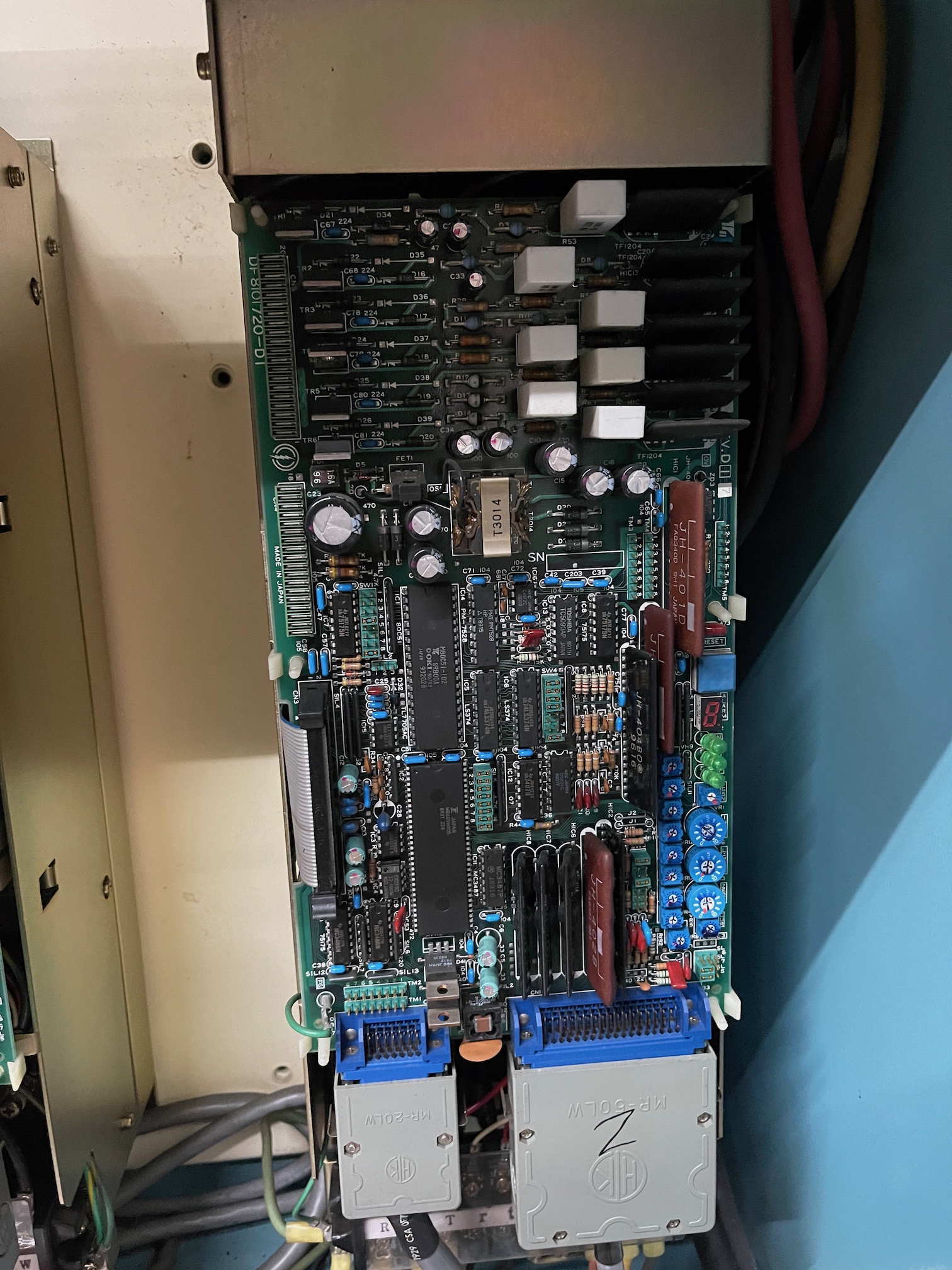

I'm retrofitting a Hurco BMC40 as its 486pc based control based on crazy proprietary boards & OS finally died.
I'd appreciate any advice related to hardware for the retrofit.
From my initial research it looks like this has analog drives. (Yaskawa cacr-srca 20bbb? Pic attached)
The spindle drive is a Yaskawa CIMR-MTIII-11K.
If anybody is familiar with these drives I'd love to verify that part number and if its analog +-10 or step/dir. I *think* I found the manual for it but not 100% sure.
Initially I'll just be getting it back up and running with basic 3 axis + tool changer but I do plan on adding a A & C axis trunnion table and seeing if I can get it rigid tapping.
