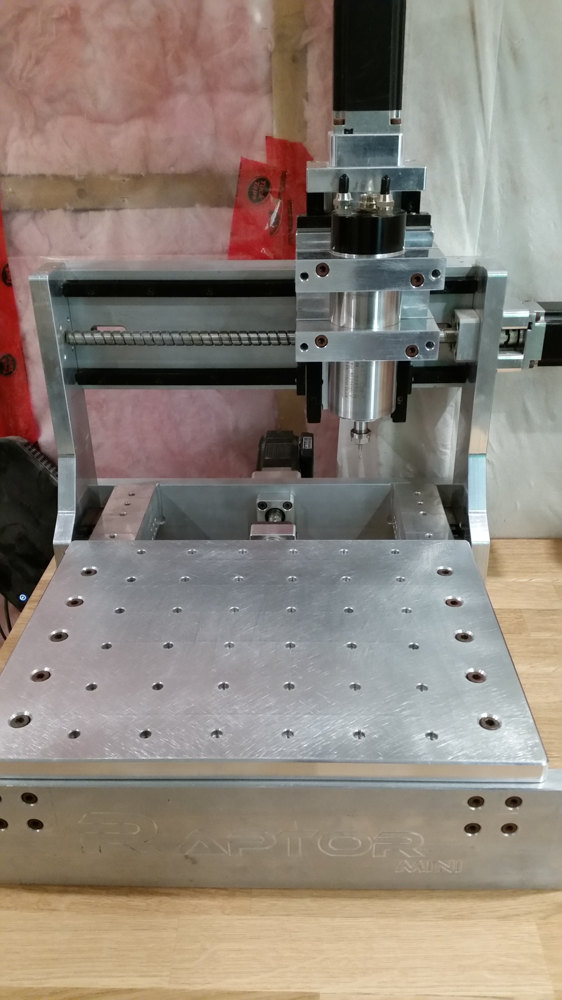

Sooo, I got me some cheap servos (jmc ihsv57) and a cheap control (ddcs v3.1) and after mucking around, not really pleased. The control doesn't do constant velocity and is limited in other ways, and the servos don't tune well for a high acceleration machine with no jerk control (1000 line encoders and very basic pid settings).
So, back to linuxcnc I think. My mesa 7i76 card got drowned in a flood and I don't trust it.
What's should I be buying as a replacement. I see the 7i76e ethernet version, the 7i96 with less IO, and then the 7i95, which has encoder input. Is there a reason to choose one over the other besides the obvious IO/encoder differences?
