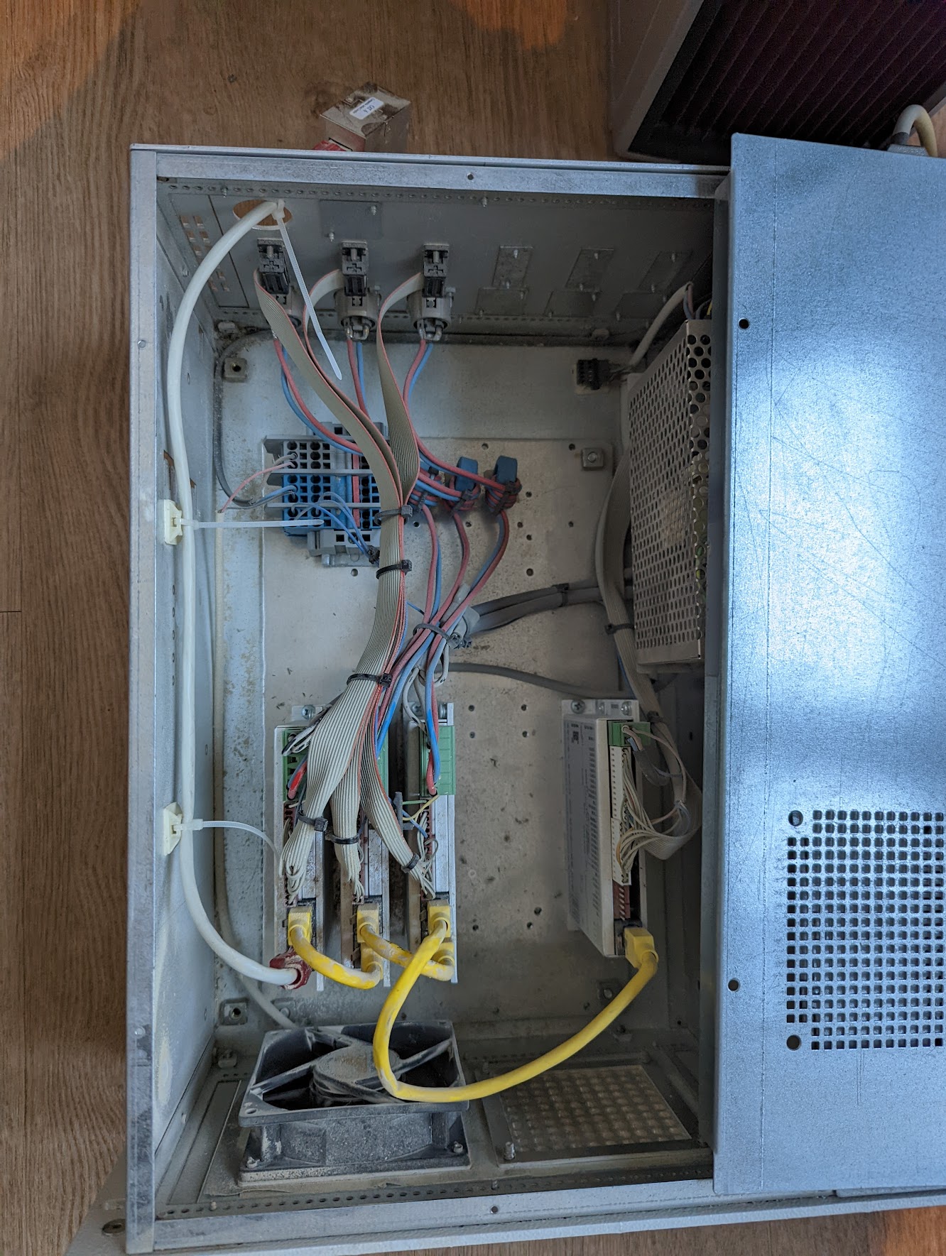

07 Feb 2022 11:28 - 07 Feb 2022 11:33 #234238 by knipknap
Replied by knipknap on topic Changing an Isel FB2 to LinuxCNC?
Thanks again for the helpful explanations! The firmware part is making me shy away a bit, this project appears to become more complex with all that.
I am wondering though if a mesa card is even needed, because the machine is currently communicating via a single RS-485 connection.
The LS-173 drivers are all "chained" to allow communication to all of them via a single (shared) RS-485 port, see the attached photo. The machine also has a LS-785 IO card, which is also chained with the LS-173 drivers in the same manner, for IO ports and spindle control.
So if I understand this correctly, I would only need a way to communicate over a single RS-485 UART port from LinuxCNC. Doesn't that simplify things to the point that I don't need any additional hardware? I guess I could program the Raspberry IO pins for RS-485, or to avoid latency issues perhaps use a simpler RS-485 hat, if LinuxCNC has support for that?
Of course I would still need a driver, but at least the hardware part should be simpler, I guess.

07 Feb 2022 18:58 - 07 Feb 2022 19:08 #234272 by andypugh
Replied by andypugh on topic Changing an Isel FB2 to LinuxCNC?
Maybe so. If your PC has an onboard RS-485 port (and some do[1]) then it would be very easy. Alternatively RS-232 to RS-485 converters are cheap enough.
There is a driver for onboard serial ports. It only drives the status lines, but might be a very good starting point.
Docs: linuxcnc.org/docs/2.8/html/man/man9/serport.9.html
Code: github.com/LinuxCNC/linuxcnc/blob/master...drivers/serport.comp
Basically, if you have the port address then you just need to use rtapI_inb() and rtapi_outb() commands to write straight to the port.
[1] For example www.mini-itx.com/~JNF797-Q370 is claimed to have 2x RS232/422/485 ports. (Not sure how that works...) . (edited the board, found one with that runs of simple DC power without a separate PSU. There are others with CPU soldered-in which might be cheaper and easier, but I didn't find one with DC input, RS485 _and_ included CPU)
