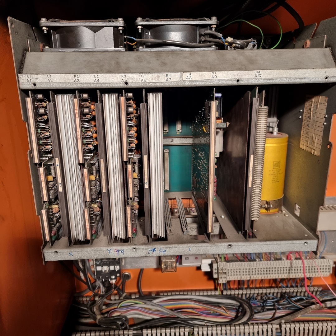

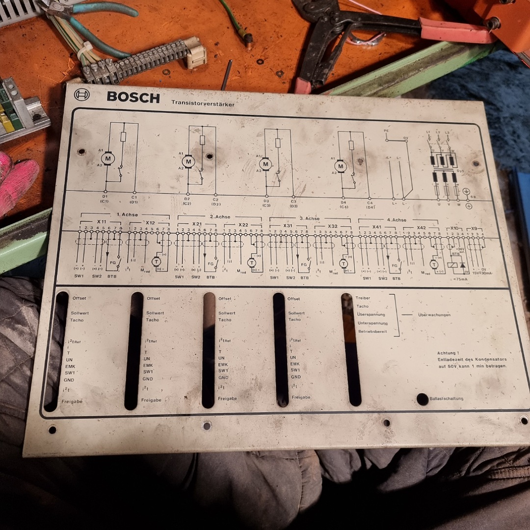

Possibility of using Bosch DC servodriver

06 Feb 2022 18:19 - 08 Feb 2022 17:39 #234204
by chochanghyun
Possibility of using Bosch DC servodriver was created by chochanghyun
Last edit: 08 Feb 2022 17:39 by chochanghyun.

Replied by tommylight on topic Possibility of using Boss DC servodriver
Do you have any schematics for it?
If the drives are analog +-10V, as most are, then yes they can be used with addition of Mesa 7i97 OR Mesa 7i92/5i25/6i25 with 7i77. Those are basically 2 versions of the same thing.
Finding out the wiring takes a lot of time and knowledge, so having schematics helps a lot.

Replied by Henk on topic Possibility of using Boss DC servodriver
You can use that drive with linuxcnc. It is a standard velocity mode DC drive with analog command and tacho feedback
we are running one in our Deckel FP5.

07 Feb 2022 00:07 #234225
by chochanghyun
Replied by chochanghyun on topic Possibility of using Boss DC servodriver
Oh, good news. But I have to make sure that the Bosch Servo is fully operational first. Is there a good way to check?
