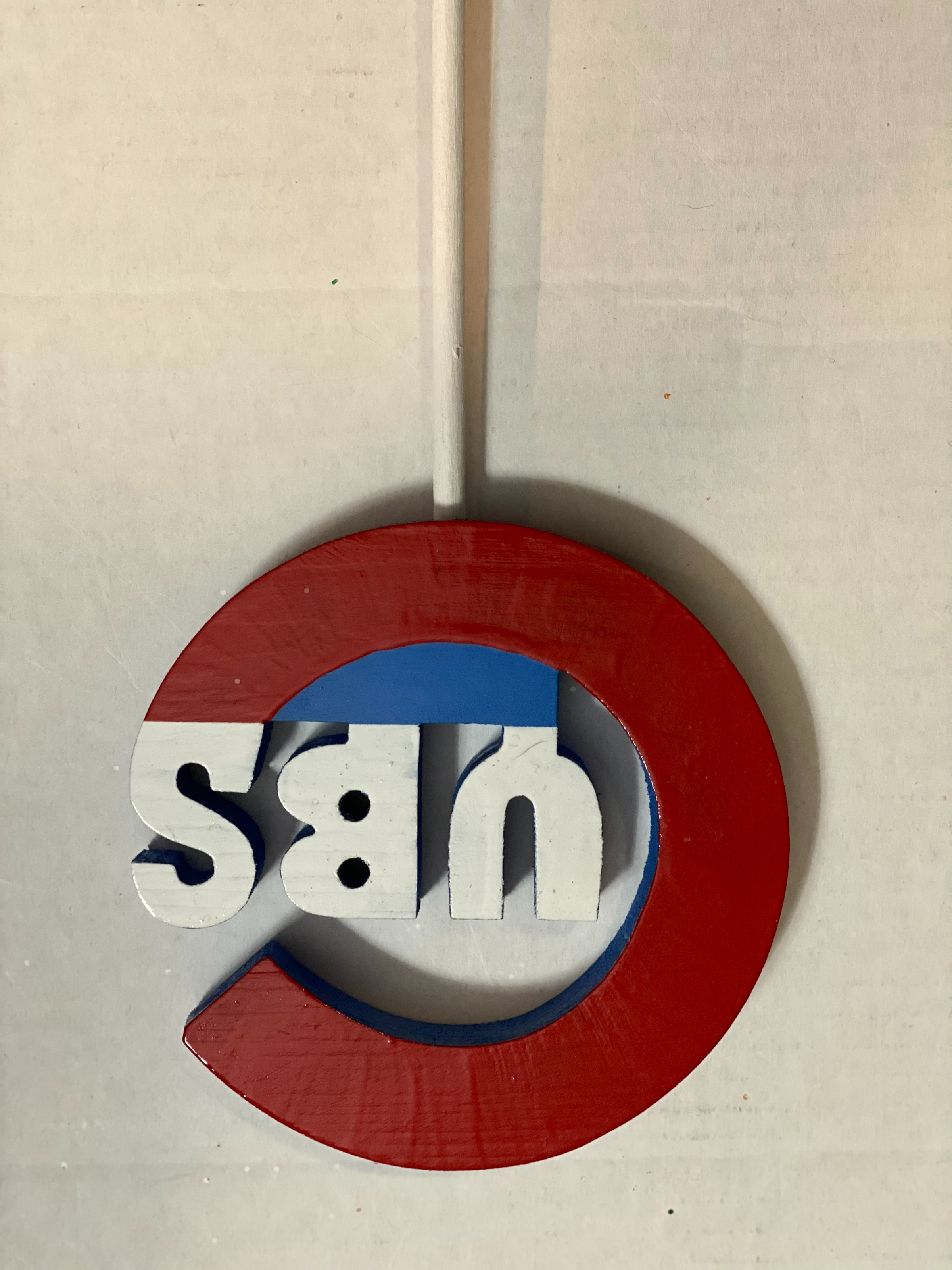

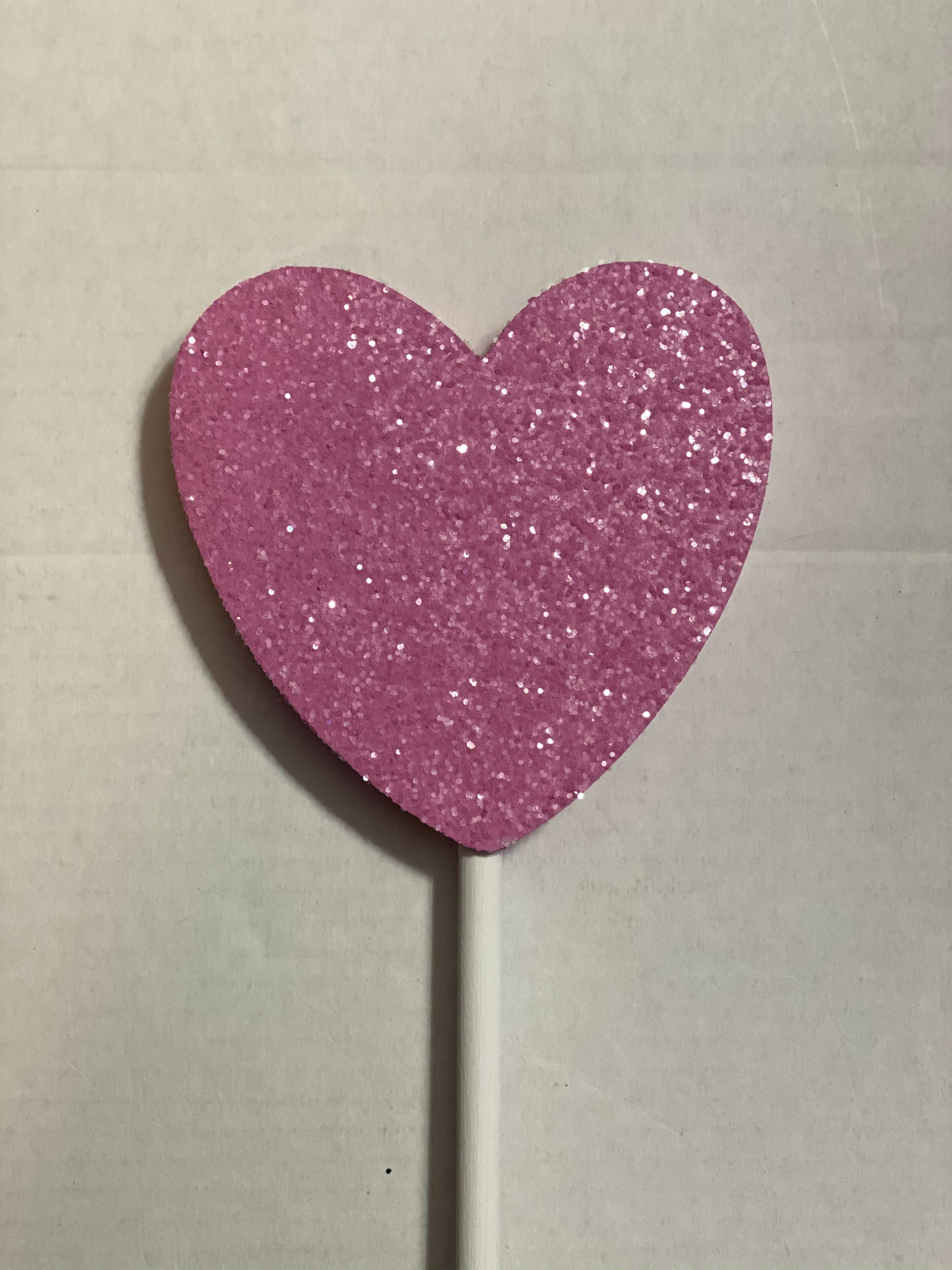

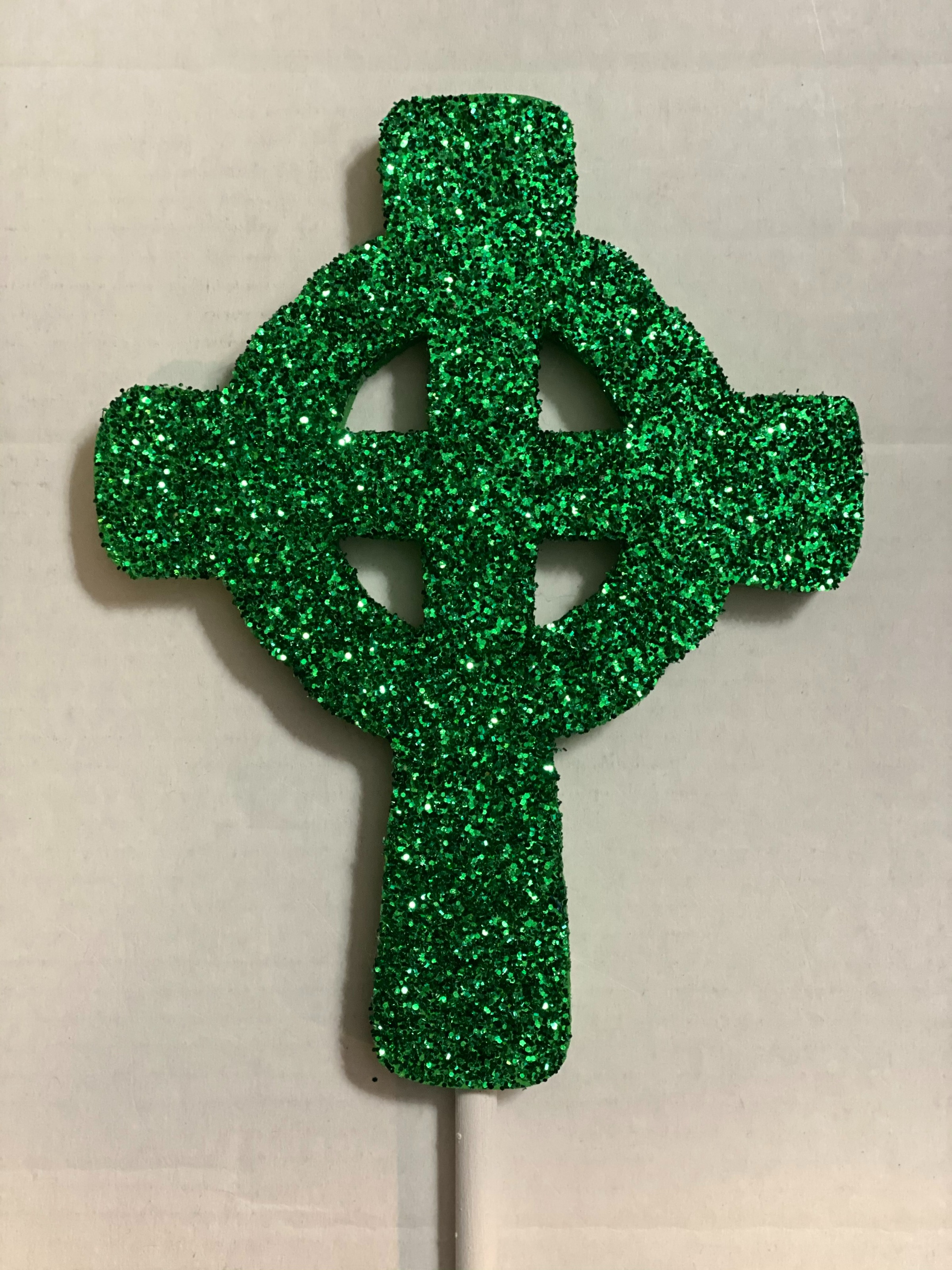

Hello, I am new to this forum as I am starting a woodworking craft that is taking off and I need help with a CNC recommendation. I cut (Thickness) 3/4" pine designs with a max width of 18”/length 25". I have done some research regarding CNC's but not sure if they are suitable for cutting ¾” pine designs. Can you please look at the 3 machine below and let me know if one is better cutting out my designs, or suggestions? I will mostly use this for CNC 2D Cutting. Any suggestions/recommendations would be great! I would like to keep my budget round 3k. See my attached pictures.

Firstly, looking at your samples, none of the CNCs shown can make them, as they all have sharp internal corners that can not be made with a rotating tool.

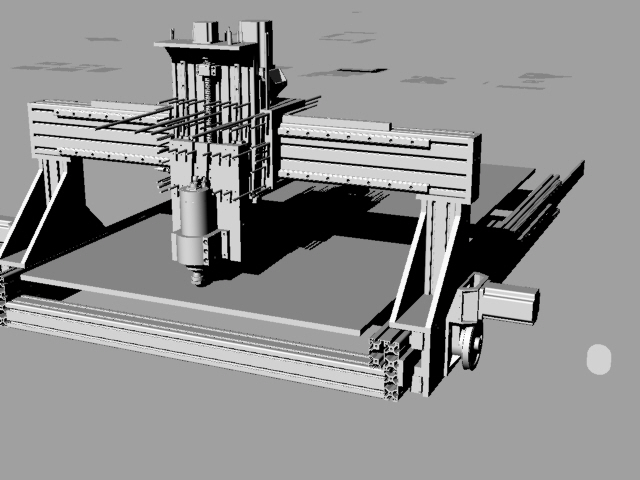

Only an idea. All those routers seem, I don't know, "thin" (english is not my first language), I'm building one with several different aluminum profiles, sheets, etc. But mine is for a router, for your designs I think a laser will do OK.

I attach a work in progress of my design just for fun.
