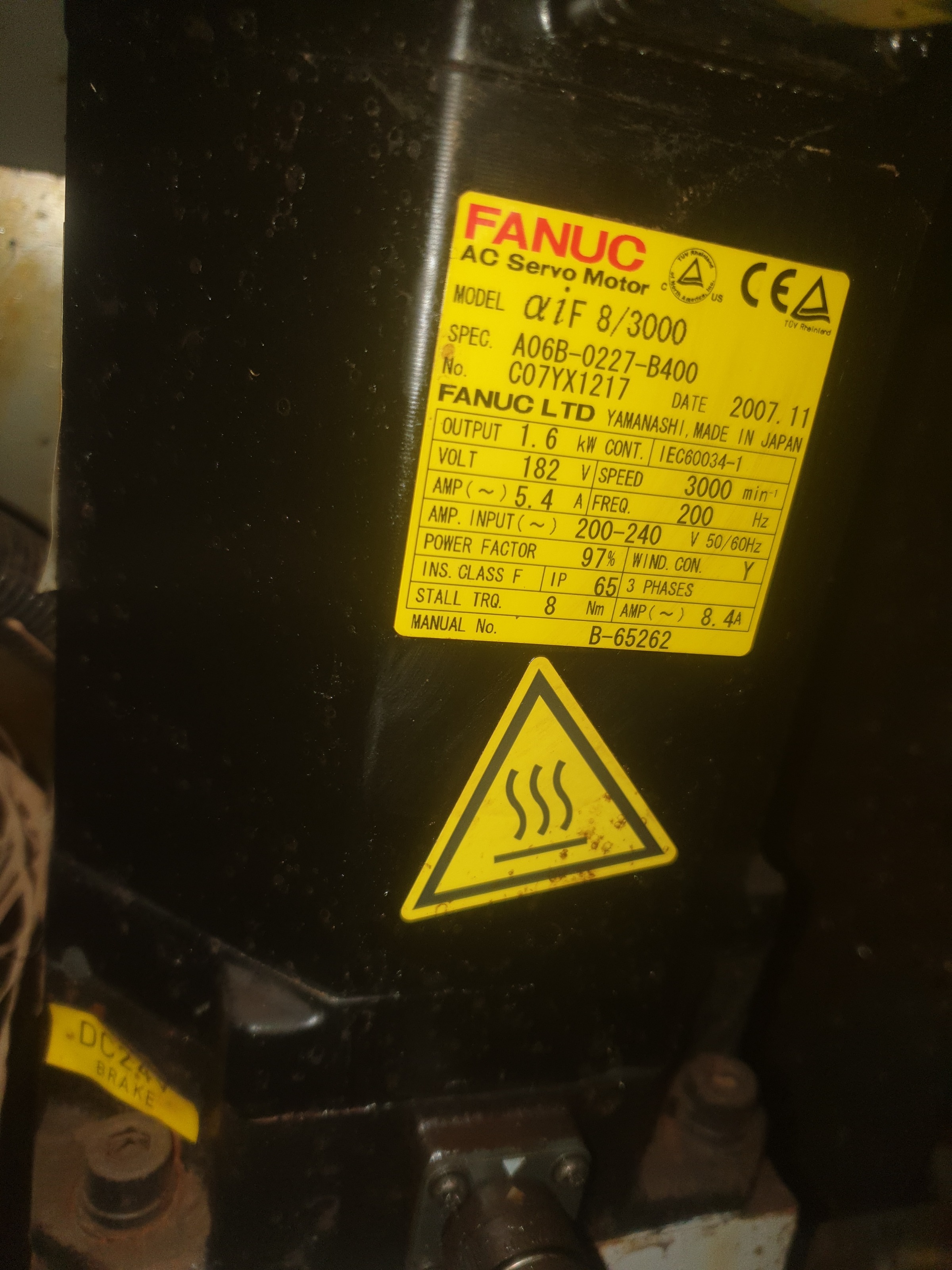

Starting on a flood victim retrofit. Just got a shenzing??
8" chuck with tailstock etc (2007). It was 4m under water. Looking at salvaging what we can. The servo motors and spindle motor etc.im not to interested in saving most of the control stuff and will swap most things for mesa. More pictures and progress to follow.

Replied by andypugh on topic Flood victim retrofit.
I would expect the motors to be fine, they are well sealed.
Even if they got water in them, not much silt would have got in.
You might as well clean off the control stuff and see if it immediately goes "pop" then see what you have left at the end.

27 Jul 2022 07:20 #248414
by M4MazakUser
Replied by M4MazakUser on topic Flood victim retrofit.
Hey, you are correct about the motors, dry and free to turn, amazing for being under 4m of water for 2 days!
What sort of daughter card (mesa) should the encoders be connected to, they are absolute type fanuc ones. So should be able to use the bldc component, pity about the wait on the mesa drives.

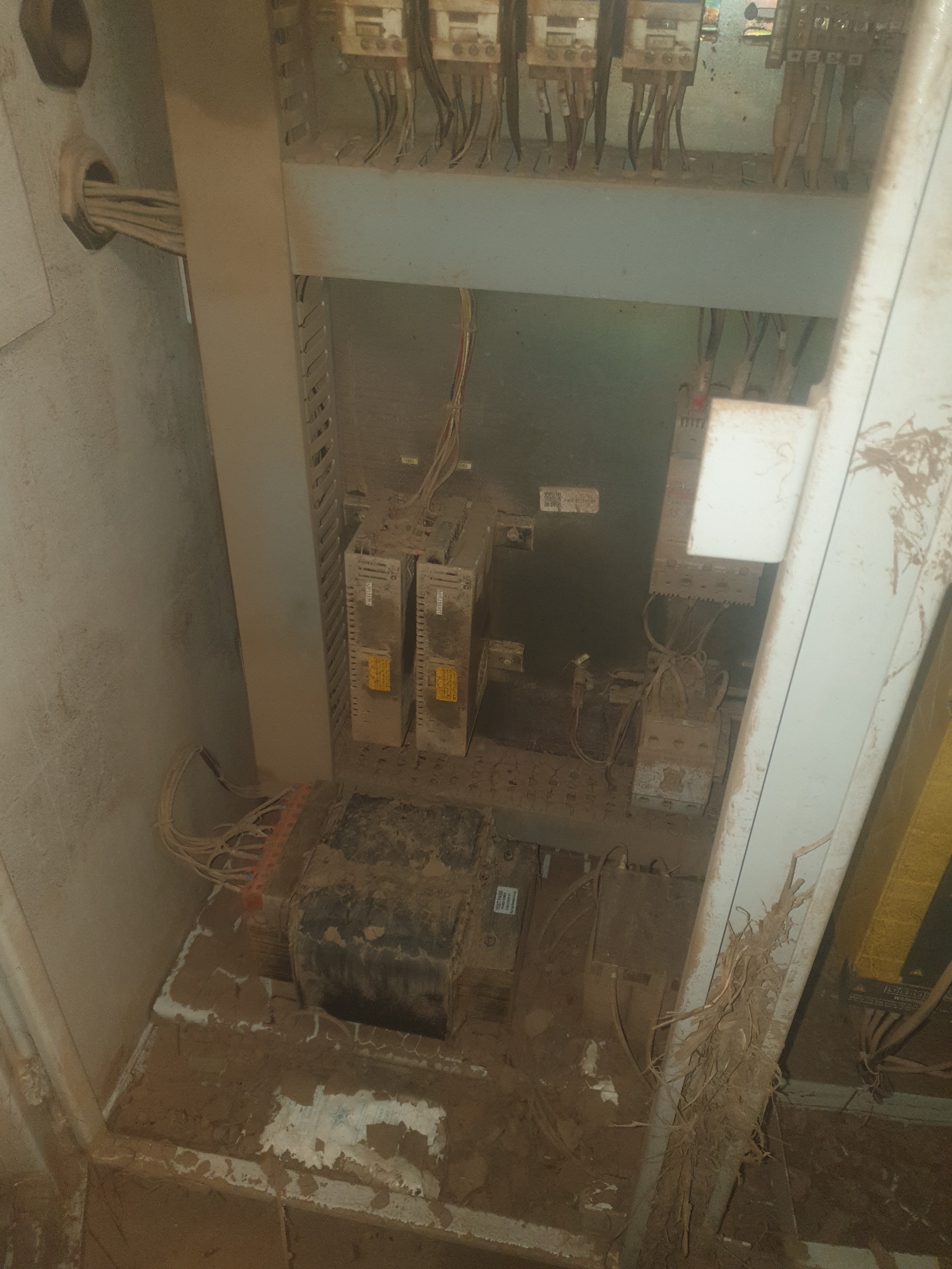

Have ordered several mesa boards, looks like a long wait on mesa servo drive boards... anyone have success interfacing in to a fanuc keypad? It has 2x 50 pin headers and a 25pin female serial plug. I'll pinout it soon.
I've started stripping out the electrical cabinet. Its all covered in fine clay. The 220v transformer looks good now after hosing off and sitting in front of a 3phase 15a heater for 3 days... took ages to get it hot!
looking at changing both screw thrust bearings, but trying to save the ball nuts.
