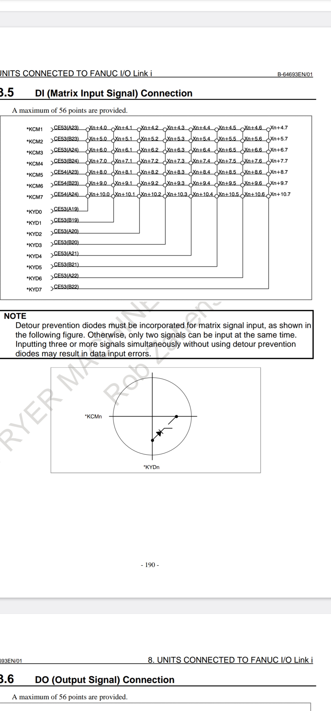

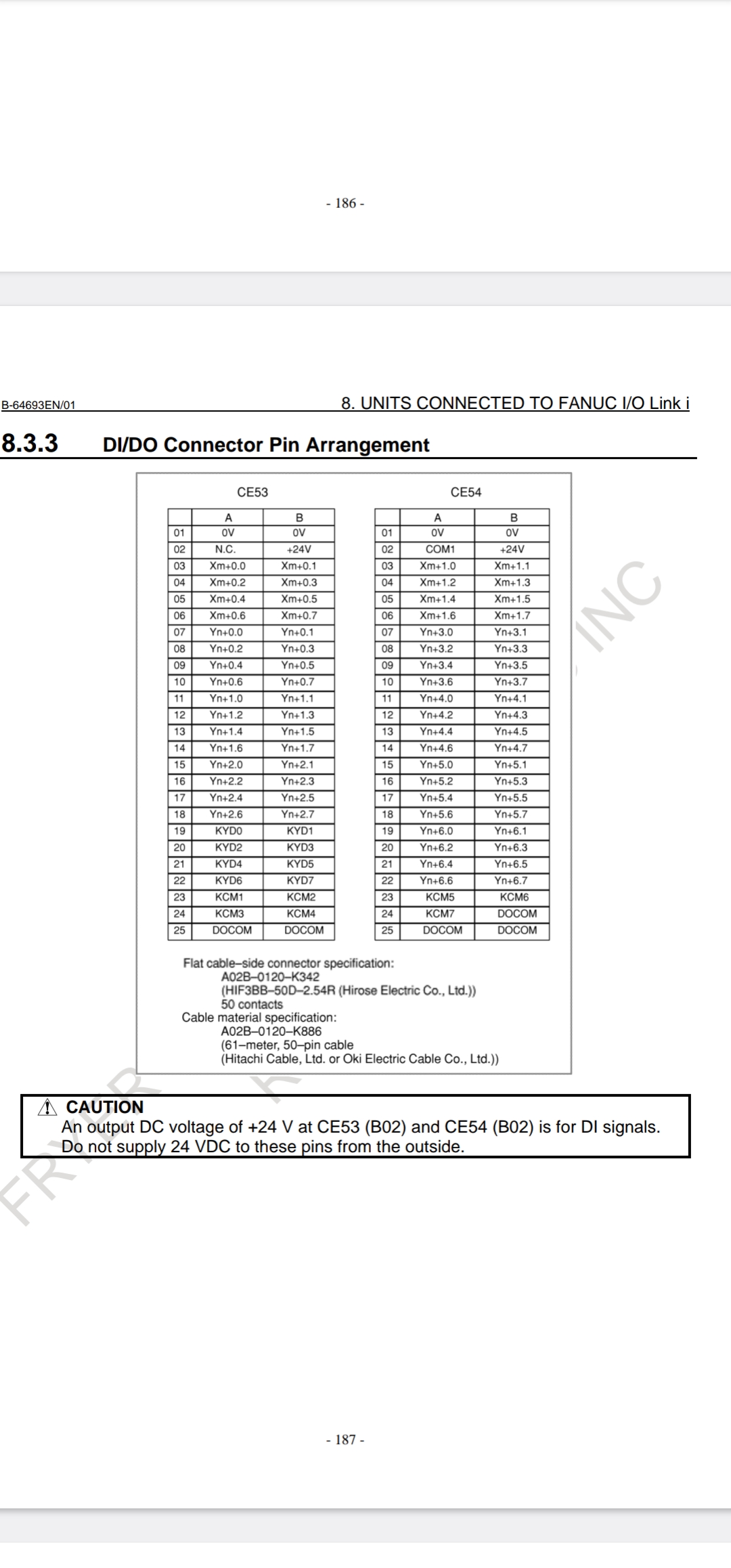

If you are lucky the headers connect directly into the key matrix.Have ordered several mesa boards, looks like a long wait on mesa servo drive boards... anyone have success interfacing in to a fanuc keypad? It has 2x 50 pin headers and a 25pin female serial plug. I'll pinout it soon.
04 Aug 2022 12:14 #249028
Replied by andypugh on topic Flood victim retrofit.
Though it is possible that the serial data might be usable, depending on what it looks like.

by M4MazakUser
Replied by M4MazakUser on topic Flood victim retrofit.
Found this info today, explains what the pinout for fanuc keypads is.
hope this helps someone else!
