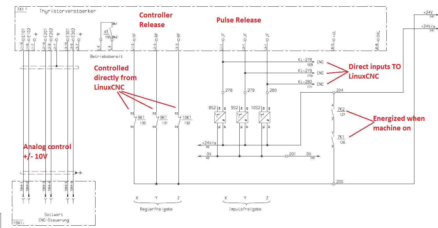

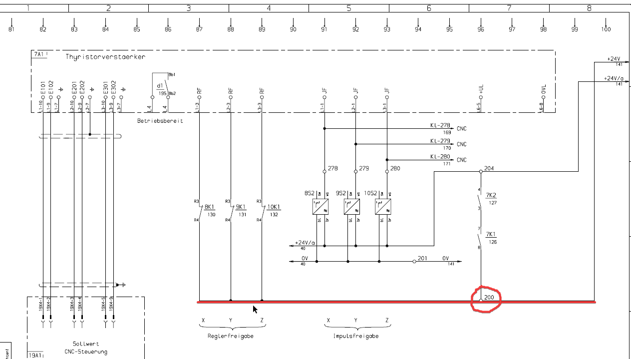

The screenshot I am attaching is from the MAHO electrical schematics, and shows the INDRAMAT servo amplifier and the inputs that relate to the hand feeding feature. The 8K1, 9K1, 10K1 are directly driven by the controller (LinuxCNC outputs). The 8S2, 9S2, 10S2 which I don't know how to name, are the switches that are activated when you pull out (for about 3-4mm) each of the hand-wheels. The signals 278, 279, 280 are direct inputs to LinuxCNC (previously Heidenhain).
Now I am trying to understand a bit better where the inputs RF (Controller Release) and JR (Pulse Release) of INDRAMAT 3TRM2 differ (I have a bad quality scan of the manual) but overall I assume that I need to do the following:
When the machine is allowed to be jogged, I should read the inputs 278, 279, 280. If one the them is switched on I should exclusively energize the matching relay 8K1, 9K1, 10K1. I tested the machine with the original controller and the axis you activate for hand feeding stays active until told otherwise (e.g. switch axis by pulling another hand-wheel or using power feeding from the controller, the latter will re-enable all motors). The switches 8S2, 9S2, 10S2 are momentary, not latching.

30 Jan 2023 16:04 #263245 by petmakris

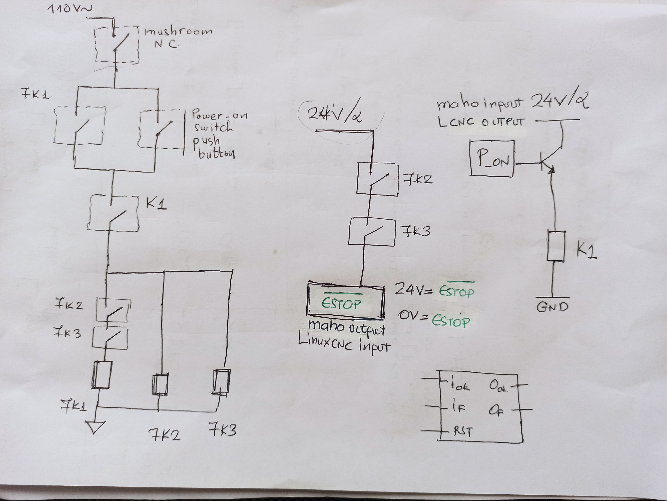

I am trying to understand how my estop configurion will work but I am hurting a bit.
All this is MAHO side: to power on the machine (left side of the picture),
  1. the mushroom must be not pushed,
  2. K1 relay must be energized and
  3. we need to press the power on push button (this is a momentary button).
When power arrives at 7K2 and 7K3 they get energized and subsequently 7K1 is energized.
Then, a contact of 7K1 is in parallel with the power-on push button and thus the power-on circuit retains power.
Additionally, when 7K2 and 7K3 are energized a net with name /ESTOP (NOT_ESTOP) gets 24V and this is indication of normal operation on maho side. If this signal goes to 0V, it means we are in ESTOP.
This /ESTOP signal is a MAHO output (input for my MESA).
The K1 relay is controlled by a mesa output (MAHO input). We need to energize K1 in order to power on the machine and to cut off power to K1 when in ESTOP.
I am trying to think how to wire this to the estop-latch component but I can't.
I am thinking that I don't need to use the user_request_enable for the latch reset, since I do have the push button (so LinuxCNC will work exclusively with only the maho circuitry).
And since the /ESTOP signal (maho output) is indicative of fault, I would wire this to the fault input of my latch (maybe inverted). But how to control the P_ON signal which enables the K1 relay to allow for power on ?
And do I need to use the user_enable_out, is it mandatory? Or phrased better, do I need it in my case?
For sure, emc-enable-in must go to latch.0.output-ok.

30 Jan 2023 17:13 #263252 by tommylight
Replied by tommylight on topic Retrofitting a MAHO MH500W '89-'90 with hand-feed
Do drives have a separate enable for each drive?
If yes,
-leave everything as is
-estop input in Mesa to e-stop-ext in hal
-drive enable to x-enable or machine-is-enabled in hal
-no latch
Some things to keep in mind,
-you do not want the machine to cut power to everything because of a joint error or a tripped limit or home switch
-as long as LinuxCNC has full controll of drive enables, the rest is more or less OK.
-you have a physical e-stop, so no need for a software one, in case of need, finding the e-stop on screen and clicking on it takes much longer than pushing a button by palm/hand/foot.

30 Jan 2023 18:05 - 30 Jan 2023 19:11 #263259 by petmakris
The driver/amplifier's motor enable is controlled by this /ESTOP line (the one that goes 24V once the machine is powered on via 7K2 and 7K3). So I don't controll the enable of the amplifier from mesa.
If you check the screenshot, on the left, only the 3x (+/-) 10V analog controls for the motors I have access to. No drive enable is accessible to control from mesa.
If  /ESTOP goes low, the amplifier is deactivated. Another way to deactivate axis, is by 8K1, 9K1, 10K1 for the handwheels, something that I will not bother with for now.
Last edit: 30 Jan 2023 19:11 by petmakris.
30 Jan 2023 18:46 - 30 Jan 2023 18:49 #263262 by petmakris
There are two signals in maho
  1. /ESTOP: this is the external estop (LinuxCNC input)
  2. P_ON: the control of relay K1 (LinuxCNC output)
If I wire the /ESTOP to external estop in mesa, what should I do the second signal?
When should I drive it low (and how)?
The complexity in my mind is that when /ESTOP is low (e.g. before trying to power up the machine) then the second signal should be high so the machine can power up so they don't share the same state.
Last edit: 30 Jan 2023 18:49 by petmakris.

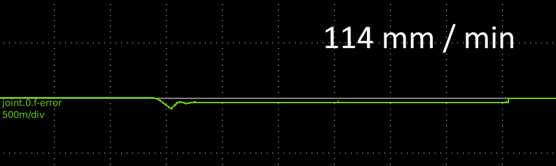

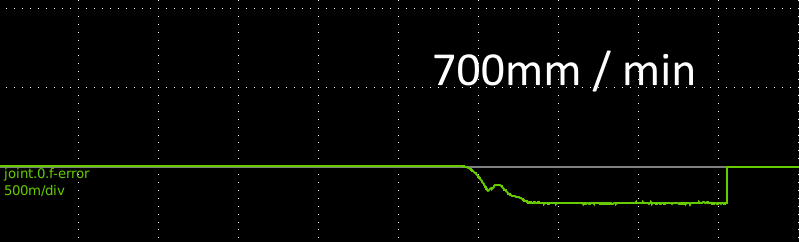

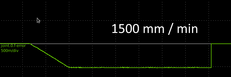

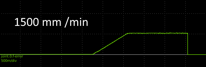

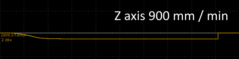

21 May 2023 12:58 #271814 by petmakris

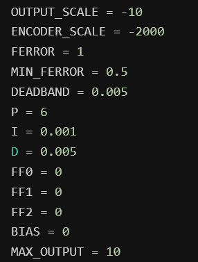

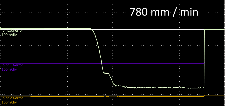

Unfortunately, I am having problems tuning my PIDs.
When the machine is moving with constant velocity shouldn't the f-error be close to zero? like in a resting/idle state? In my case the following error is proportional to moving velocity.
I cannot utilize the I and D terms. I=0, D=0 seems a good value for both and adding any amount bigger than 0.001 to either I or D results in oscillations (different than the oscillations of high P)
I cannot add either FF1, FF2, FF3, it causes oscillations too. Additionally I don't see why I should add FF0 and FF1, FF2 aren't they related only to the commanded position?
In the pictures, the f-error converges to a non-zero values which is proportional to the moving velocity.
The only settings that work a bit well but (not quite) are:
The complete configuration is at
X Axis (all axis have similar configs)
github.com/petmakris/maho-mh500w/blob/ma...onfig/inc/axis-x.inc
Complete configuration:
github.com/petmakris/maho-mh500w/tree/main/config
