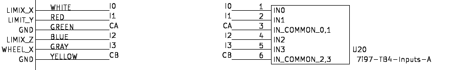

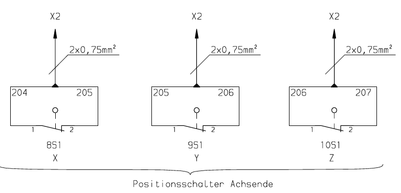

Hi Petmakris!
I'm starting a linuxCNC conversion on a MH500W2 with a faulty Philips 432/9. Planning to use all your hard work in order to get it up and running again. I'll be using a Rpi5 and a 7I97T and three EXEs.
My first step has been to wire the mill to the 7I97T, but i have a question about the "Limit"s. In the MAHO documentation the limit switches seems to be connected in series 204-207,
did you rewire these or simply used 205,206,207 as limit X,Y,Z?
Regards,
Hampus
Regards,
Hampus
