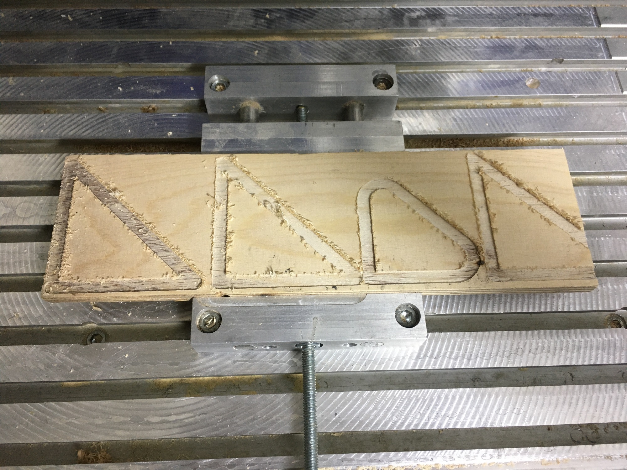

17 Feb 2023 19:28 #264716
by frankomatic

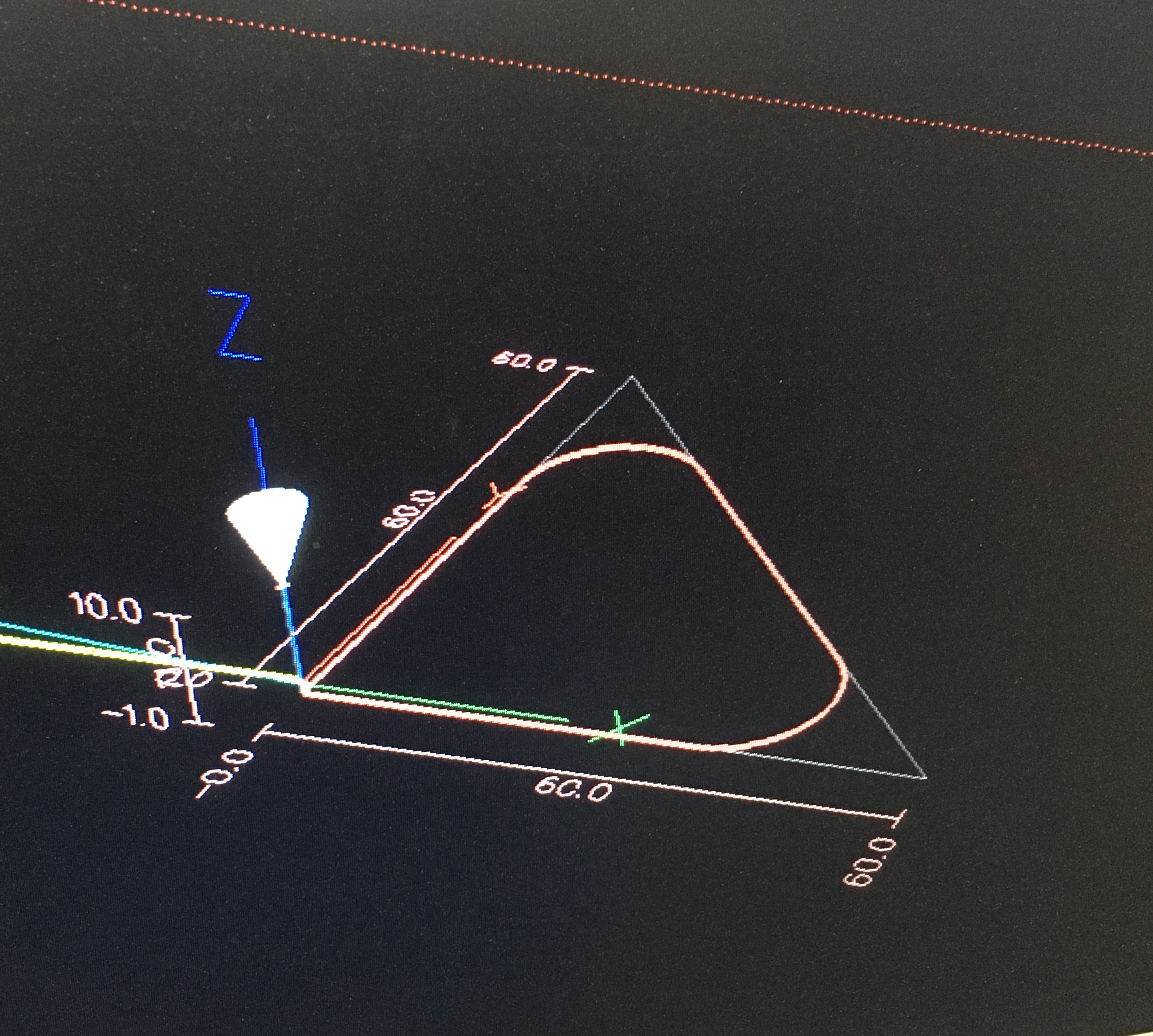

From left to right: 25mm/s, 50mm/s, something went wrong, 50mm/s again.
Acceleration was 750mm/s/s
Something went wrong when I tried to max the speed for this timing and I must have clicked something, because the trace on the screed looks like what it cut:
Is there some sort of cutter compensation or something?
Dimensionally the successful three are identical.

Last pictures, looking good, the rounded one is due to G64 being omitted probably as a result of run/stop/run from line.
Acceleration of 750mm/s2 is to much for your machine, use 150 to 250 max.
Also, as PCW mentioned, do not change stuff at random, that never works.
