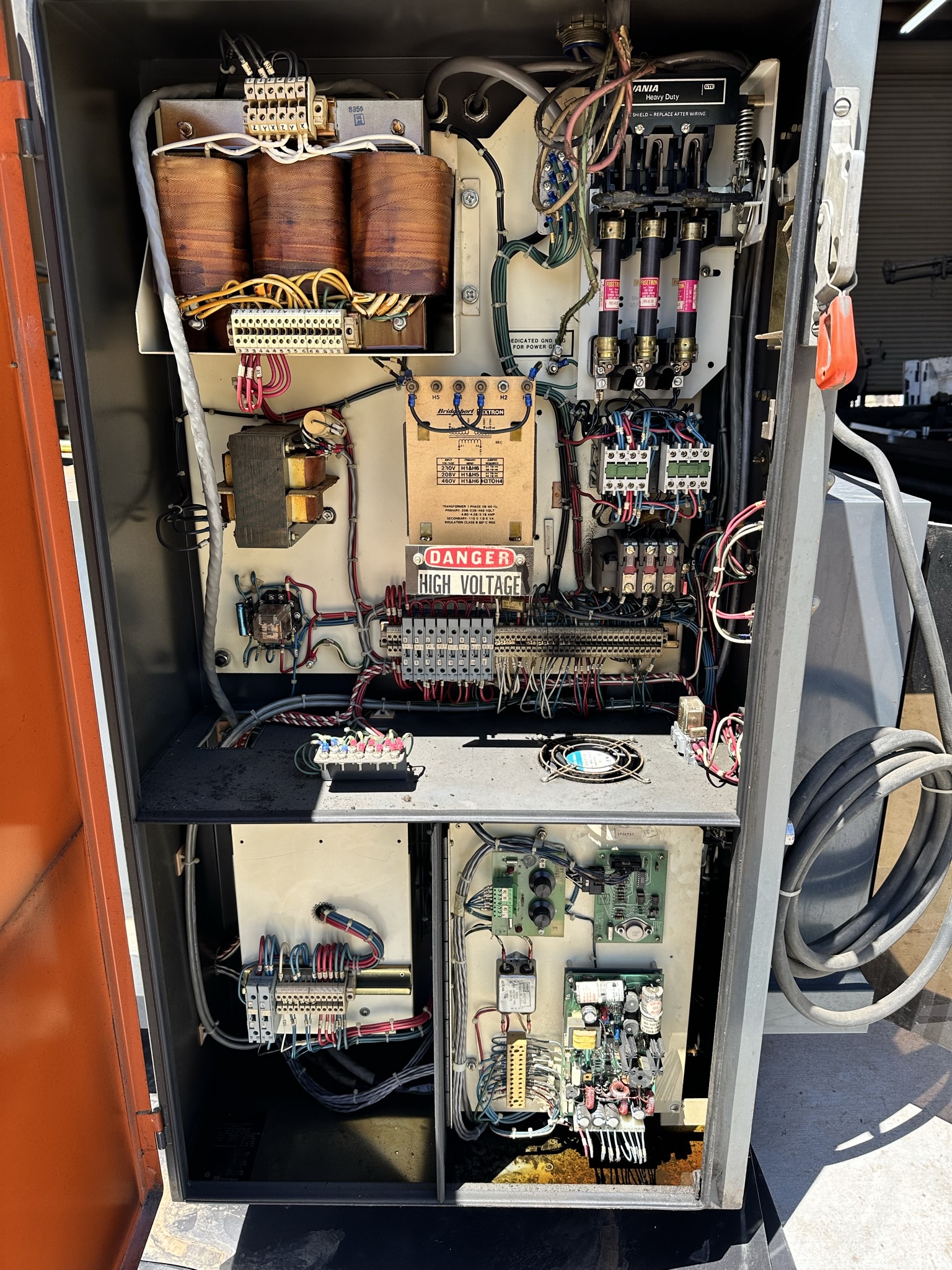

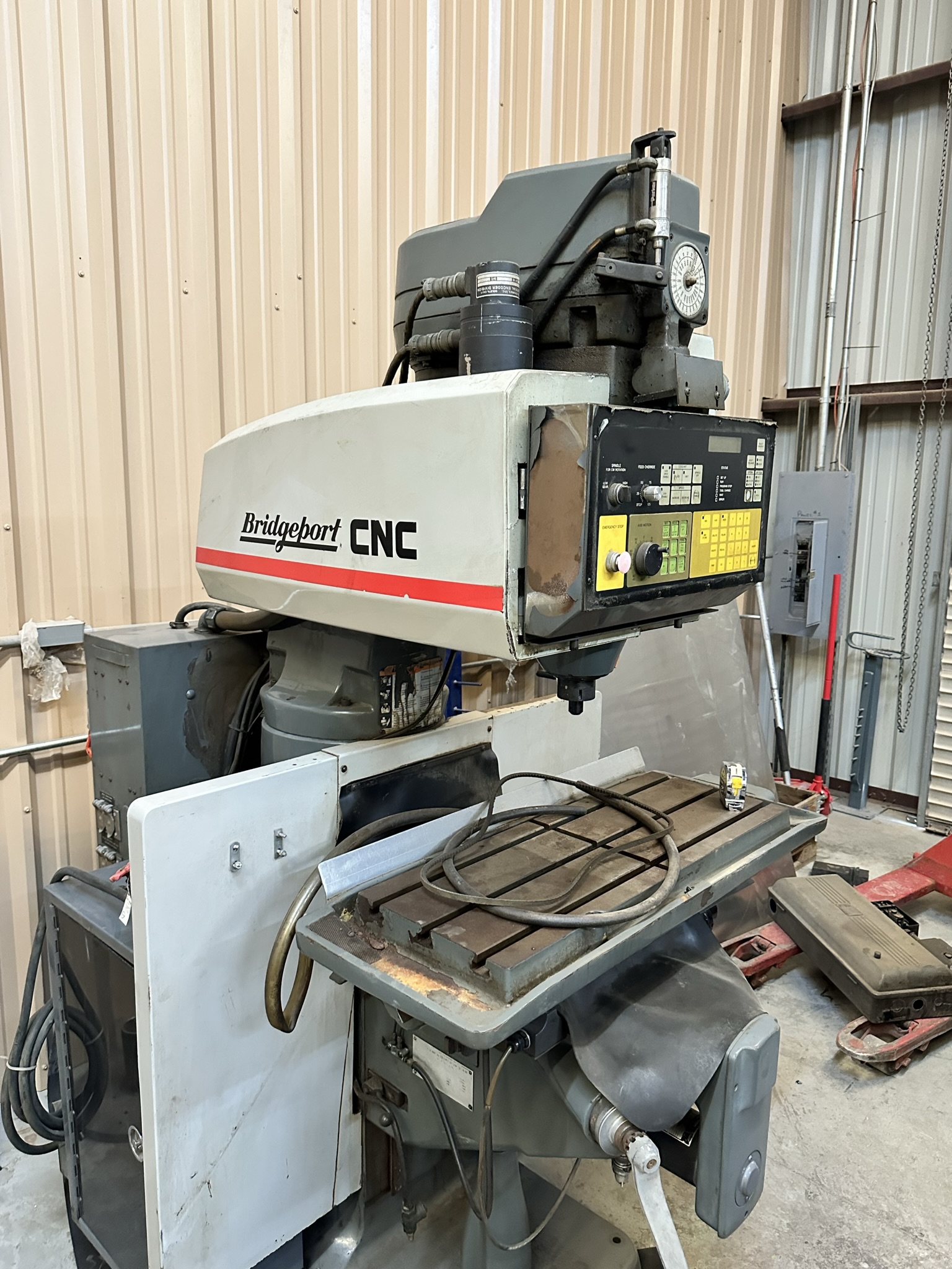

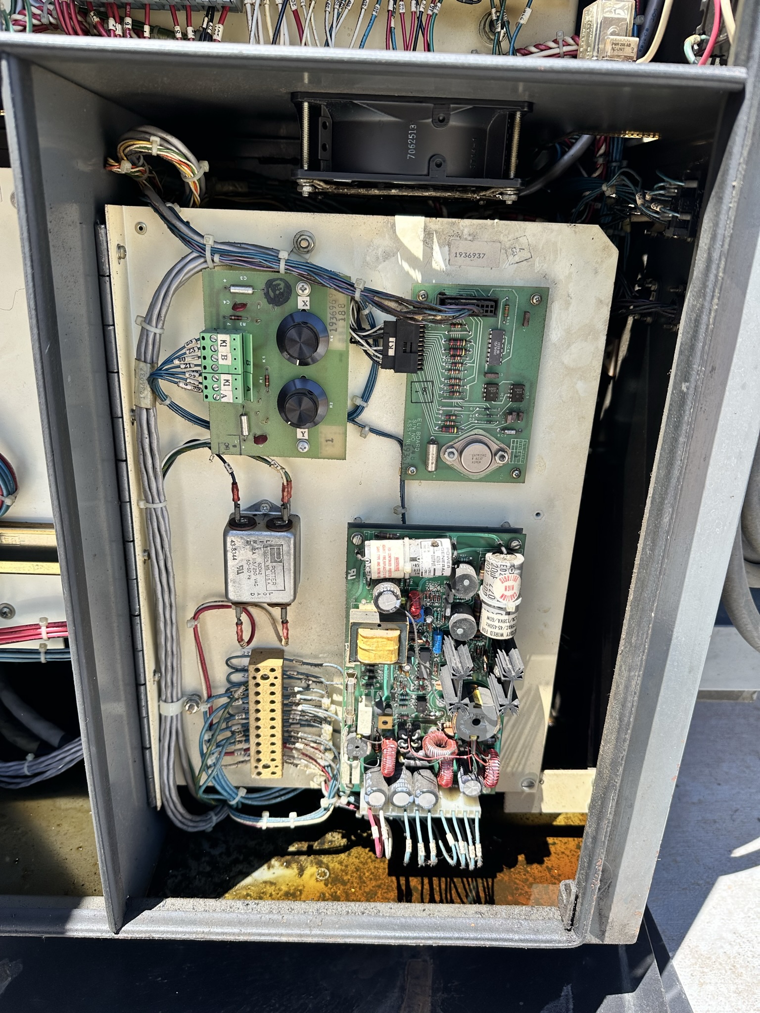

i would like some help in converting this to linuxcnc
what would i need, to be able to convert it ? can i use old electroics and put in a new board for linuxcnc which one is recommened and thats in stock

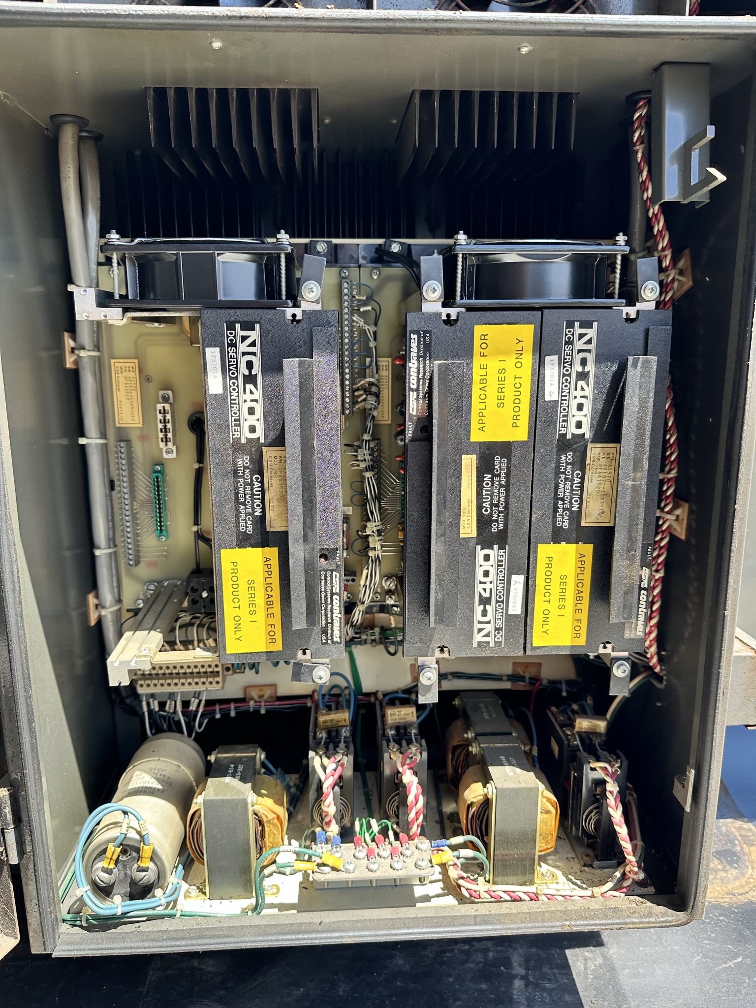

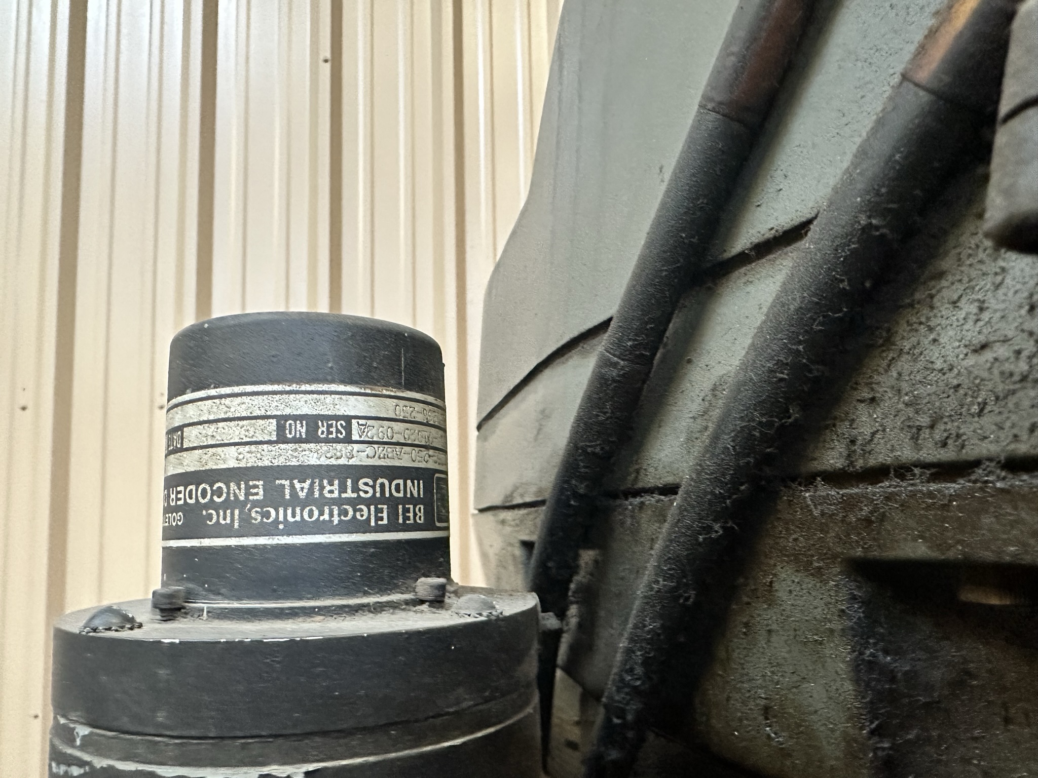

It looks like DC servos, probably +/-10V control.
Do you have a PC with PCI or PCIe ? Or would you prefer to connect via Ethernet?
The 7i97 would be a good choice, except that they are out of stock.
So perhaps
store.mesanet.com/index.php?route=produc...83_85&product_id=379
and
store.mesanet.com/index.php?route=produc...id=120&search=analog
There are also options using the parallel port (as a communications bus, not bit-bashing)

does the machine currently operate ???
it matters for figuring things out. a friend of mine has the same machine, but he had anilam controls, we're replacing the servos etc, his motors are really worn.

yes it ran before i picked it up mine has the contraves dc servos
i would eventually want to upgrade the nc400 drives to something more modern as well but for right now just want to get it running on linuxcnc

kb electronics has some affordable dc drives, as does pico systems. if you watch out, you can occasionally pickup glentek drives in ebay for a song, the pwm brush dc drives are superb
