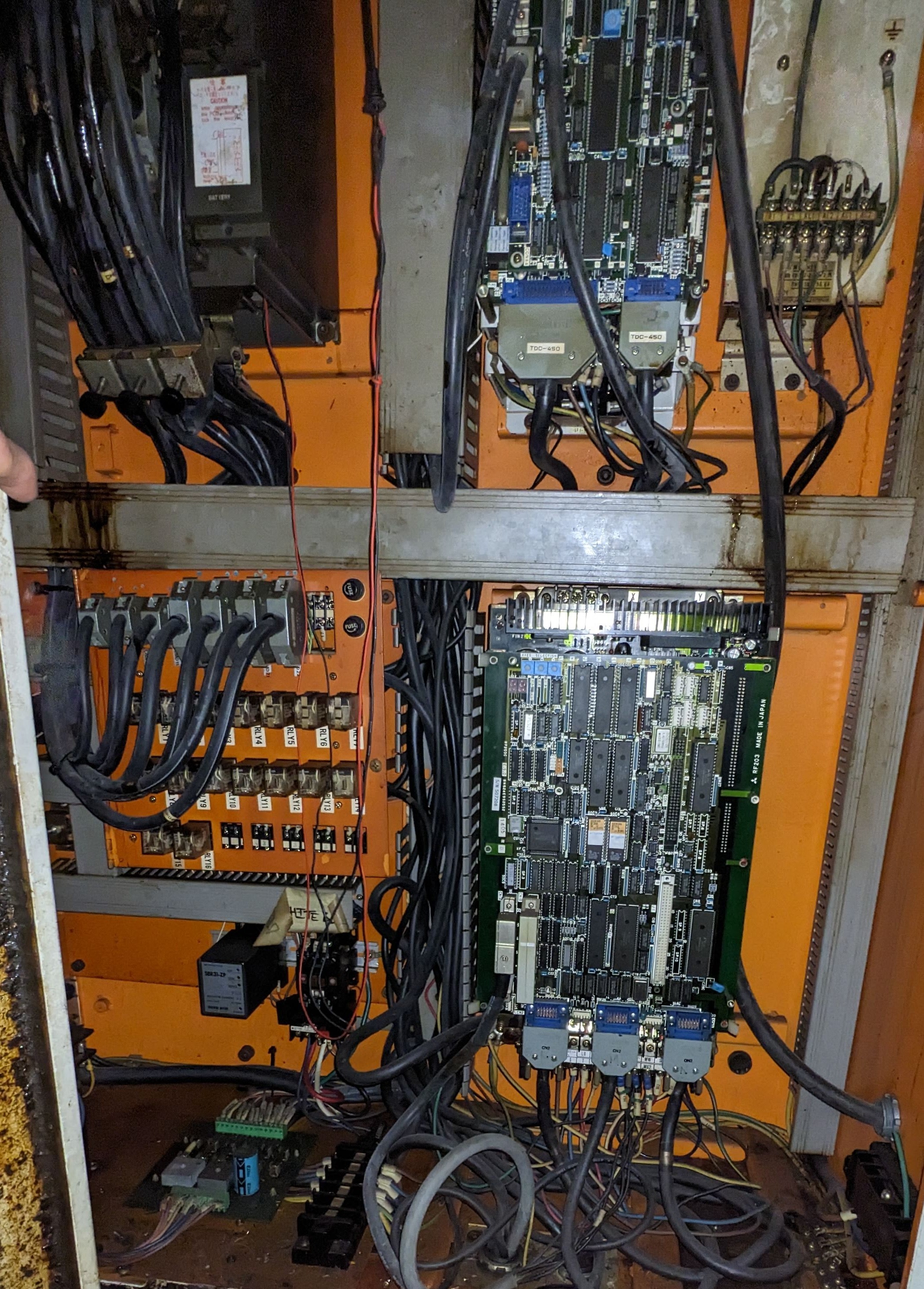

I have the opportunity to purchase a 91 leadwell TDC-450. The cost would be about $2200 including delivery. It seems like the most recent place used it for random R & D jigs incidental to their business, was working when stored, but not under power now. Manuals included, tooling included (making the cost maybe more palatable if I failed, loss wise, not sure), etc. The batteries apparently die frequently on these, but initialization settings are available in the manual. They used a g-code feeder over parallel. I might try to see if I can get it started as is to see what is actually OK or not, but unsure.
Rough images here, the last image is an example from the web, not the specific machine: imgur.com/a/IJyWXYY
It seems like linuxcnc + Mesa are pretty much my only clear path forward, but I am curious about considerations/cost/difficulty, and if I could get any clarity on how hard it would be to get certain bare minimums working.
-It has an rf203C servo amplifier board, which I assume will be useless and I'm looking at ~$1200 for 3 reasonable servos + drivers that will not be a total pain to tune for linuxcnc (correct?)

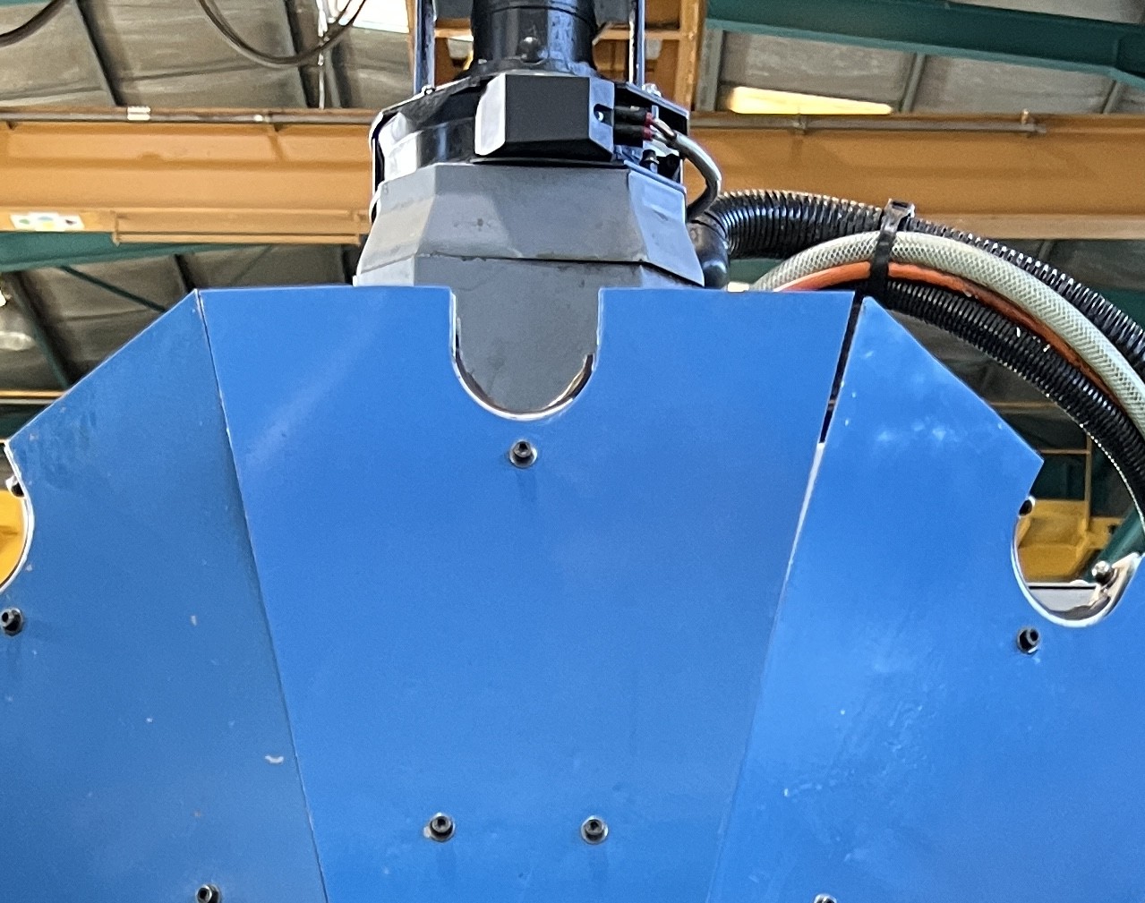

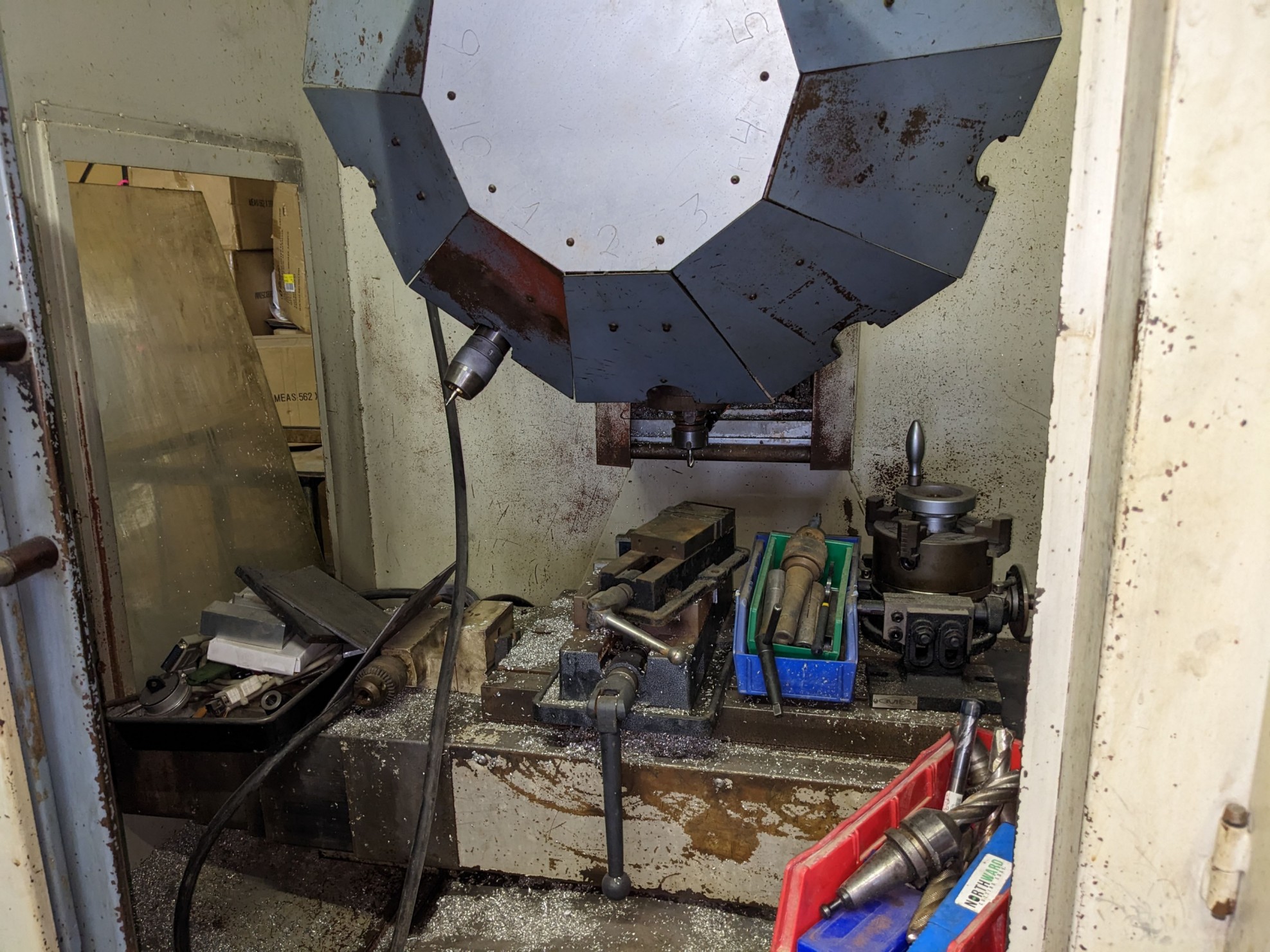

-It seems to have an ATC that is rotated when the spindle reaches the top of the Z, which meshes with some gears to turn the ATC, then lowers to pick up the tool (cam releases draw bar). How hard would it be to figure out setting this up with linuxcnc, eventually? Could I get going with semi-manual tool changes somehow, while I figure out encoder feedback or something similar?
- On the issue of ATC/Encoder, are these spindle motors (3-5hp? I think) typically easy to drive with a VFD, plus linuxcnc somehow providing feedback to this type of motor to advance to the right ATC position, if this is all mechanically coupled like I am assuming?
- Sensors and the like, is there a path to getting the baseline movement/functionality, and perhaps ATC with a little bit of time, without a gigantic deck of extras besides X/y/Z/Spindle control, to start?
- I'll have to remove the Z servo and put it on a block to be able to fit under the 81.5" garage door, it seems I have about <79" total in machine height, but rolls on a pallet. Any ideas on how the ballscrew is coupled to the Z servo, because I definitely want to know it won't be a huge hassle to try to remove

You can probably keep the servos and amplifier board. They are probably velocity-mode control using +/-10V control signals, and LinuxCNC can easily control that.-It has an rf203C servo amplifier board, which I assume will be useless and I'm looking at ~$1200 for 3 reasonable servos + drivers that will not be a total pain to tune for linuxcnc (correct?)

this is mitsubishi MR-S3 3-axis servo amp. NC is MELDAS 300 i believe. the
unfortunately no analog control. parallel digital bus which nobody has implemented afaik. the stuff is old, released circa 1986...

aha! So looks like I'll end up with some more non-functional servos for the pile, if I go for it and retrofit.
Thanks for the servo manual, super useful to know the actual amp.
I think this particular one is Meldas 310, yeah, from the manual I saw on site

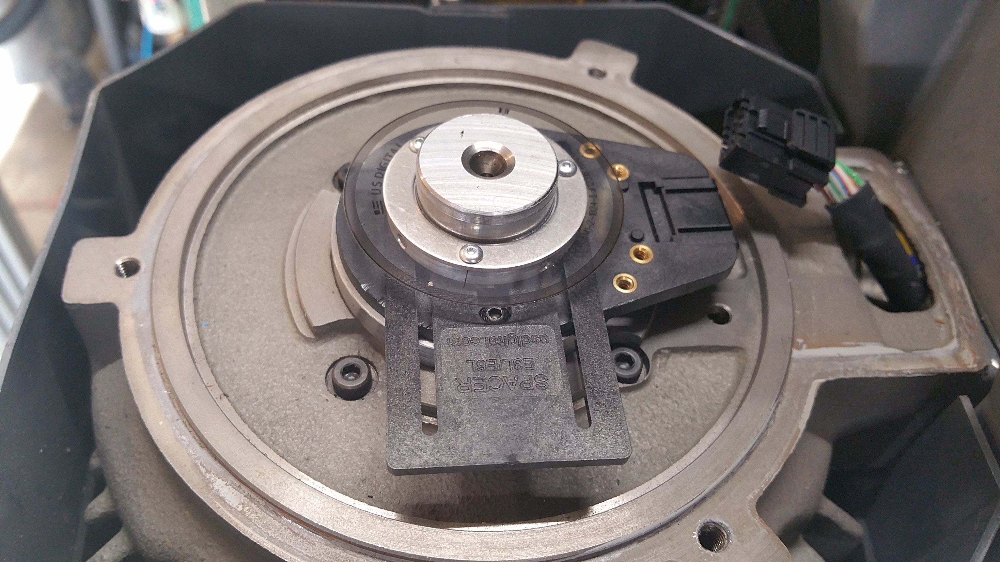

I'm pretty sure I recognize the spindle motor - also a Mitsubishi. Basic, but high-quality, 3-phase induction motor.
If the Meldas spindle drive is also taking a proprietary serial control signal, there's a way around it.
The Mistu (tokugawa) resolver(?) can be replaced with a universal incremental encoder and the whole thing run off a VFD. I went with a US Encoder optical, and they sell discs that match the shaft nicely. You'll have to turn a thin mounting plate for the encoder pickup to sit on (there's a big hole through the motor end cover), but otherwise my Mitsu spindle motor re-purpose was pretty painless.
US Encoder, Automation Direct VFD, Mesa & 0-10v = profit

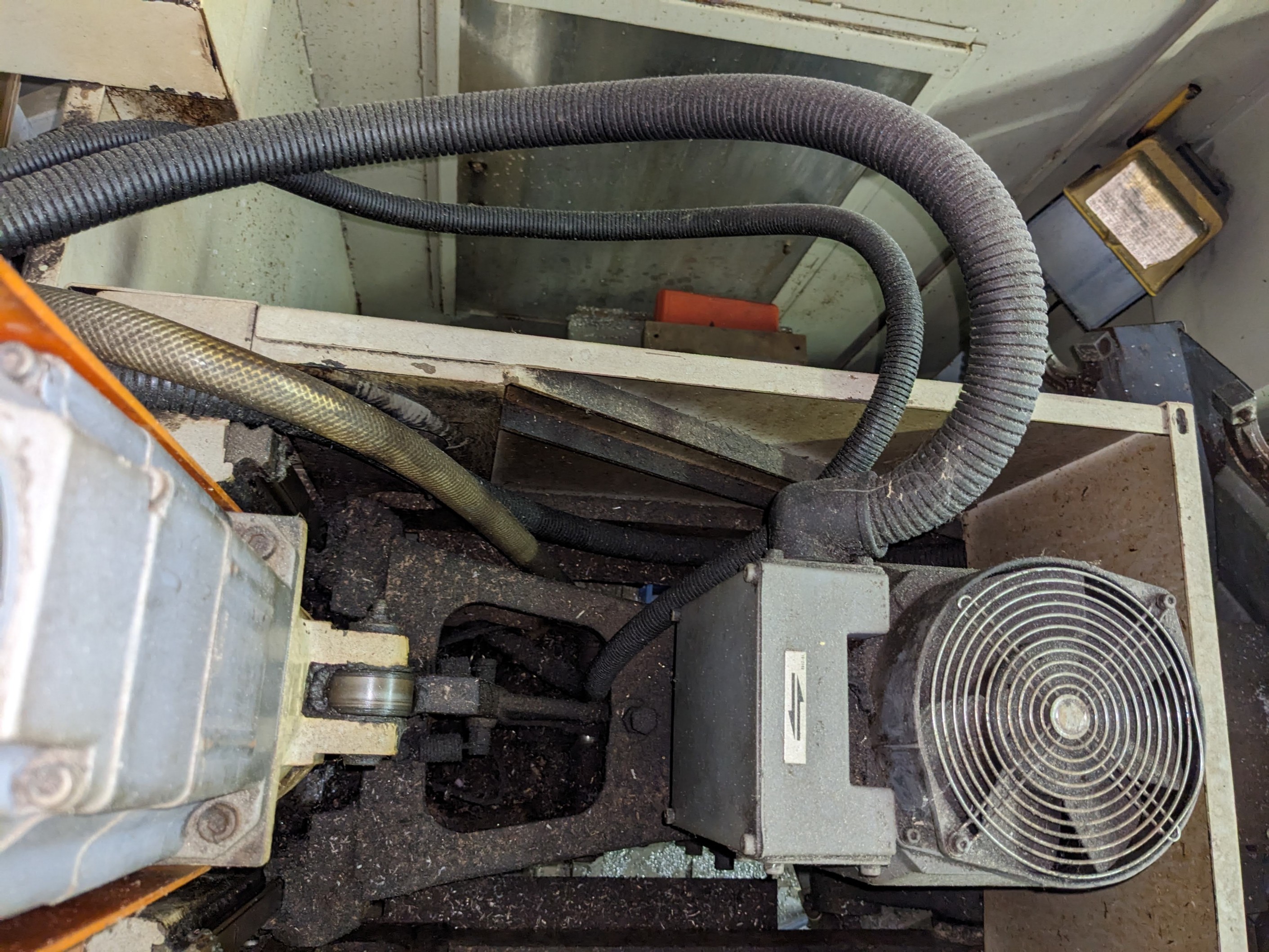

It does look fairly similar, though there isn't a flange/flap at the front, I think from online photos:
I wouldn't have any experience, though
It is cool to know that encoders can be retrofitted if the current encoder is proprietary. I still certainly don't know exactly how the ATC works, but hopefully I can figure it out if I do go for it.
Edit: finally seem to at least have found a few machines with a similar ATC carousel mechanism, this is from a faunc robodrill t14ia:

Yep, that's a Mitsubishi spindle motor. Identical to mine - just bigger.
In my photo - taken during the lobotomy - the fan, fan shroud, and OEM encoder/resolver/thingie covers are off. The "tab" thing to the right of my photo is part of the motor frame casting and acts as a mount for the junction box. The top-down photo you first posted shows the U-shaped junction box mounted to this tab.
The color and fan shroud shape are a dead giveaway.
