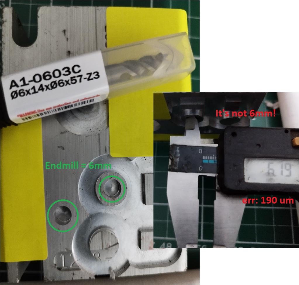

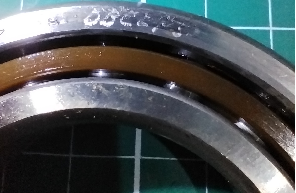

Now I have some questions about the spindle and bearings that I am having issues with. I value the opinions of all my friends regarding this matter.
The machine has a BT30 spindle.For example, when I use a 6mm diameter endmill to drill a hole, I encounter a result of 6.19mm.
Therefore, I have removed the spindle and drawbar because of this issue.
I want to replace the angular bearings of the spindle because when I manually push the spindle, there is a play of approximately 30um to 50um in the spindle shaft.

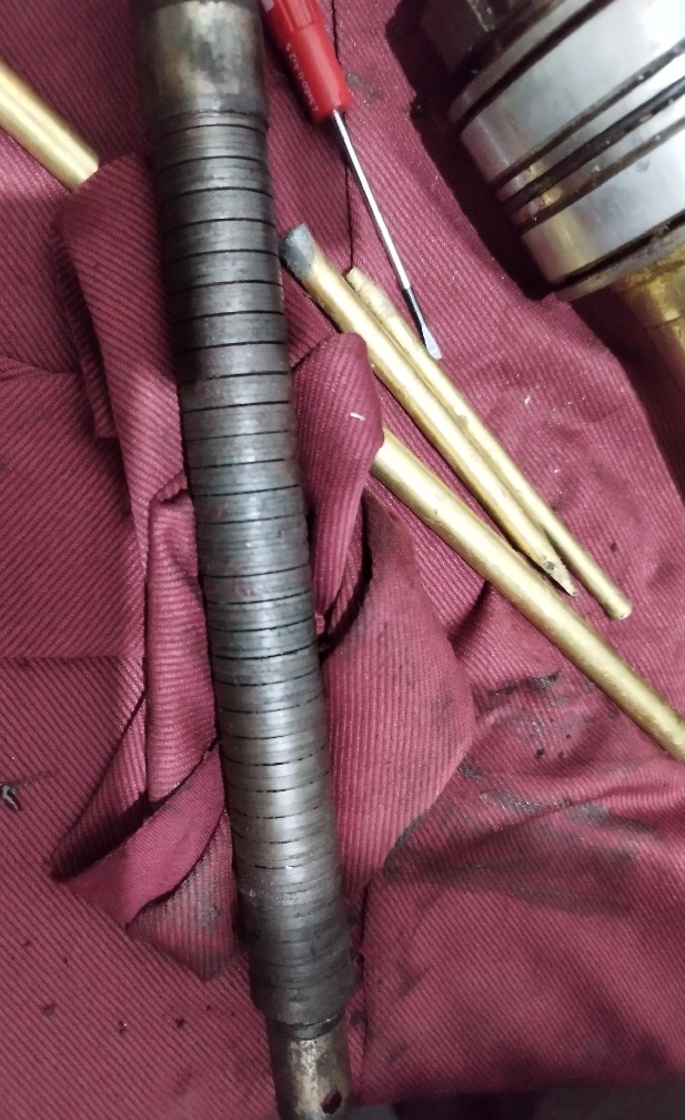

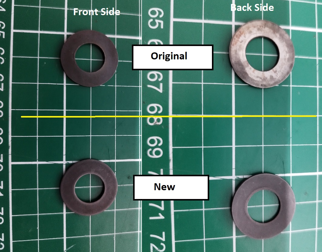

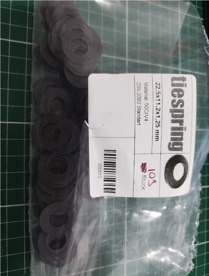

I have noticed that the springs on the drawbar are broken, and I have placed an order to replace them.
The specifications of the Draw Bar are as follows:
Material: DIN 2093 (50CrV4)
Quantity: 130 pieces, consisting of 2 reverse and 2 straight springs.
BT30 spindle

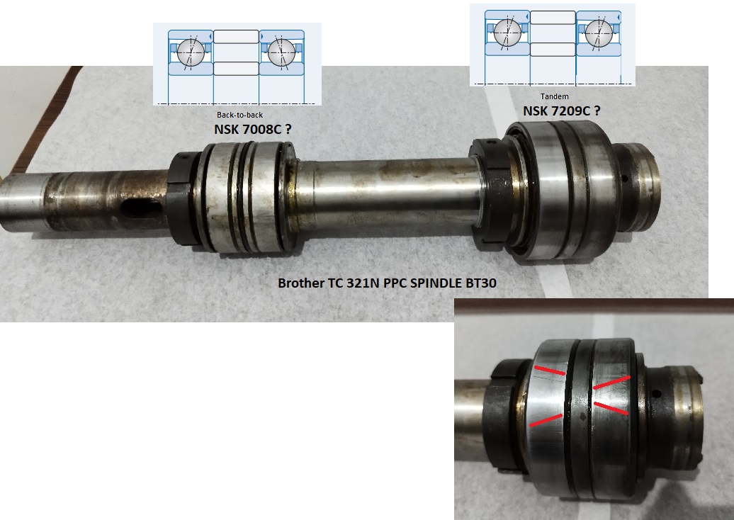

The codes on the bearings are very faint and difficult to understand.
The upper bearing assembly consists of NSK 7008C bearings arranged in a back-to-back configuration.
The lower bearing assembly consists of NSK 7209C bearings arranged in a tandem configuration.
Are they custom-made?
Does anyone have information about the original bearing codes?
Can you assist me with this matter?

22 May 2023 08:49 #271931
Replied by andypugh on topic Retrofitting a Brother TC321N PPC
The hand engraving might indicate that the bearings were supplied as matched pairs. If so then the engraving might be indicating what they are matched for.
www.nsk.com/products/ballbearing/angularcontact/
(Click on "Reference 2")
You might expect to see codes "DB" "DF" or "DT" if that is the case.

I plan to install the bearings as I deduced from the arrangement. The upper bearings will be aligned in a face-to-face (DB) configuration, and the
lower bearings will be aligned in a tandem (DT) configuration.The visual representation of the lower bearings is as follows.
I couldn't see the preload coding on the bearings in this visual.
Can standard NSK bearings available on the market be used?The NSK bearings available from the NSK company are as follows: NSK 7008C DUL P3 and NSK 7209C DUL P3Here, I have a question regarding the preload issue. Should the bearing suffix be DUL or DUM?Which preload should be selected? L: Light M: Medium
Thank you,
Best regards.

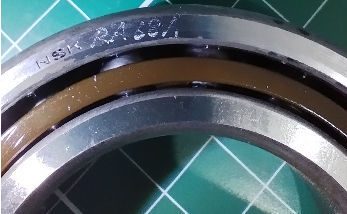

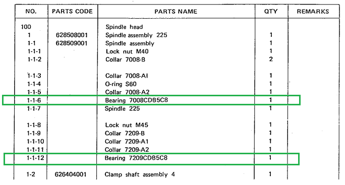

Hello again, friends,
I don't have the parts list for Brother TC-321. Therefore, I don't have the exact bearing codes.
That's great that you found the parts list for Brother TC-225, and it provides the information that the top and bottom bearing codes are in a DB (back-to-back) configuration.
Top Bearing: 7008CDB5C8
Bottom Bearing: 7209CDB5C8
Lastly, I couldn't find the "5C8" code in the catalogs. Does anyone have information about it?
Also, when I disassembled the spindle, it appears that the lower bearings are connected in a DT (tandem) configuration. My question is, can bearings that are originally matched as DB be used as DT?
Is it possible that the spindle in my case has been modified later?
Thank you,
Best regards.

24 May 2023 14:23 #272097
by besriworld
Replied by besriworld on topic Retrofitting a Brother TC321N PPC
Hi, I have some experience with different spindles. The picture (wiring diagram) from the first comment is wrong. The front pair of bearings are fixed and the rear pair of bearings is movable in the spindle body. This is a standard configuration for high speed spindles. Both pairs of bearings are connected in a DB scheme.
Most modern bearings are sold for universal joint. The higher the preload, the more it affects the maximum rpm. Check the two steel spacer bushings. They should be exactly the same thickness.
If you live in Europe check FAG bearings for LOW price
The following user(s) said Thank You: mugurlu

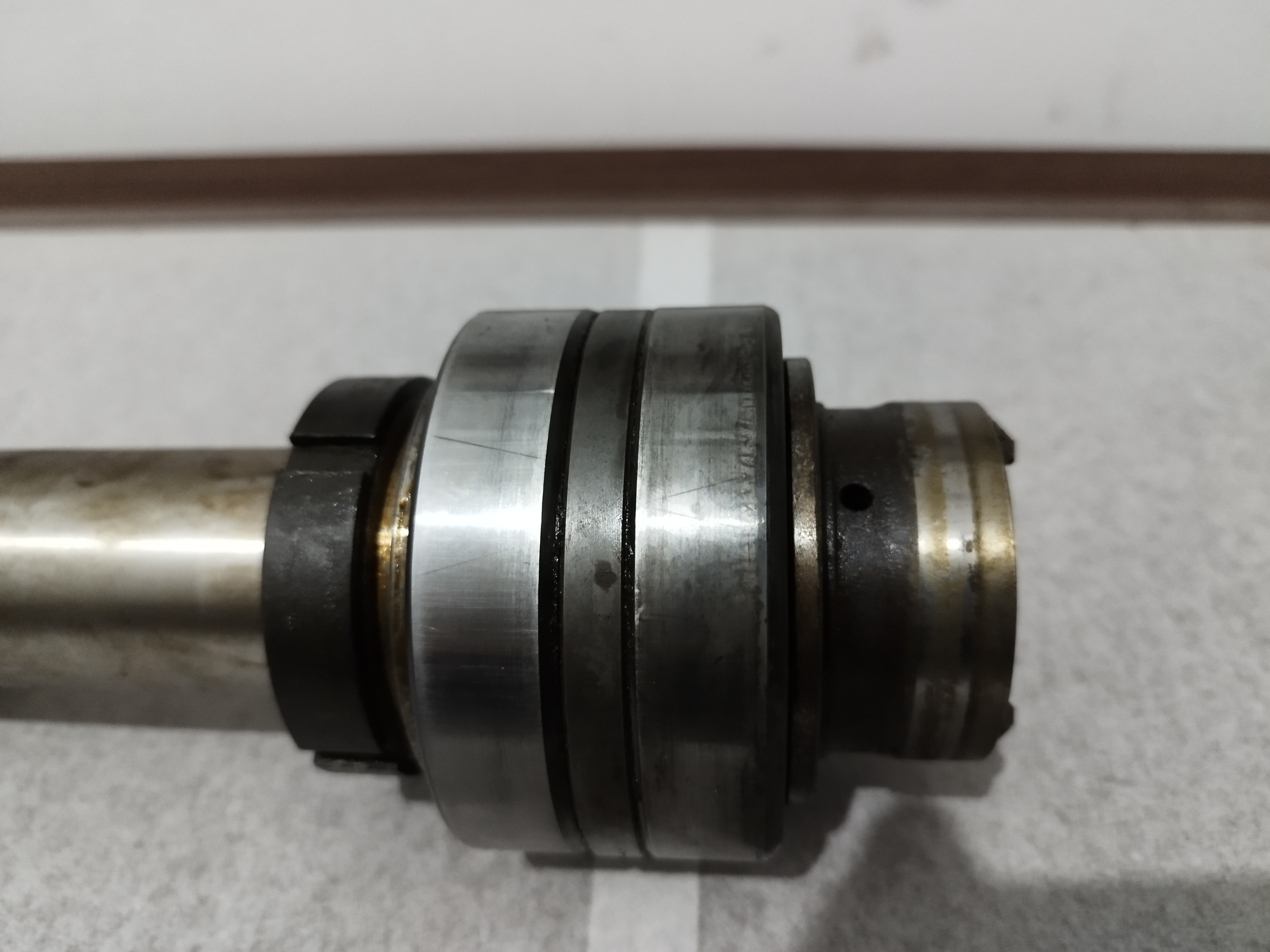

- mugurlu
- Posts: 12
24 May 2023 14:40 #272100
by mugurlu
Replied by mugurlu on topic Retrofitting a Brother TC321N PPC
besriworld, thanks for the information you provided.

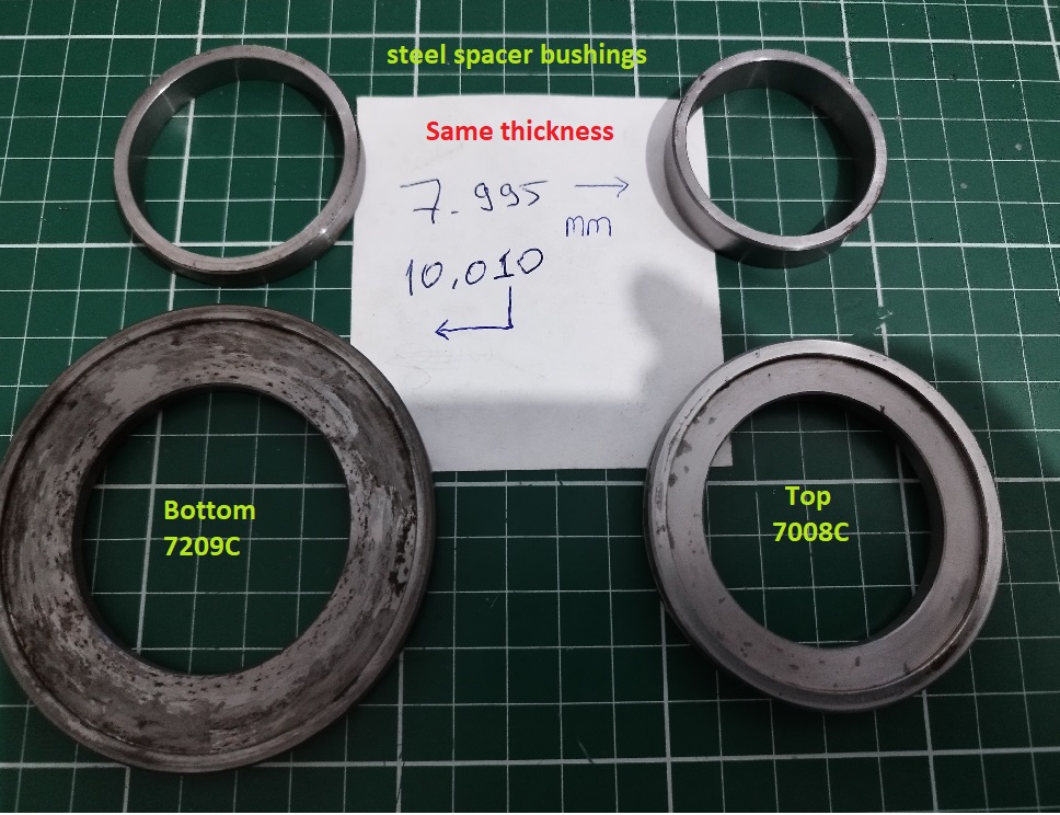

When I removed it from the machine, the rear was assembled in a DB configuration, and the front was as shown in the picture (DT tandem). It is visible on the markings.
Can we definitely say it's incorrect?
By the way, I will check the steel spacer bushings.
Thank you,
Best regards.
Thank you,
Best regards.
- besriworld
- Posts: 327
- Thank you received: 92

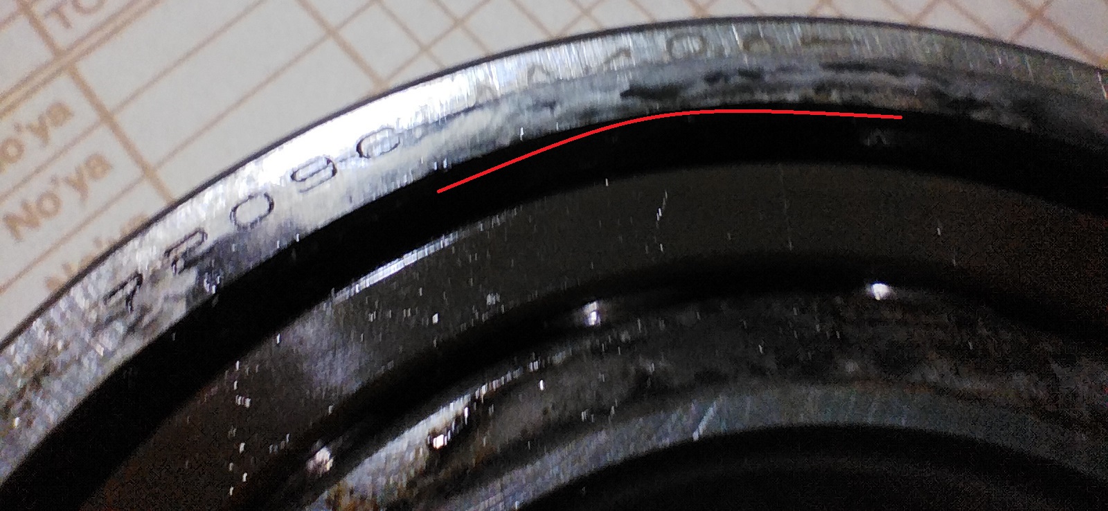

24 May 2023 16:04 - 25 May 2023 00:05 #272116
by besriworld
Yes, I think it's wrong. Thus, the axial load works in one direction.
I think the marking on the bearing shows the installer how to joint the bearing.
The lines must match in sequence! In the case when the bearing is for universal joint the lines must be the same size on both bearings.
ps: You can upload more photos of the project. Always like most pictures. I also work on a milling machine Mori seiki MV-junior . I will make a thread about the machine.

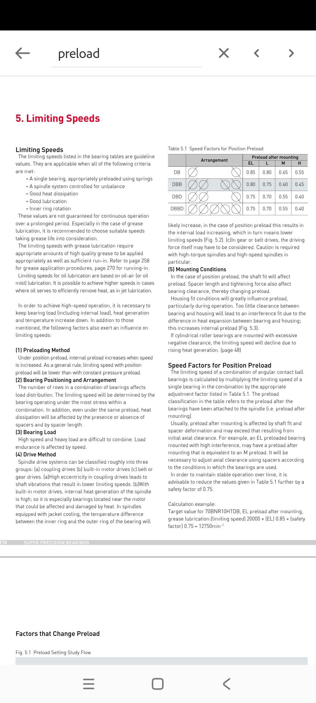

27 May 2023 09:13 #272264
by besriworld
Hi, no problem. Some manufacturers put bearings with a special preload. In your case you have standard bearings.
Preload affects RPM and life .
You can see the documentation. www.nsk-literature.com/en/super-precisio...offline/download.pdf
A few notes: Grease must be weighed. Too much grease can lead to overheating.
