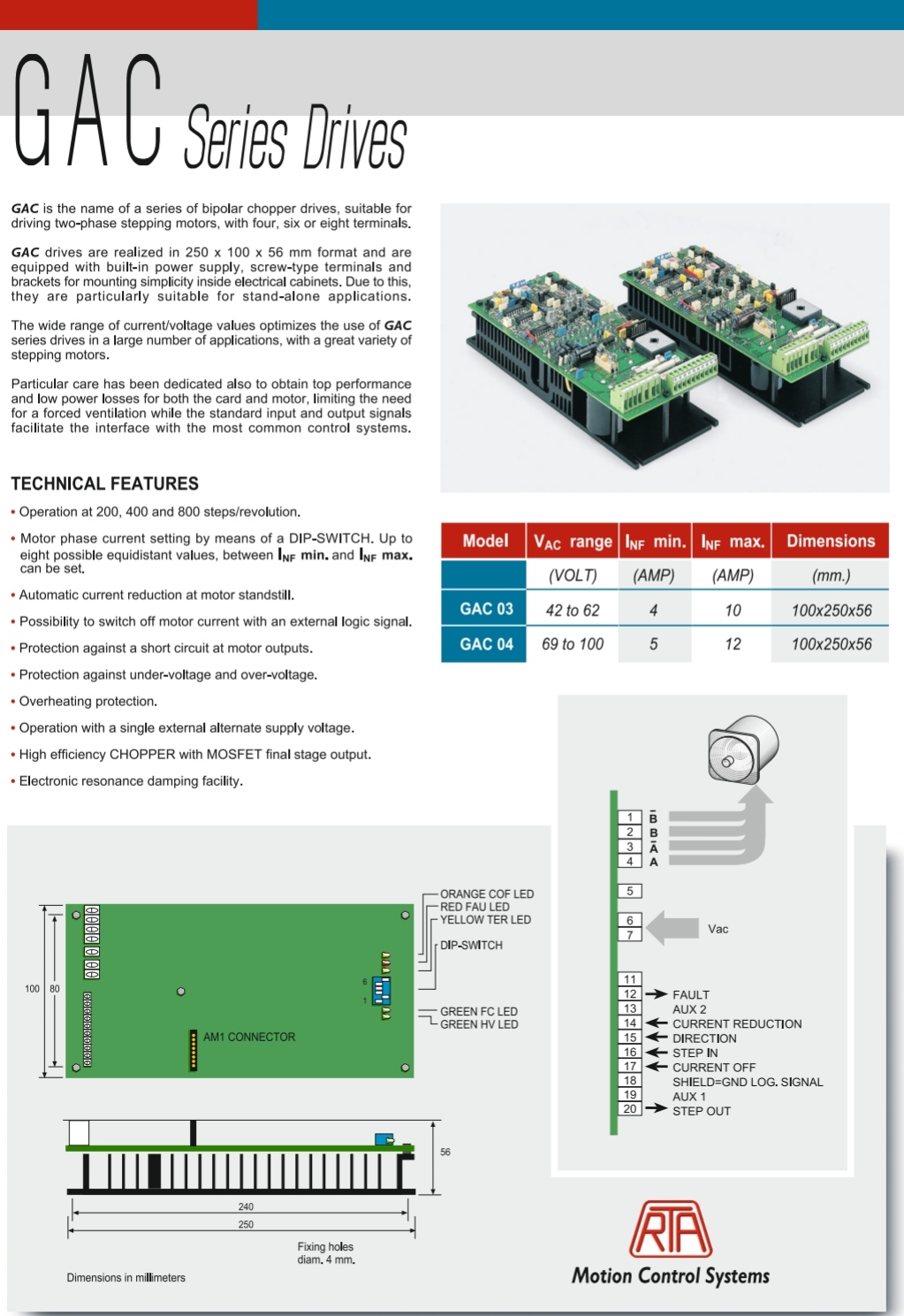

The stepper motor drive is a RTA GAC-03.

Looks like a regular step/direction stepper motor driver. Datasheet is somewhat sparse so you might have to try out if it takes the regular 5V logic signals.
