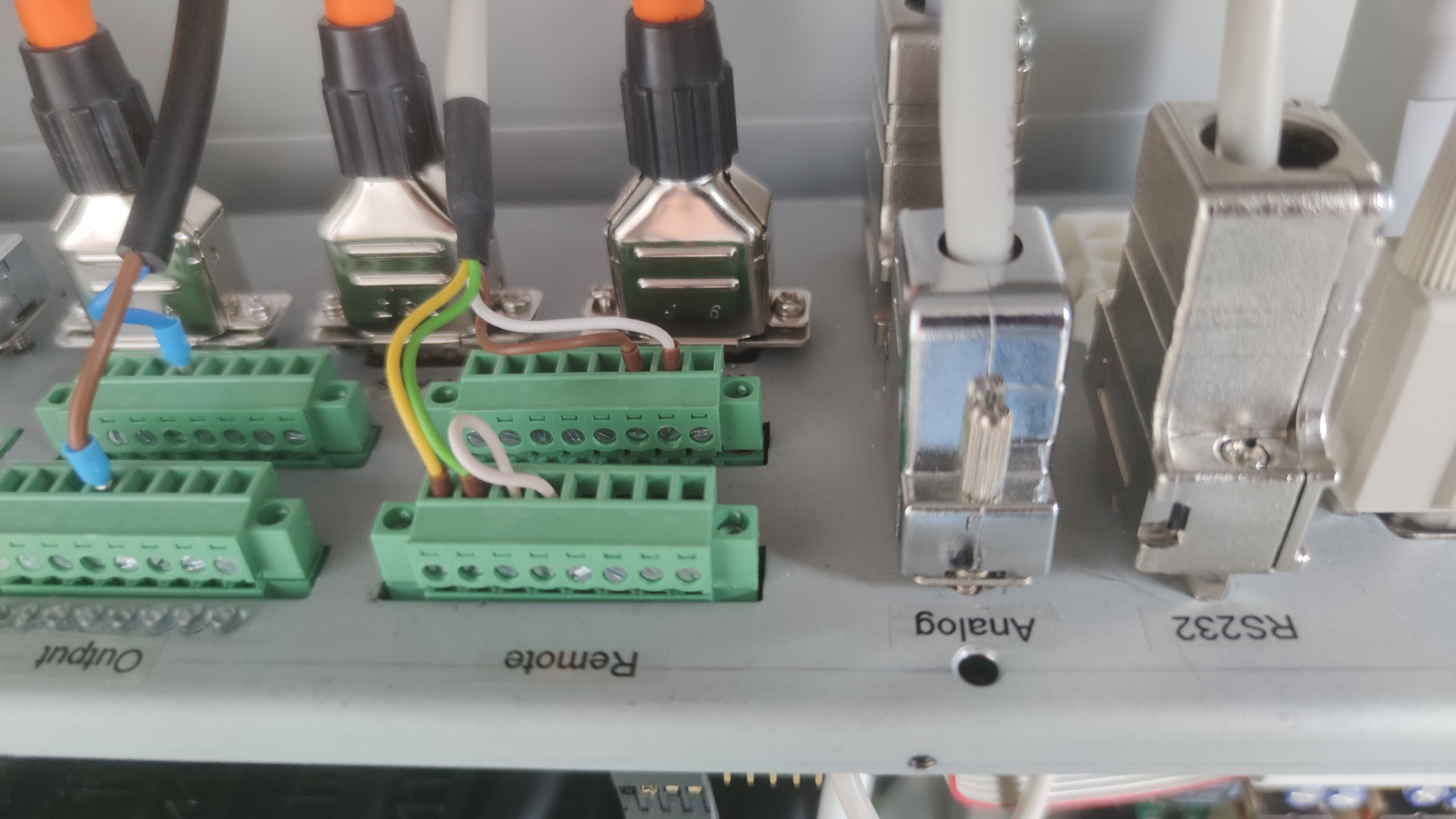

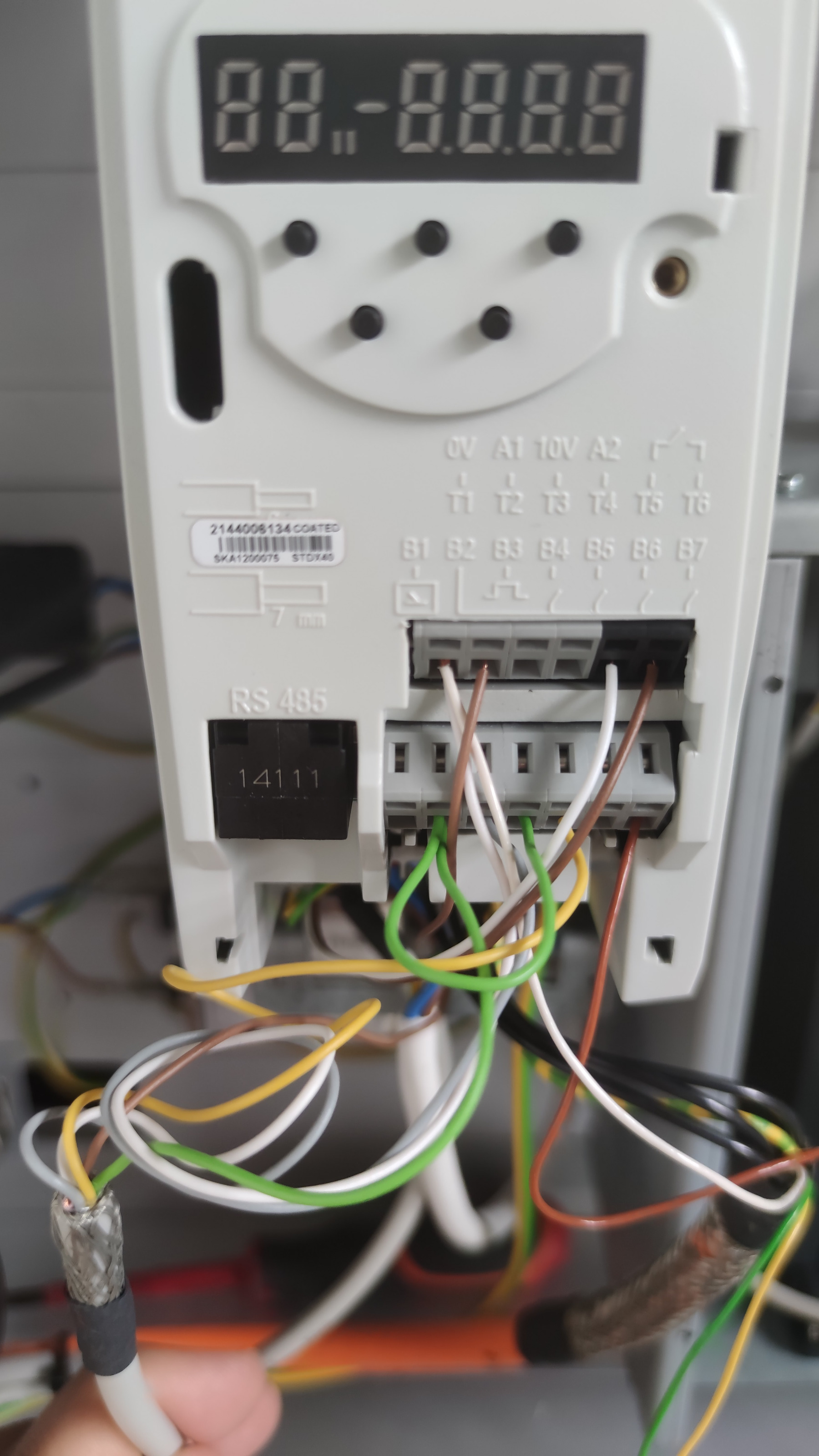

Here are some pictures of the connections.
On the commander they are T1, T2, B2, B3 and B5
On the card it's the Analog connector
So, if I understand right I've chosen the wrong mesa card?
For me, the commander has just the e-pot role that you write (and a coolant control but it's different)
In addition, looking at the cable used, I also think that the electronic system already has a moldbus between the current card and the VFD (Sk commander).

28 Jun 2023 10:29 #274399
Replied by PCW on topic renovation cnc : communication MESA 7i96 - spindle
This would be my guess, assuming B4 is programmed for FWD
and B5 is programmed fro REV:
7I96S TB2.22 --> VFD T1 0V
7I96S TB2.23 --> VFD T2 A1
7I96S TB2.24 --> VFD T3 +10V
7I96S TB3.22 --> VFD B2 +24V
7I96S TB3.21 --> VFD B4 FWD?
7I96S TB3.24 --> VFD B2 +24V
7I96S TB3.23 --> VFD B5 REV?
