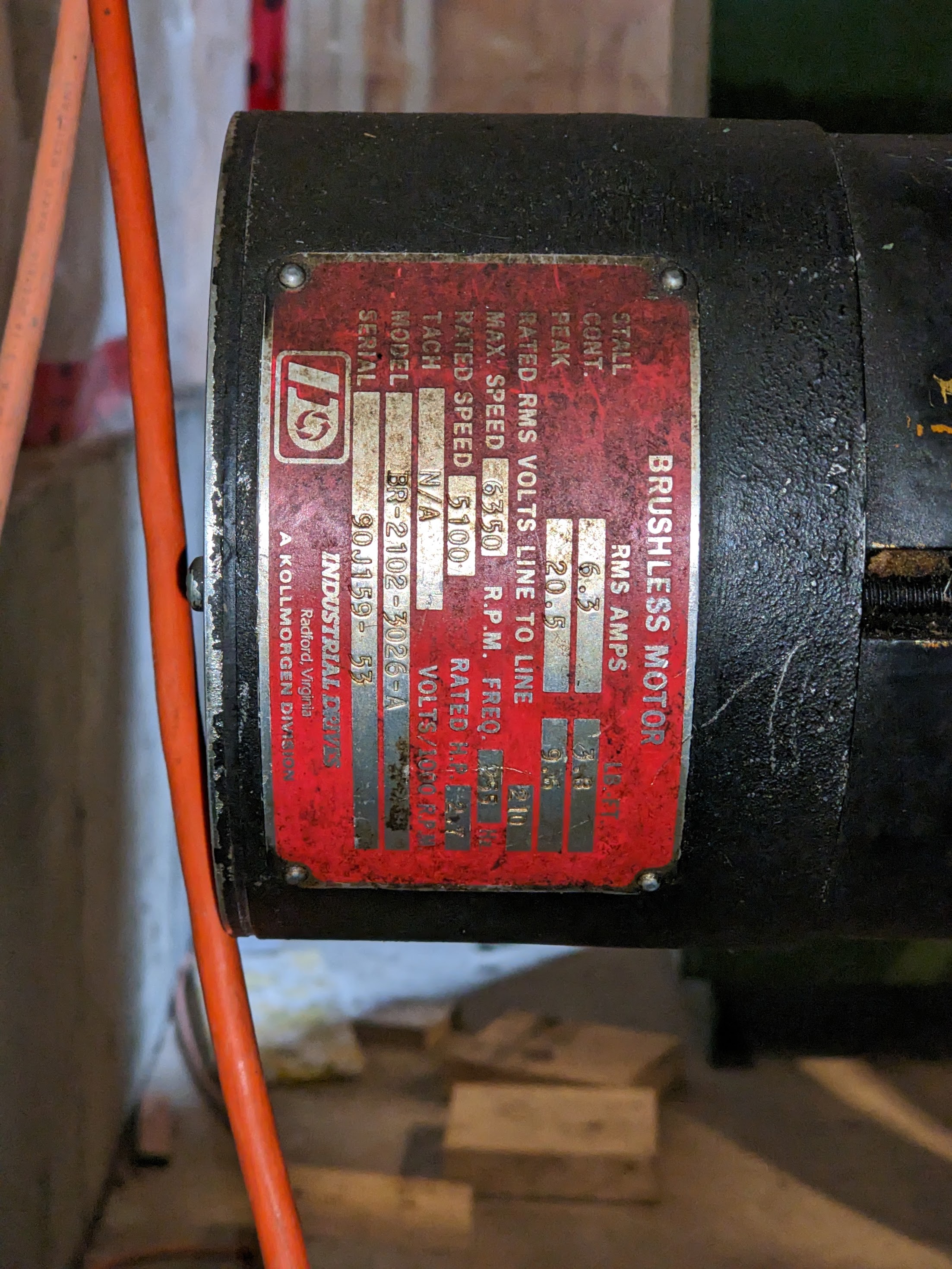

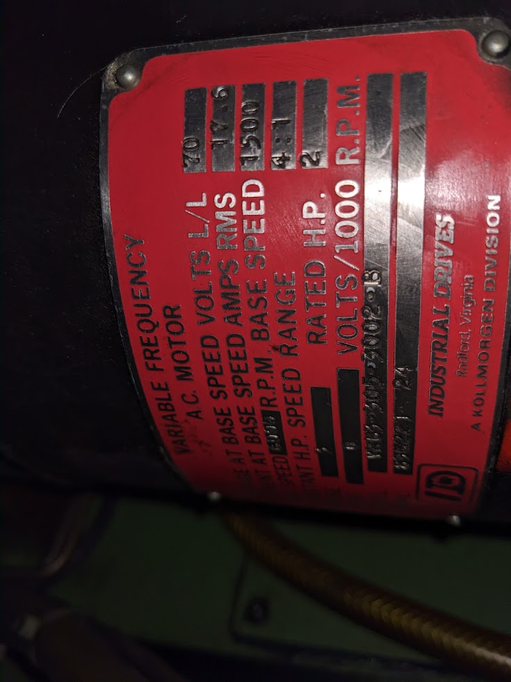

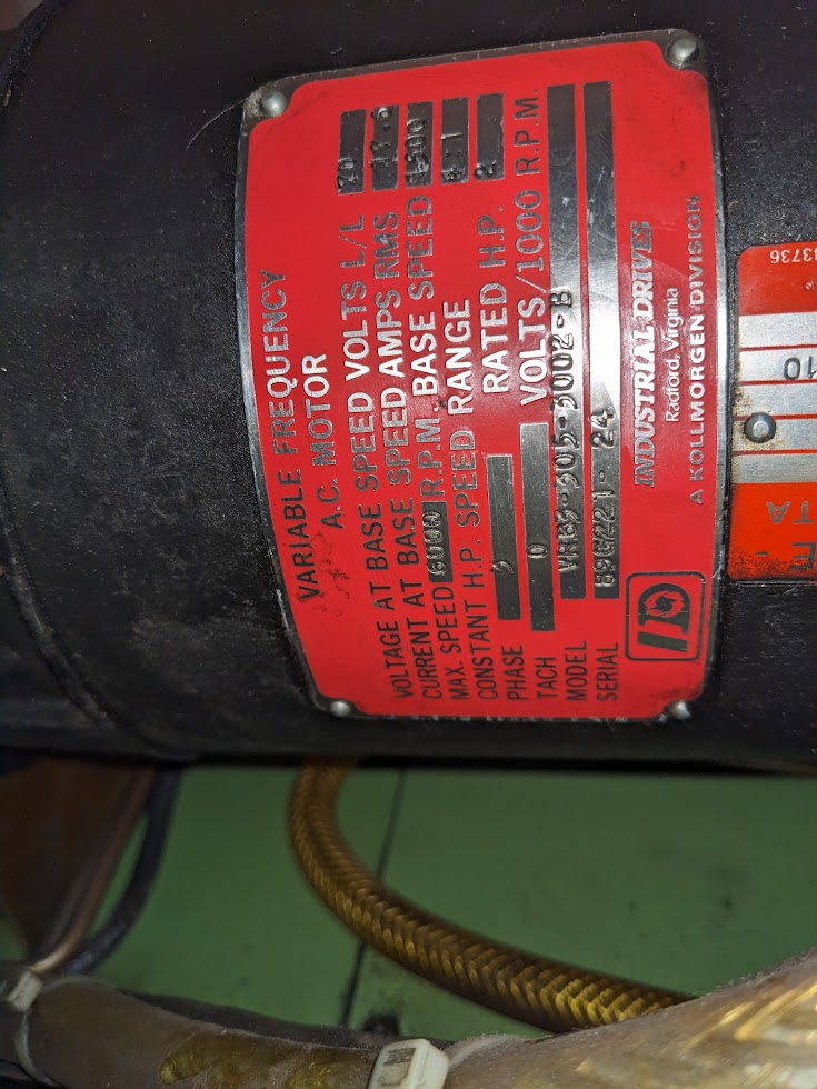

I've attached some shots of the motor plates for reference.
I did some more research after I posted and found that Copley controls also offers some drives for brushless DC motors that use resolver feedback so it looks like my options might be:
AMC DPRANIR-030A800 ~$3300USD
Copley XTL-230-36-R or any Xenus Plus with the -R designator ~$1400USD
Alternately, another thing I just found is that Pico Systems offers a resolver to quadrature converter which, if I understand correctly, should allow me to use a non-resolver drive. If that's the case, used, non-resolver XTL-230-36 units can be had on Ebay for $540USD, as well as I assume other more common drives, which could save me a ton of money on the retrofit. Does that make sense?

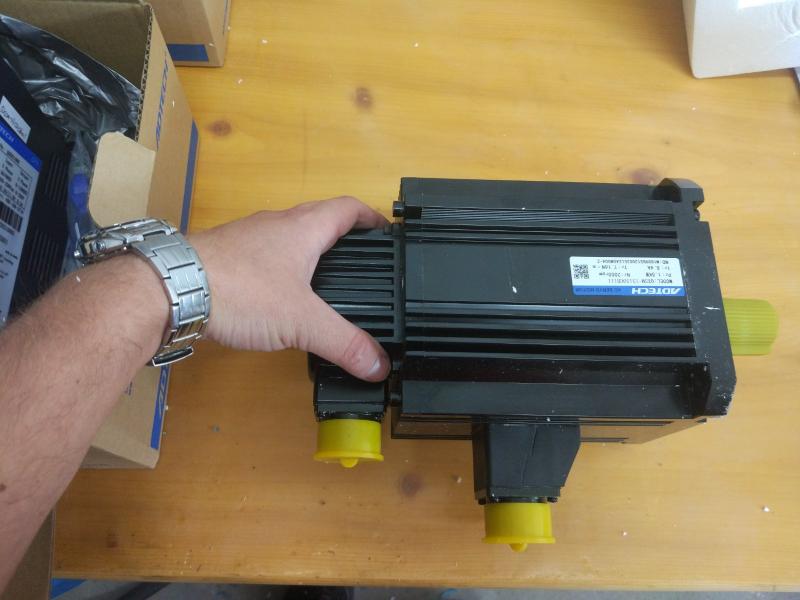

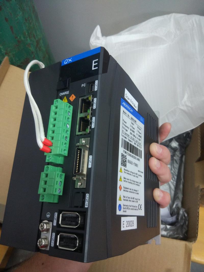

You are aware that for that kind of money you get get complete motor/drives sets, all 3, new, from Yaskawa probably, from Delta or Mitsubishi or Panasonic very probably, from china absolutely, and have some to spare for Mesa and stuff, like Panduit cable channels ?

Wow, lots of info, thanks! I'm just getting started in all of this so I don't know nearly as much as I would like to yet, I appreciate all the feedback!
Pawel77:
My plan is definitely to try the existing drives before anything else, I'm working on getting a rotary phase converter installed so I can power it up and take live measurements where possible, but until that's done I'm trying to absorb as much theory as I can
Although, now that I think of it, I could probably skip the phase converter altogether if I end up replacing the drives, hmm...
The power supply appears to rectify the 208V 3 phase input to a 300VDC output, I might be able to reuse the power supply though that seems like a very high voltage from what I've been reading.
The motors are rated for 210V and the drives appear to be outputting 208V.
The current limit on the drive is 12A per phase.
The reason I was thinking I would need a high peak current is because the motors are rated with a 20.5A peak current, but maybe this is the wrong assumption.
I'll have to learn more about the resolver to quadrature converter, I thought it did produce an absolute output, but I'm probably mistaken.

I had a look at Adtech but couldn't find a vendor, where did you find those? Did you order them direct?I bought 3 servo drivers and motors for $2330 with ethercat.

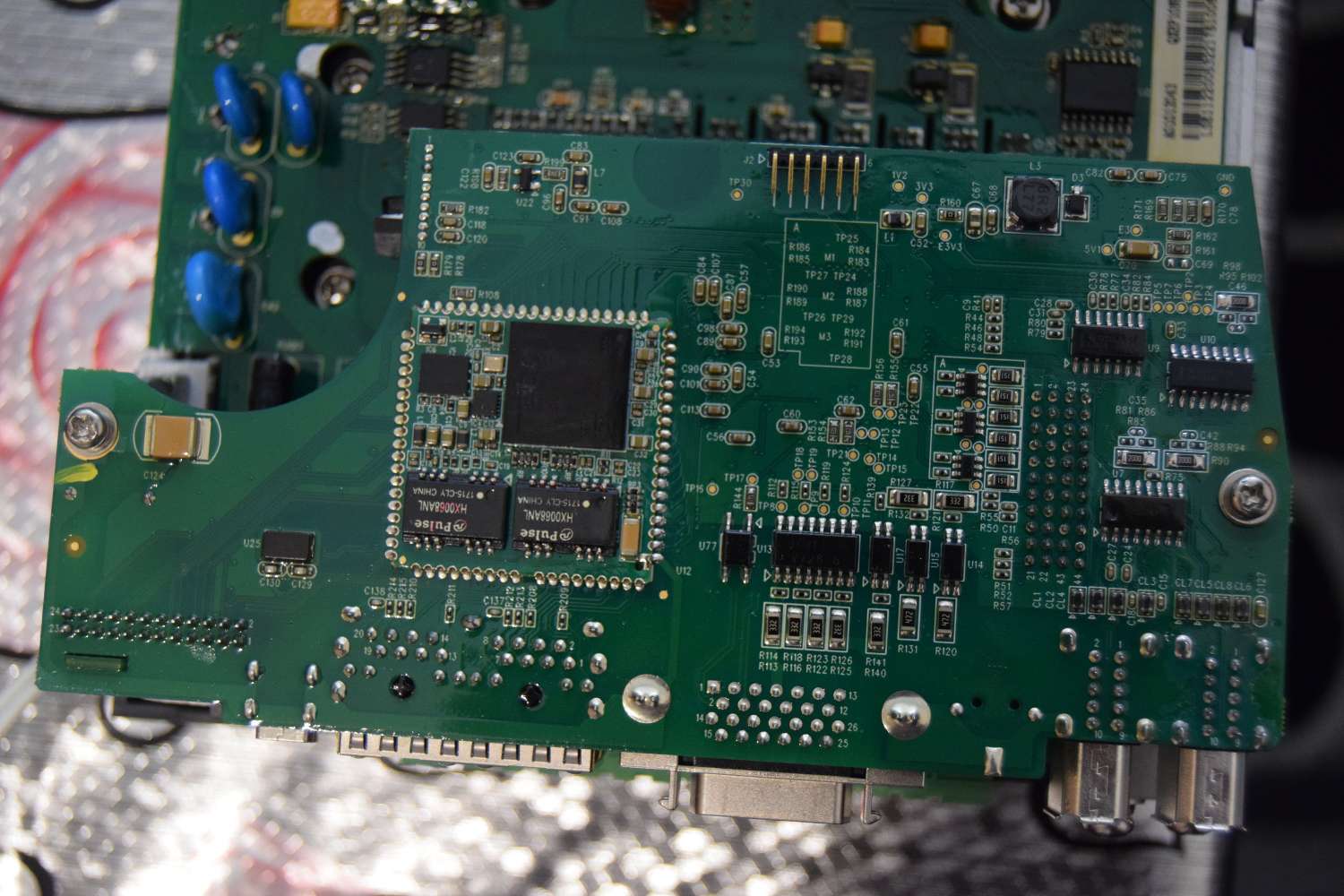

- besriworld
- Posts: 327
- Thank you received: 92
26 Aug 2023 00:52 - 26 Aug 2023 01:01 #278993
by besriworld
Replied by besriworld on topic Deckel FP4A Retrofit
Last edit: 26 Aug 2023 01:01 by besriworld.
